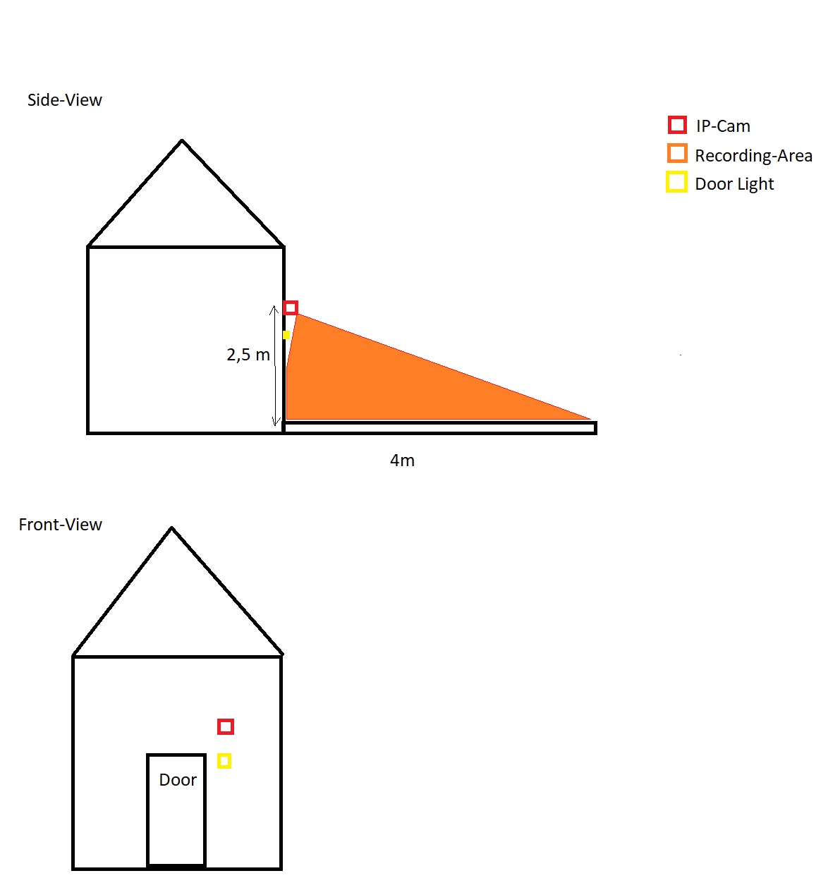

Hello,
I want to install a 180 degree Hikvison camera at my entrance area. I sketched the situation in a picture.
I'm hesitating between the DS-2CD2367G2P-LSU/SL (ColorVu) and the DS-2CD2366G2P-ISU/SL (AcuSense).
I would much prefer the camera with ColorVu. Unfortunately, I don't know if the ColorVu camera is affected much more than the AcuSense version by the light under the camera.
The biggest problem is the issue with the junction box.
I have seen Youtube videos of turret cameras (G2) being mounted on the DS-1280ZJ-DM21.
Does this box also fit the DS-2CD2367G2P-LSU/SL (ColorVu) or DS-2CD2366G2P-ISU/SL?
And from your point of view, is a 180 degree camera suitable for my purpose?
Or do I have to reckon with restrictions if I mount the cameras on the wall and not on the ceiling?

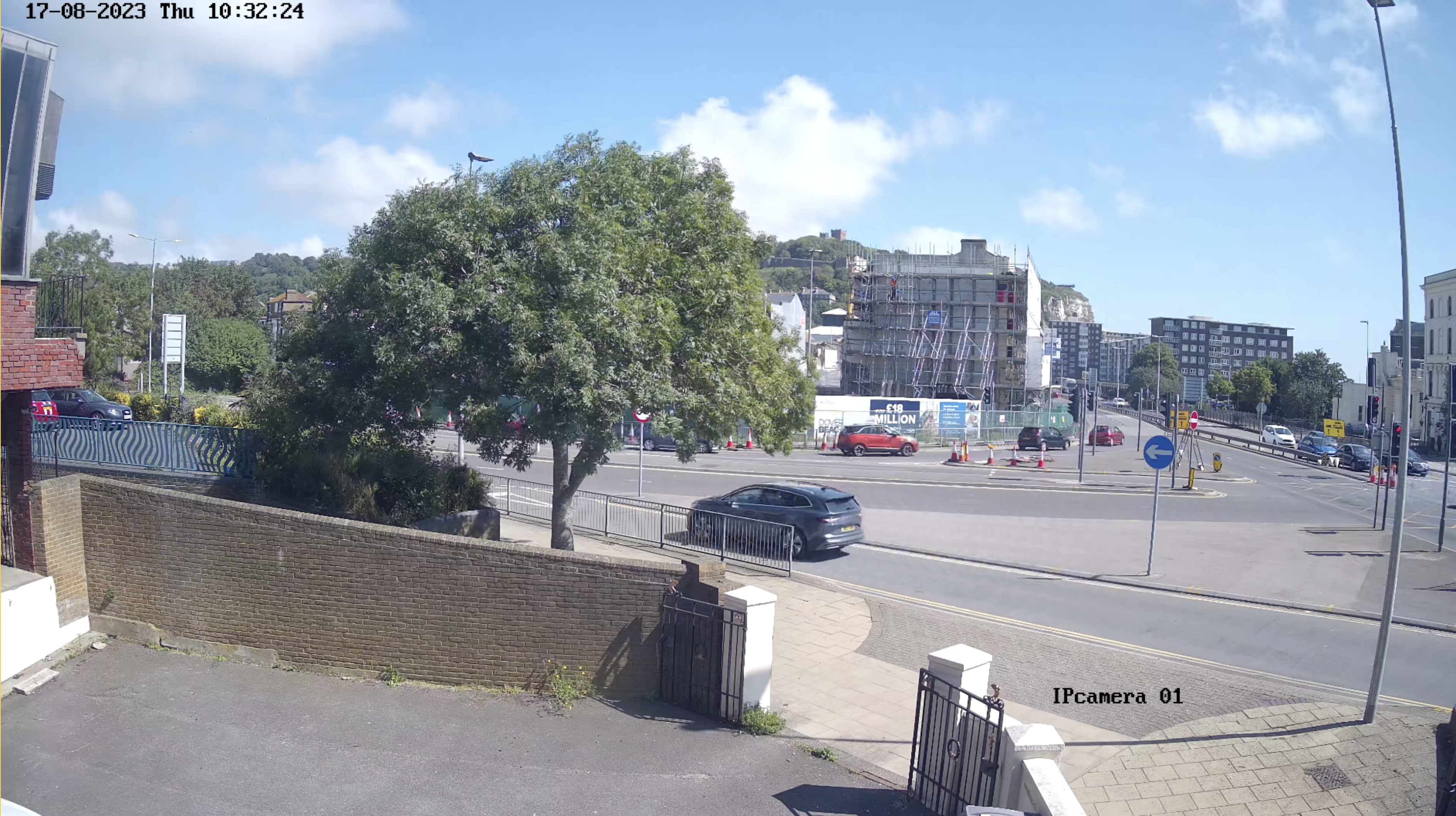

In regards to the FoV you would get from the standard 2.8mm 8MP turret, see the below screenshot from our office demo camera (this is positioned slightly higher than yours would be and you would probably angle yours down a little more to get more coverage below the camera).
Thank you for the screenshot. This looks very good, but I think in my case the vertical viewing angle could be too smal.
