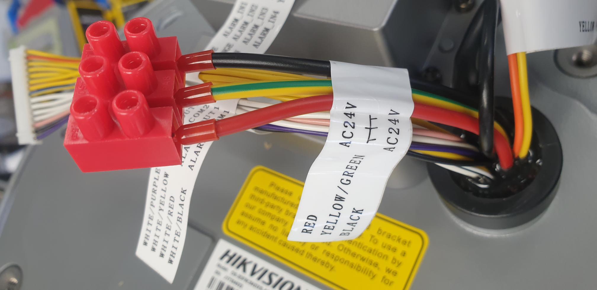

The obvious thing to do is to power the camera using our 24V dc supply via the 24V terminals, however they are labelled as 24Vac (as are all of the references in the specs and user docs). Clearly the camera converts this input into DC supplies internally and these will take a dc input themselves, so knowing what little I do about PSU design, I imagine there is a bridge rectifier on the other end of the input leads which rectifies any input Voltage to dc.
To further add grist t'mill, the "24V ac" input wires are colour (coded) RED and BLACK, suggesting a preferred polarity for connection of a dc feed.
Question: Is it safe to power this camera using a 24V dc feed?
