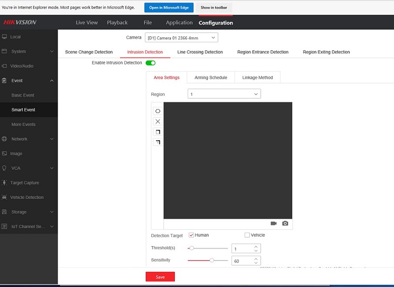

I then tried to set up the event detection parameters by navigating the browser to Configuration > Event > Smart Event > Intrusion Detection.
The camera image is just a grey box with no image displayed (although the other three cameras display correctly):

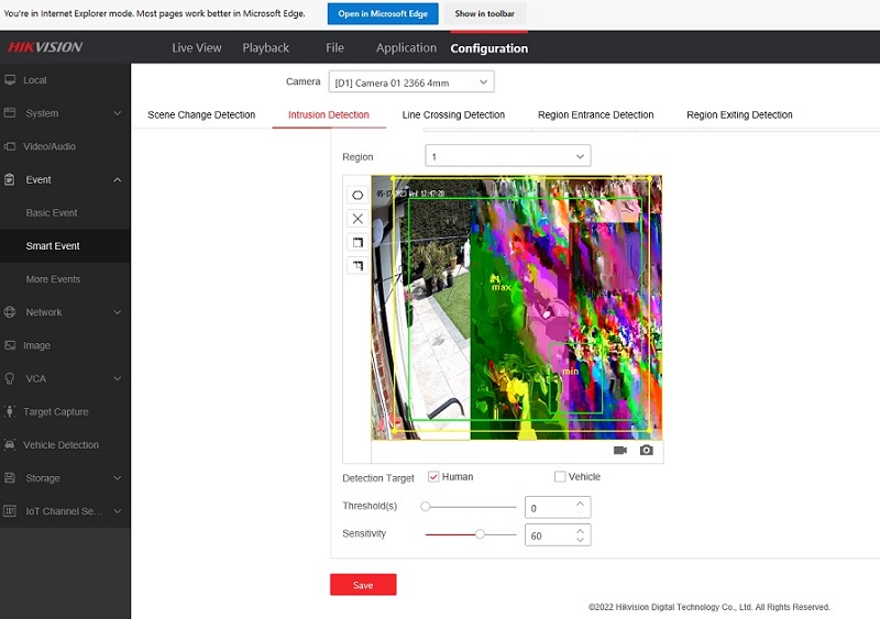

So I tried logging directly into the camera and the image was displayed as expected so I set up the parameters, max, min and detection areas there and saved them.
After going back to the browser the min, max and area settings had been saved and the image was now visible on the configuration page however the image was pixelating.

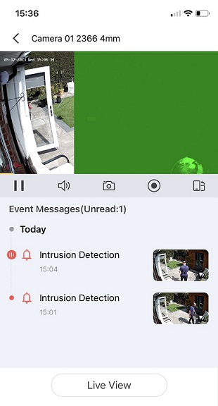

I decided to leave it for a day or so to see if it settled down but Intrusion Detection appears not to be working despite setting min, max and area. Some detections started coming through in Hik-Connect but they are hit and miss. The notification videos are partial green for first several minutes and playback stutters and jumps erratically.

Your setup looks good, but you shouldn't need to use Internet Explorer mode when accessing your NVR as it's an M-Series model which works well in modern browsers.
There was a similar green screen issue (like in your Hik-Connect screenshot) on some earlier I-Series firmware, so I would first check that your NVR is running firmware V4.63.005_230512, after that, wipe and reconfigure the intrusion detection settings in Edge (not in IE mode), and see if that helps things.
If not, you may need to roll back the camera firmware and upgrade in stages through the 5.7.x versions from the Hikvision UK Portal, as big jumps can sometimes cause problems like this.

I would try a hard reset of the camera to see if this clears the picture up (which is always good practice following big updates anyway) and then redraw the intrusion settings:
I've hard reset the camera as suggested.
Its kept the latest firmware and now the picture appears on the NVR's smart event page (no longer a grey box) and is clear, so that's a result.

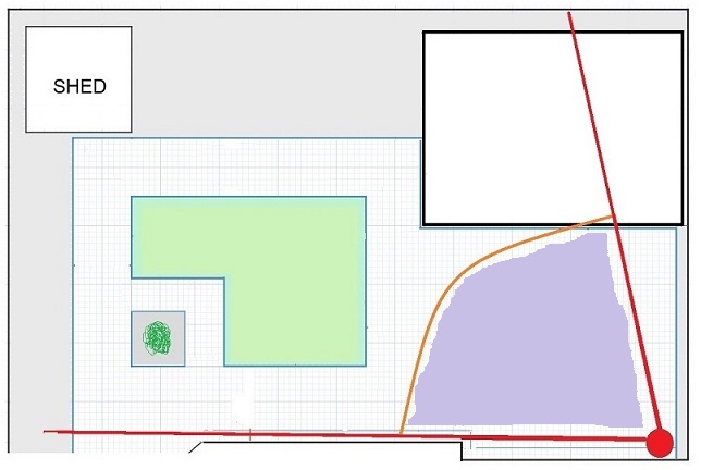

The camera is mounted to cover the entire rear garden. The garden is approximately ten metres by six metres.
The camera is placed in one corner looking diagonally across to the other.
Despite drawing the intrusion area as the whole picture I only get an alert if the target moves within four metres of the camera?
I've played around with the threshold and sensitivity but it makes no difference.
Any movement outside of the purple area (about four square metres) on the below drawing is not being detected.

I'm going to try setting up line crossing detection and see if that works to detect movement at the shed area.

Was the camera detecting targets beyond the ~4m before you updated the firmware?
As you only have "human" set as the detection target, the camera must be struggling to recognise a human form unless it is within the 4m, so it would be interesting if it was better at this on the earlier firmware...
Also, have you tested an even smaller minimum target size than the one in your screenshot in post #1?
You can't have this too small really, as you're using the Acusense in the camera anyway.

Updating the firmware was the first thing I did before setting the detection settings so I have no idea how it was on the earlier version.
Line crossing works and detects human movement 10m away.
Intrusion detection still doesn't detect movement beyond ~4m even after reducing the minimum target size and ramping up the sensitivity to 100
As long as I have some form of detection at the far end of the garden I can live with it.
