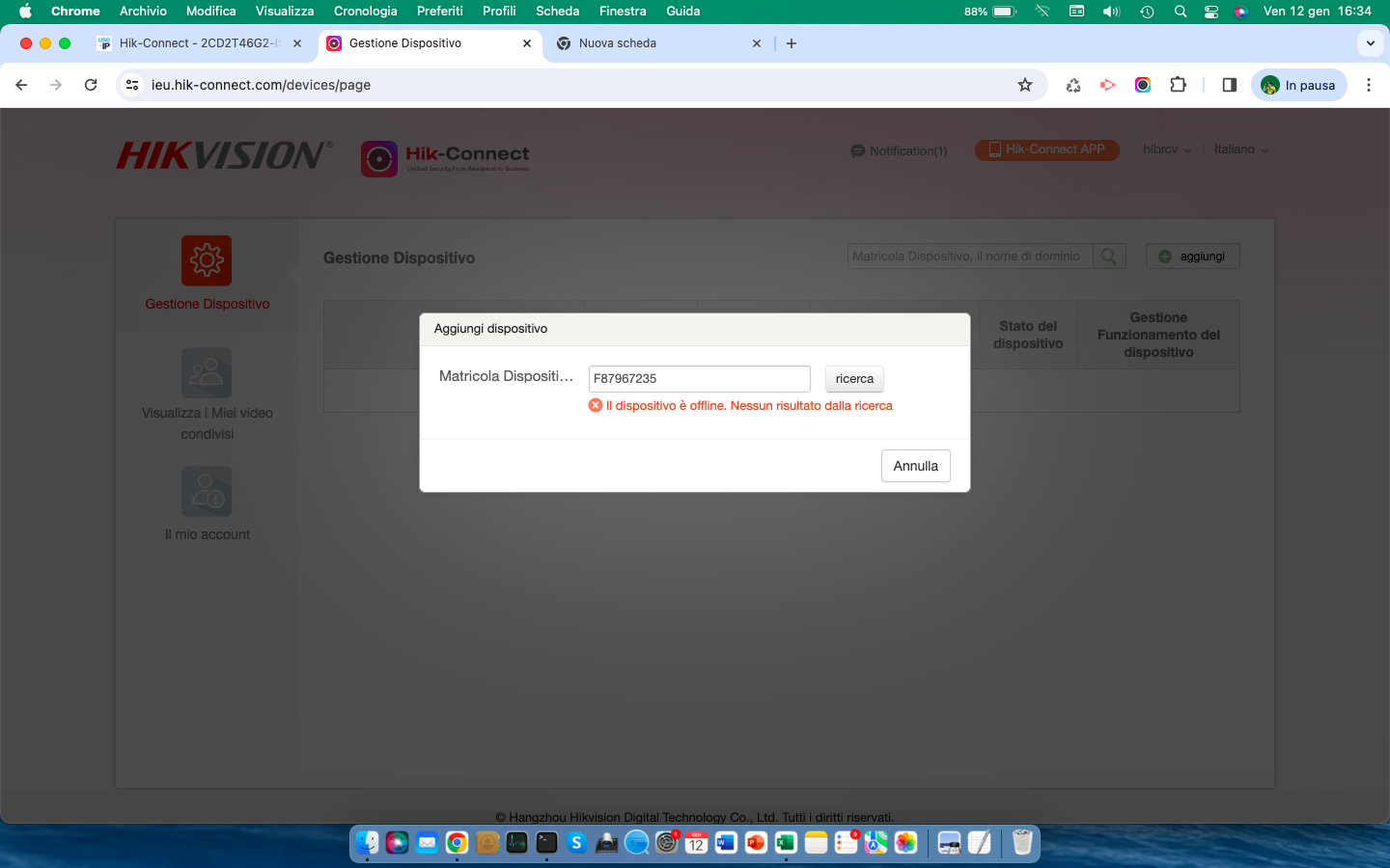

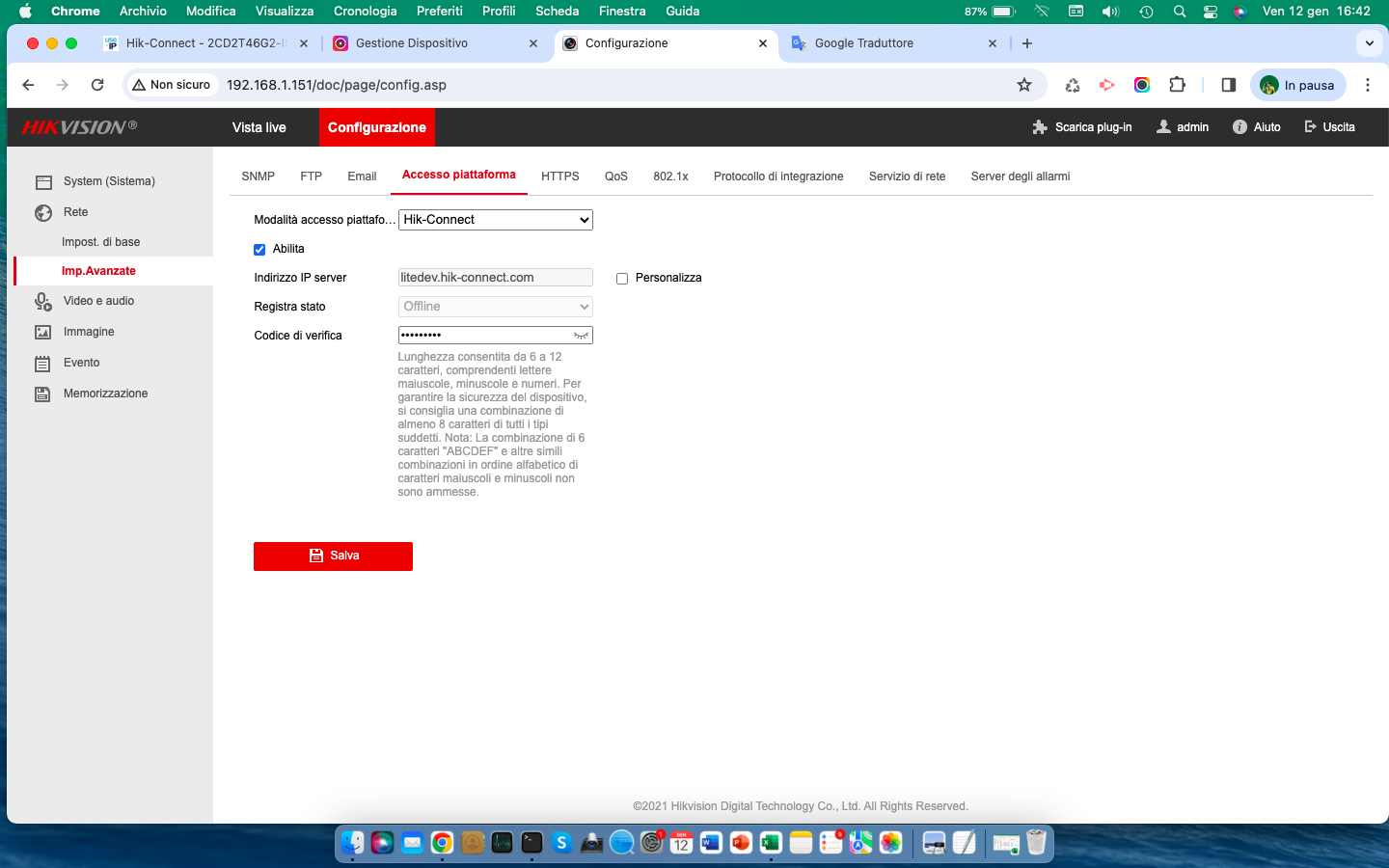

1) From both accesses the camera appears OFFLINE, while accessing with the browser I see the live view page

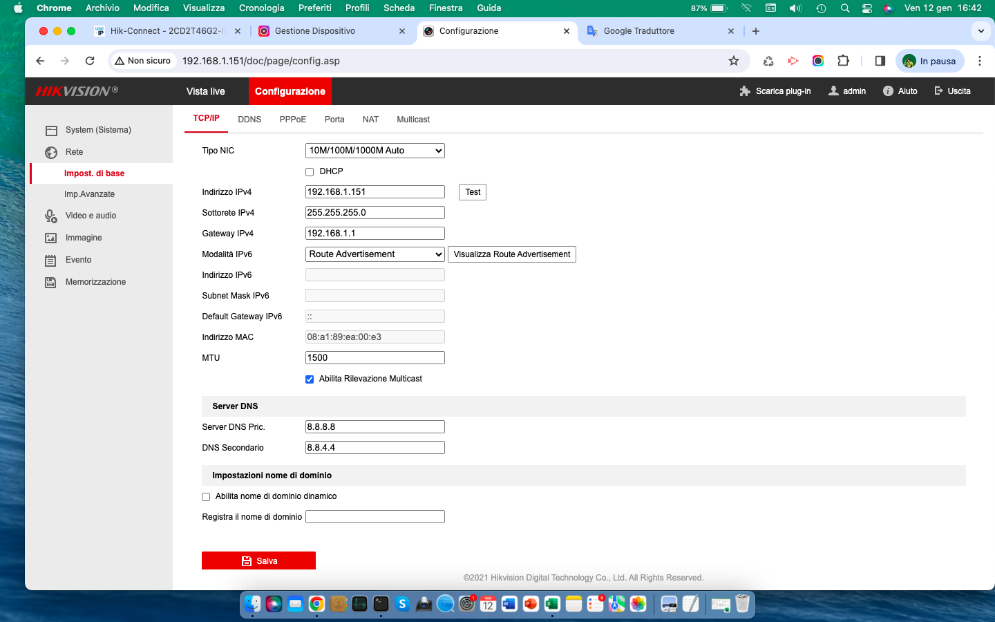

2) in the main DNS server I set the Google one to 8.8.8.8 and the secondary one to 8.8.4.4

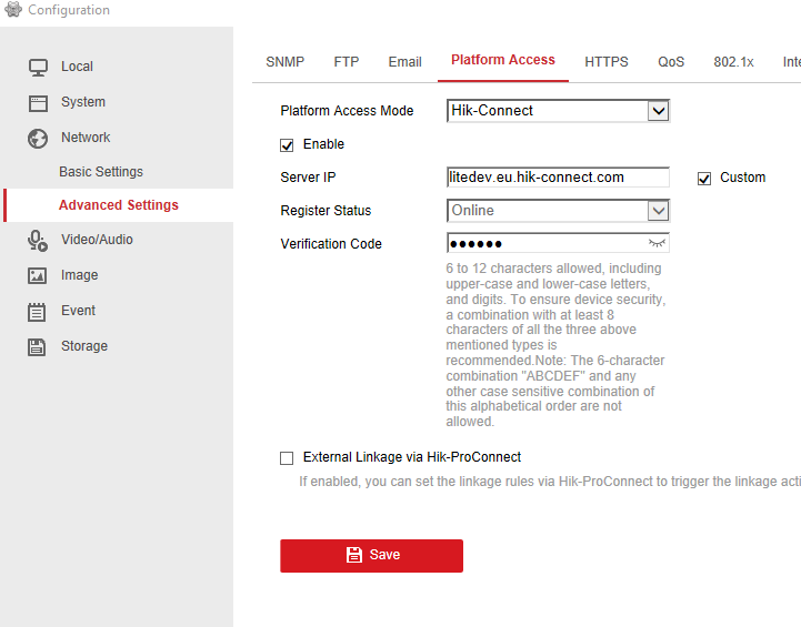

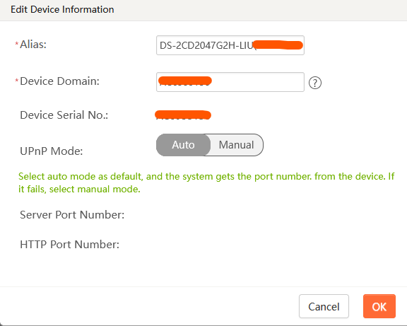

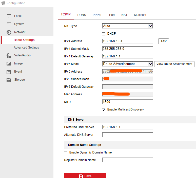

- I used to have your configuration but I had issues so changed to this below. Also check the green note for UPnP mode, third picture
- I use the eu server: litedev.eu.hik-connect.com(don't know if there is a difference)
- and ipv6 is enabled(I don't know if this matters too)
- What I noticed when added the hybrid a month ago, is that I had to restart phone not just close hikconnect, logout iVMS and restart PC.
This could possibly be a server delay to accept or something else. I did not have this problem the past 4 years
