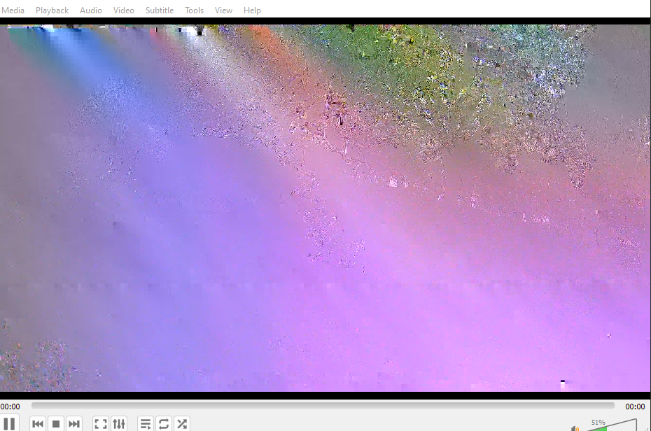

I hadn't realised that all my cameras are now running H.265. I am sure they were on H.264 and they certainly worked with RSTP so must have been.
I've changed one of them to H.264 and it is showing.. something now... but still not quite right.
But.. progress!! :)
OK, and Stream Encryption was the last missing piece.
Many thanks indeed Kyle, that's really appreciated :)
