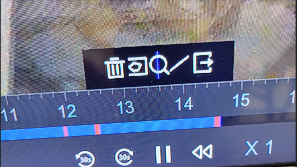

Button mix came back, more frequent now with this firmware. This is now an everyday issue and of course very annoying.
