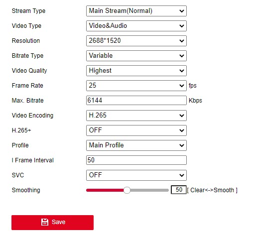

Not sure how to get the stats up within the web GUI but its smooth in sub stream 1 at 4mp 6144kbps

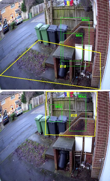

I decided to turn off Motion detection and use Smart Intrusion detection. I set up two zones, they are clearly laid out and the targets are walking side ways into the zones. I set up the min and max sizes realistically. Sensitivity at 100 and threshold at 1, with Human detection on. Last night I got false positives from animals both fox and badger. I got notifications to Hikconnect several times some of which the animals where not even close to the zones laid out.
Today, first day in daylight I messed with zones, line crossing and I can walk in and out the zones, not trigger, or at times it would trigger but way too late. Im sure there is something I have set up wrong?
