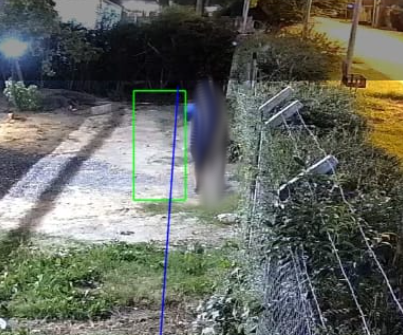

Hi alfaclvi! Thank you for the instructions. I think my issue is different: the acusense powered by the NVR is very slow, feels like it doesn't have enough resources to process the video from the camera in real time, so if I move fast it completely losses me and I'm able to cross the line without any alerts at all. If I cross it super slowly, then it seems to be able to process the event accordingly since it had more time to process the video.
This is an example of me walking at a normal pace. The NVR's Acusense detects a person but is a couple of frames behind (I blurred myself)
I think it makes sense that the NVR-powered Acusense is slower than one implemented in the camera itself, but I was surprised with the difference. It is basically useless for line crossing.

I cannot understand, but as I can see in your example, there is a delay in Detection and as it seems, the target box does not track, but follows the target.
Do you have the same issue in Playback? You can check with iVMS because the Acusense K NVR does not yet support view VCA on Playback.
I don't know if this is a processing power issue or Decoding capability if you have too many cameras processed by your NVR.
