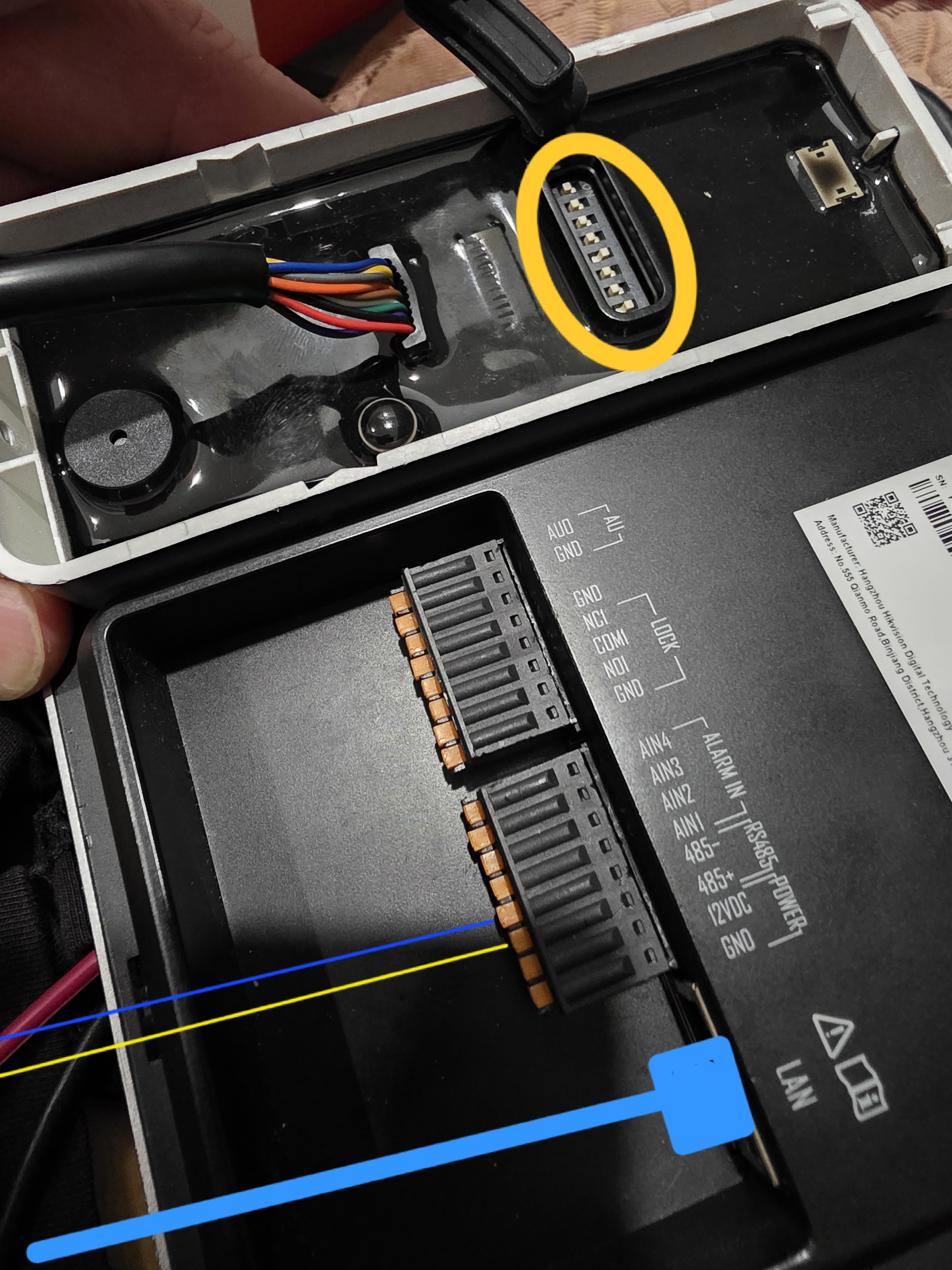

It appears that through the use of the RS-485 interface in the door station and that in the DS-1107 card reader that it may be possible but there is zero confirmation I can find of this in the documentation let alone instructions on how to achieve this like where to set the RS-485 address in the door station as you seem to be able to set one in the reader. Also, will the connected reader work with already enrolled cards, or will it need to be configured etc.
Any help or advice would be great, thanks in advance.
For everyones benefit, I bit the bullet and purchased the reader. Took a little experimentation due to the lack of documentation but it works like a second physical reader attached to the intercom as I had hoped. No new enrollment of cards or anything like that, no configuration on the Intercom in the settings.
The only config was with the dip switches on the reader, it is set to RS485 (not wiegand), enabling RS485 'match resistenace" and setting the RS485 address to 2 (3rd switch on of the 4 used to set the address) as the Intercom interface said the RS485 address was 1.

Hi there, Google has led me to your post.
I am currently in this same boat, only I have a DS-KV6113WPE and a DS-K1107AMK. I feel that the overarching operation should be the same as what your models use.
I am struggling to get the communication to work I think.
I have a 6113 working fine, I have 485A to 485A and 485B to 485B.
Tried several dip switch combinations to no avail. I can see there is next to zero RS485 settings in the door station other than the RS485 address is "1" and that is greyed out and cannot be changed.
The lamp on the 1107 is solid red which the manual says is how it should be (485 comms active).
Dropping a tag on the 1107 gives a short beep but no response from the 6113.
Entering a key code and pressing hash gives a beep at the 1107 and an error beep from the 6113 like that part is getting through.
A youtube video says dip 1 on only.
Comments say dips 1/5/8 on and it works.
Dip 5 has people confused as is for Wiegand.
Not sure why I'm not getting this working currently.
Any thoughts?
Starting to wonder if a firmware upgrade is going to be the right idea or if that may do more harm than good.
Appreciate the post!
Nope never mind, success.
Upgraded the DS-KV6113WPE firmware from build 220108 to build 220816 and boom it works.
It works no matter what address you give the additional reader.
Works with or without the "match resistance" and the DIP5 setting youtube comments reckon helps.
Good process too, the door station retained all the settings. Did the upgrade and it literally all just worked.
Now I just have to work out how to register a keypad code and we're sweet.
