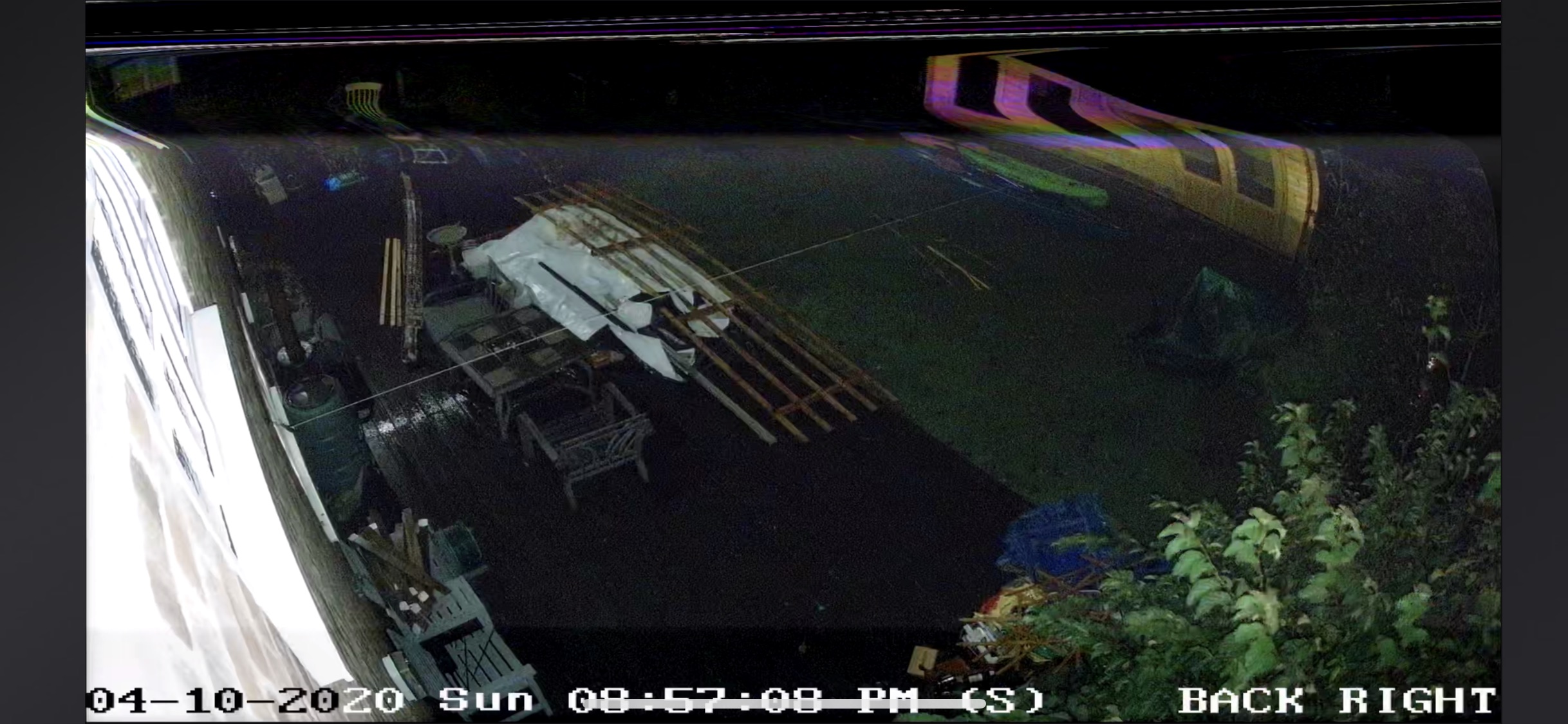

Installed system all way good but now Having issues at night time with the colour vue cameras they keep cutting out going all pixely flickering only at nighttime and have a strange line at the top of the image on all cameras even during daytime
can anyone help or knows what’s wrong?

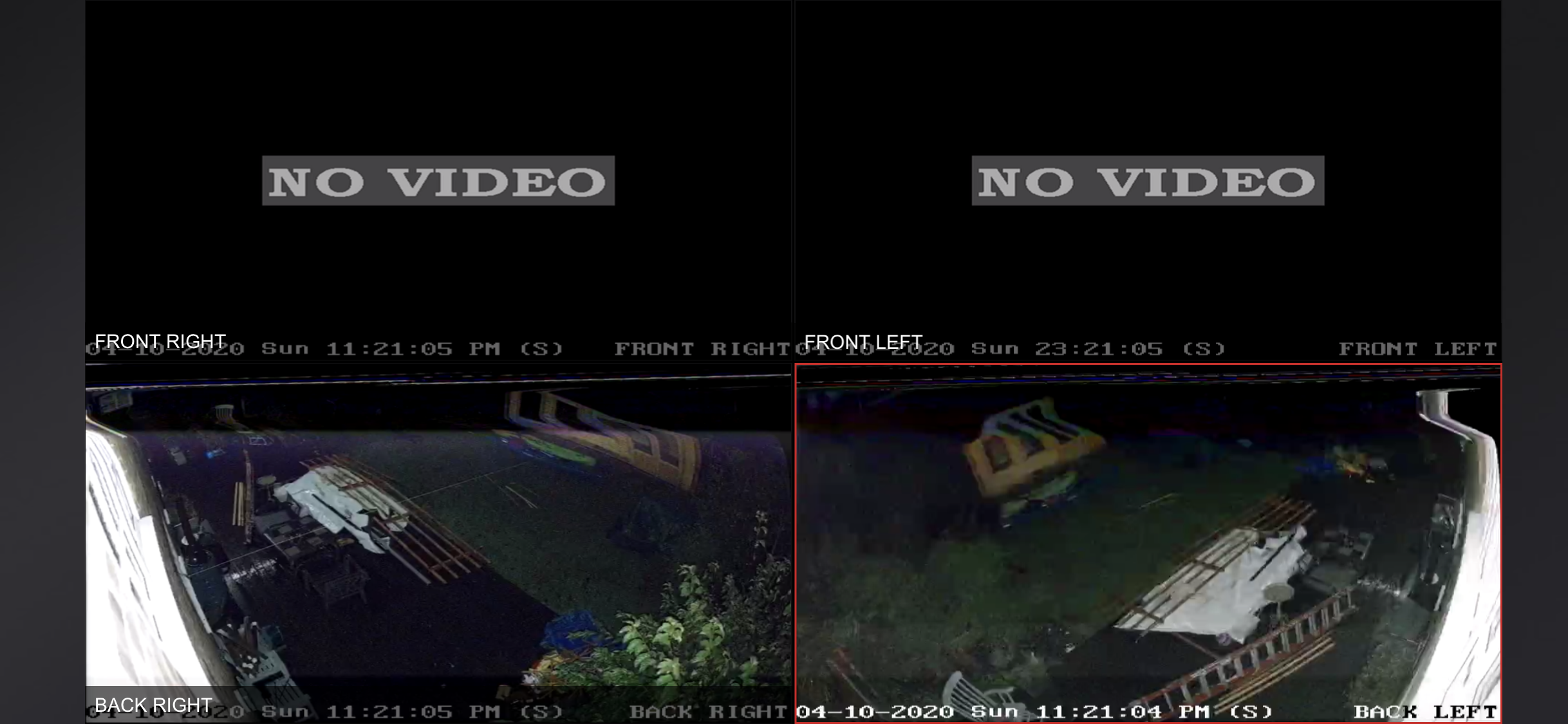

I’m having the same issue as you did. When you say power cables, do you mean bnc cables or the power supply unit itself?
I’ve just put in a brand new bnc cable in and ran the camera fine during the day for about 4hrs.
Night mode hit and the camera started to flicker and instantly went to ‘no video’.
I waited for morning and thought day mode will bring up the video once replugged back in but now the video flicks on and back off again.
My camera is colorvu.
I’m using a 3amp power supply unit.
Any help or advice would be much appreciated!
