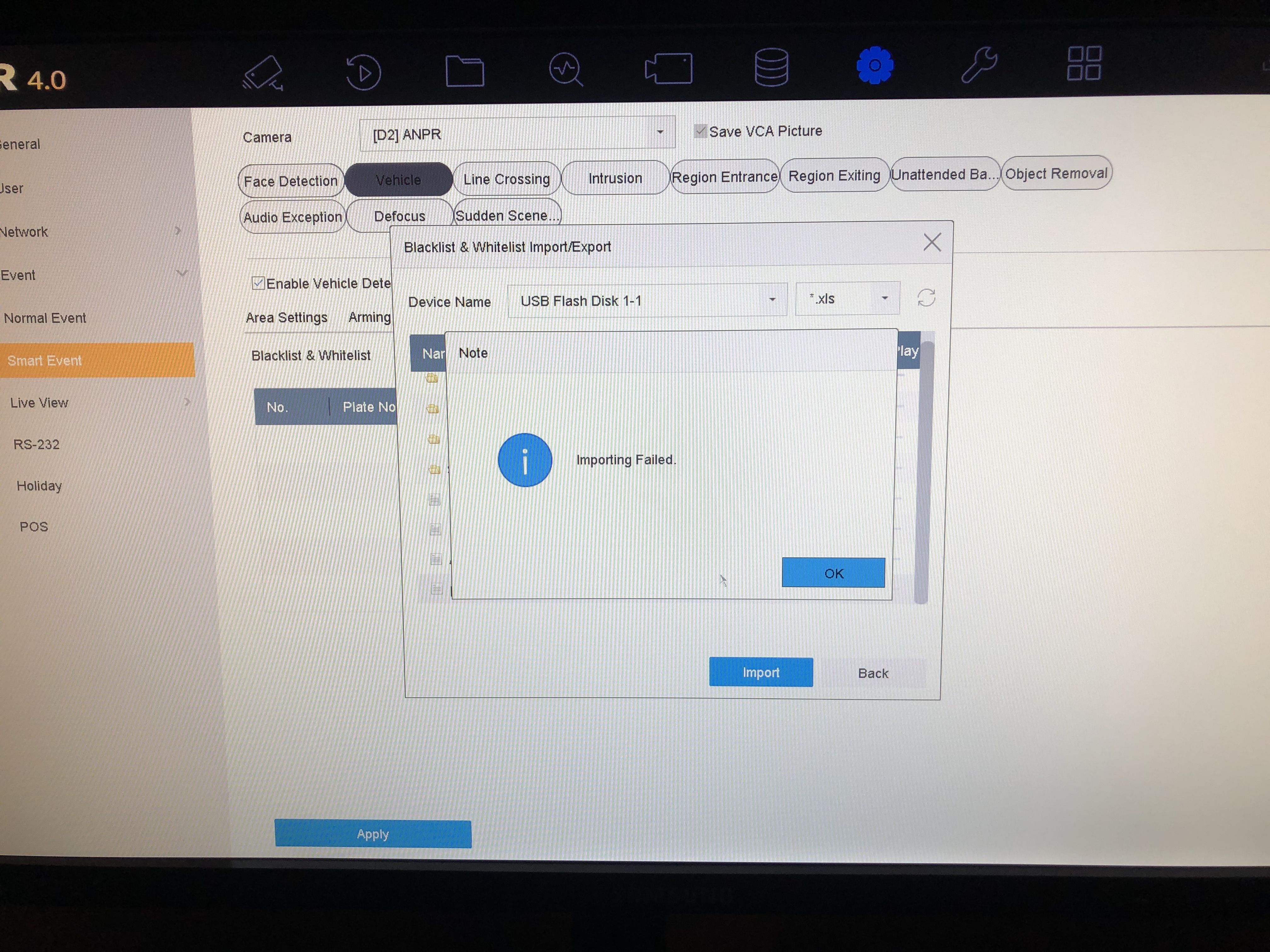

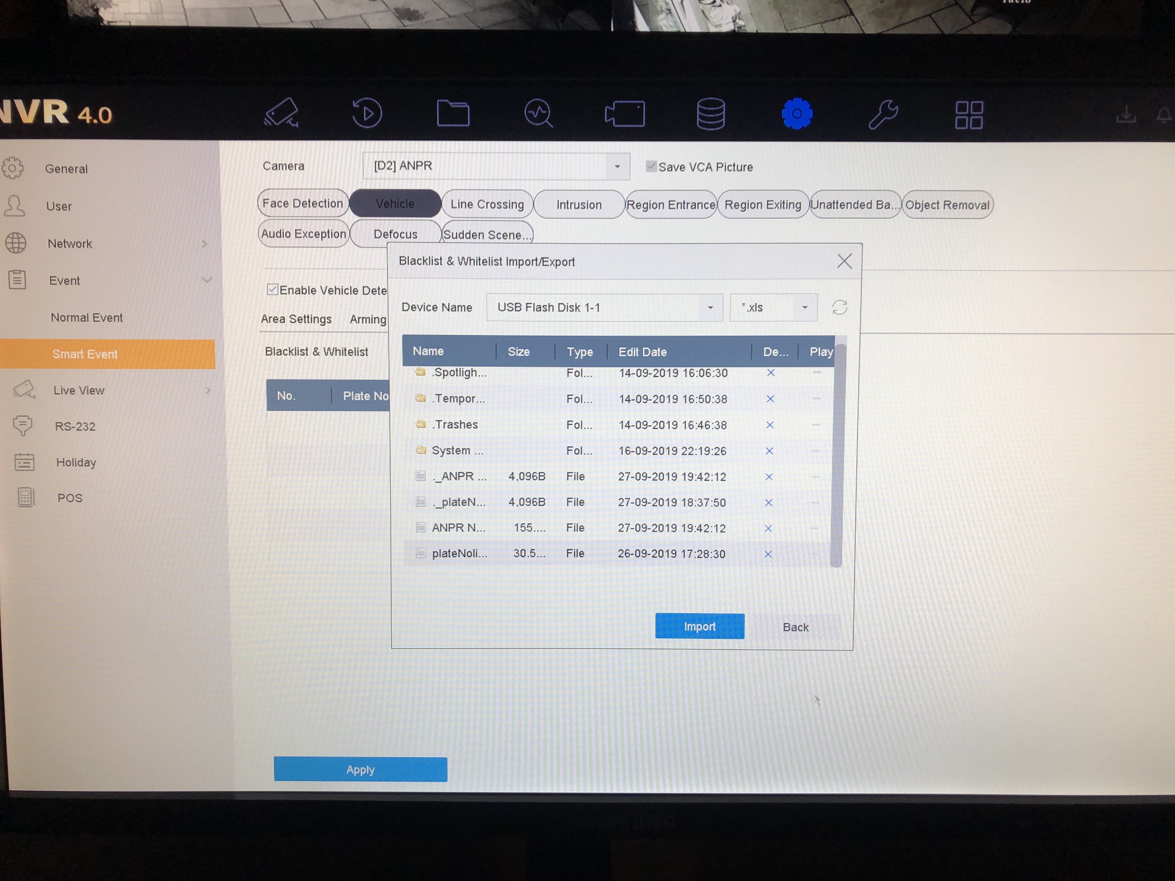

The NVR is a DS7708NI-I4/8P the problem I have found with this is when trying to import the Black&White list on firmware V4.21.008 build 190625 every time I try an import the xls file a message comes up saying import failed. So I then thought that I’ll down great to V4.21.005 build 190509 but unfortunately still the same issue occurred. Then I thought I would downgrade again to V4.1.64 build 190119 an for some reason the import file was Successfully imported. I was wondering if anybody else had this problem?

Im still having issues with the NVR not accepting an imported Blacklist and Whitelist. I've tried through the NVR with a USB stick an I've even tried logging on to the NVR trough the WEB GUI but still no luck
The NVR is running the latest firmware V4.21.008, Build 190625
