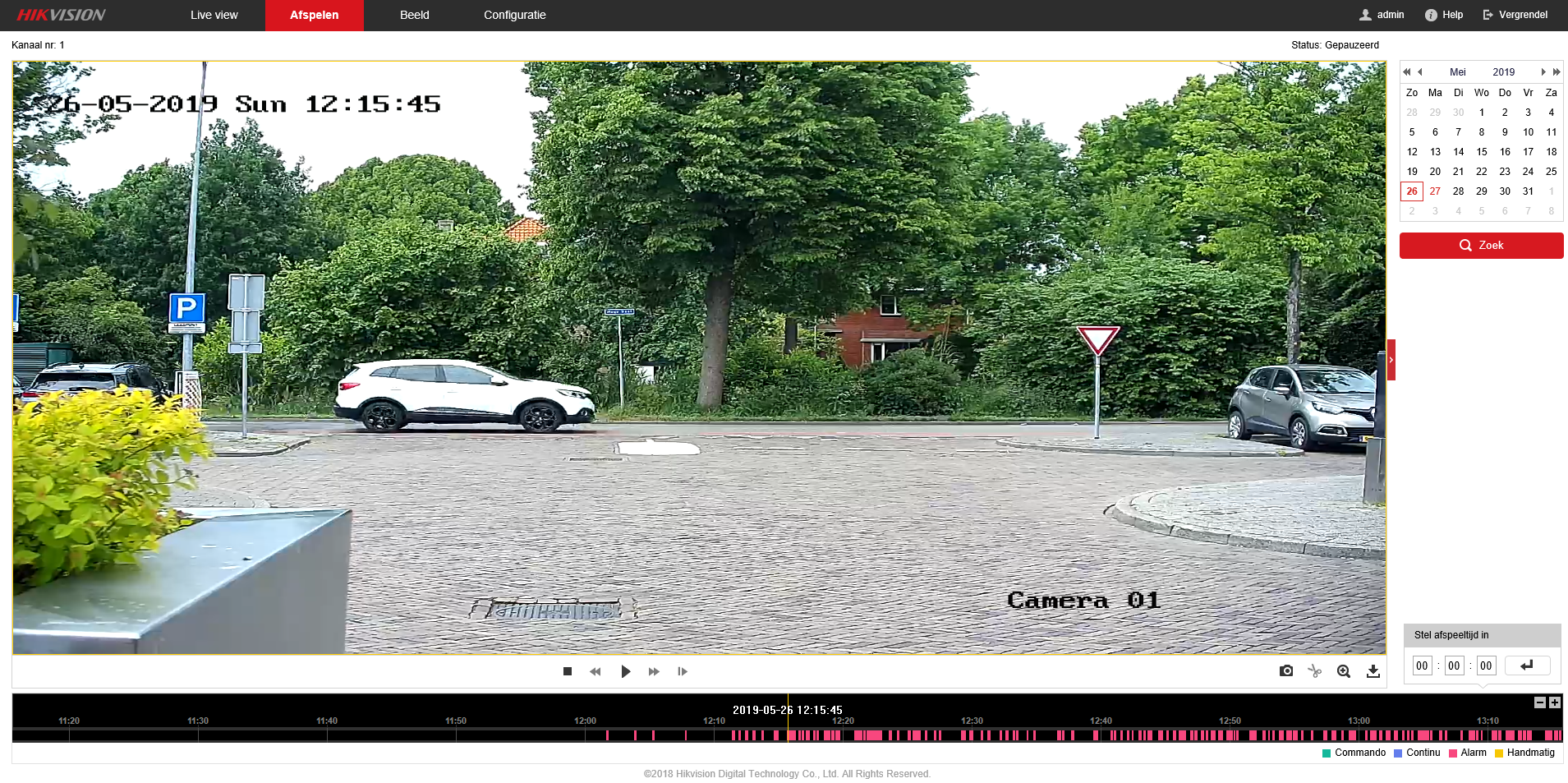

Hi Andyc,
I can tell you that it's true that the iVMS-4200 only exports pictures, but your SD card does record videos. I don't know how to export this, but you can view them. How to:
- Connect a PC to the camera while running with the SD card still in camera.
- Start Internet Explorer as Administrator
- Go to the IP address of the camera. Log into the Hikvision admin.
- My settings are in Dutch, but the first tab is Live view, the second tab is for checking the videos in the browser! Go to the right date in the right hand side. Below in the screen should be all the hits, just press play. See attachment for printscreen.
Ruben
