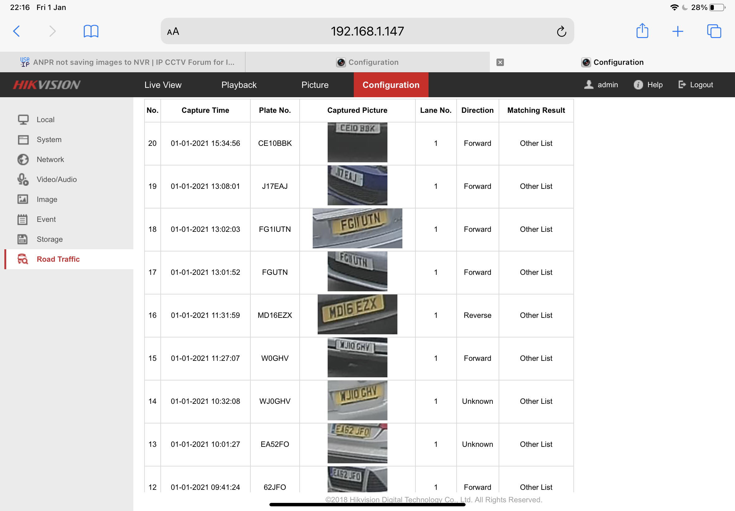

The ANPR is correctly configured and working and is capturing the number plate registrations as it is listed when I go to the camera web browser and click on the Configuration --> Road Traffic --> Real-time LPR Result and the max. 20 records are listed.
My issue is that the NVR is the saving the number plate images to the NVR as if I go to Picture --> Search then it says no pictures found.
I have been reading on this forum and looking at Youtube videos, and what I have noticed is that if I log on to the NVR web browser and go to the Configuration tab, and underneath there, I cannot see the sub heading "Vehicle Detection" which I'm assuming is where I configure the vehicle detection information similar to like I did directly on the ANPR web config.
