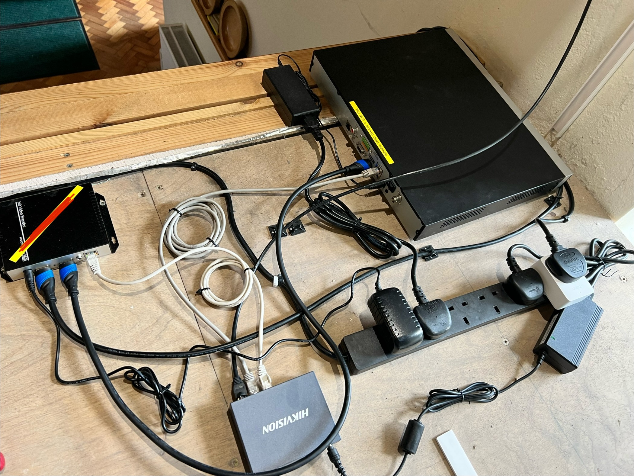

I use one of these:
In line from the HDMI port on the NVR - the signal passes through to the monitor - but the stream goes out to youtube here:
If you look for the 'live' stream - you'll see the NVR (currently a 9 way split) and has no issues with colour blocking, jitters or pauses. (You can scroll back through the timeline to watch video at different times of day) So far - aside from when the internet itself goes down - it's very reliable.
There are cheaper versions - particularly if you don't need the monitor pass-through. This one had the best reviews though for the price point so gave it a go. The software interface in browser is a little basic - but it works well. (You can see we've also added a clock on the top left and a text overlay middle right - both done through the streaming box). It's been running for several months now - never seen a coloured block/glitch or freeze. (it's usually the broadband goes offline in the middle of the night - and the whole thing doesn't automatically restart - that's a pain - but it's not the device or youtubes fault).
