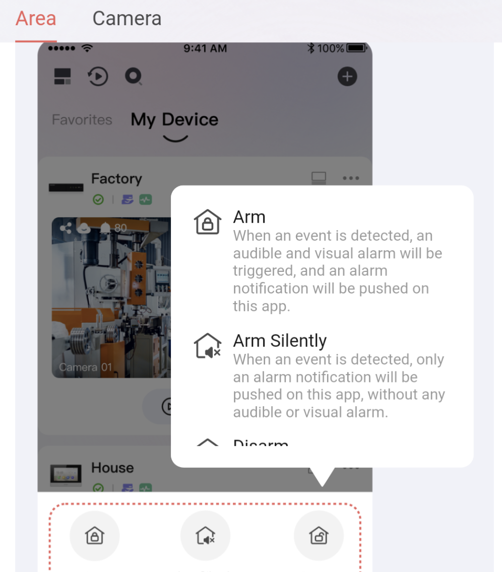

....unfortunately even if they [Hikvision] fix it, you may still have to suffer all the pop ups and buzzing 'Arm Silently' only disables audio alarms and strobe light alarms (on cameras that support them) It does not silence the push notification, which is what we'd like to happen. See the description in this pop up that James posted in his linked post:
"without any audible or visual alarm" is referring to the camera, not the mobile device.
