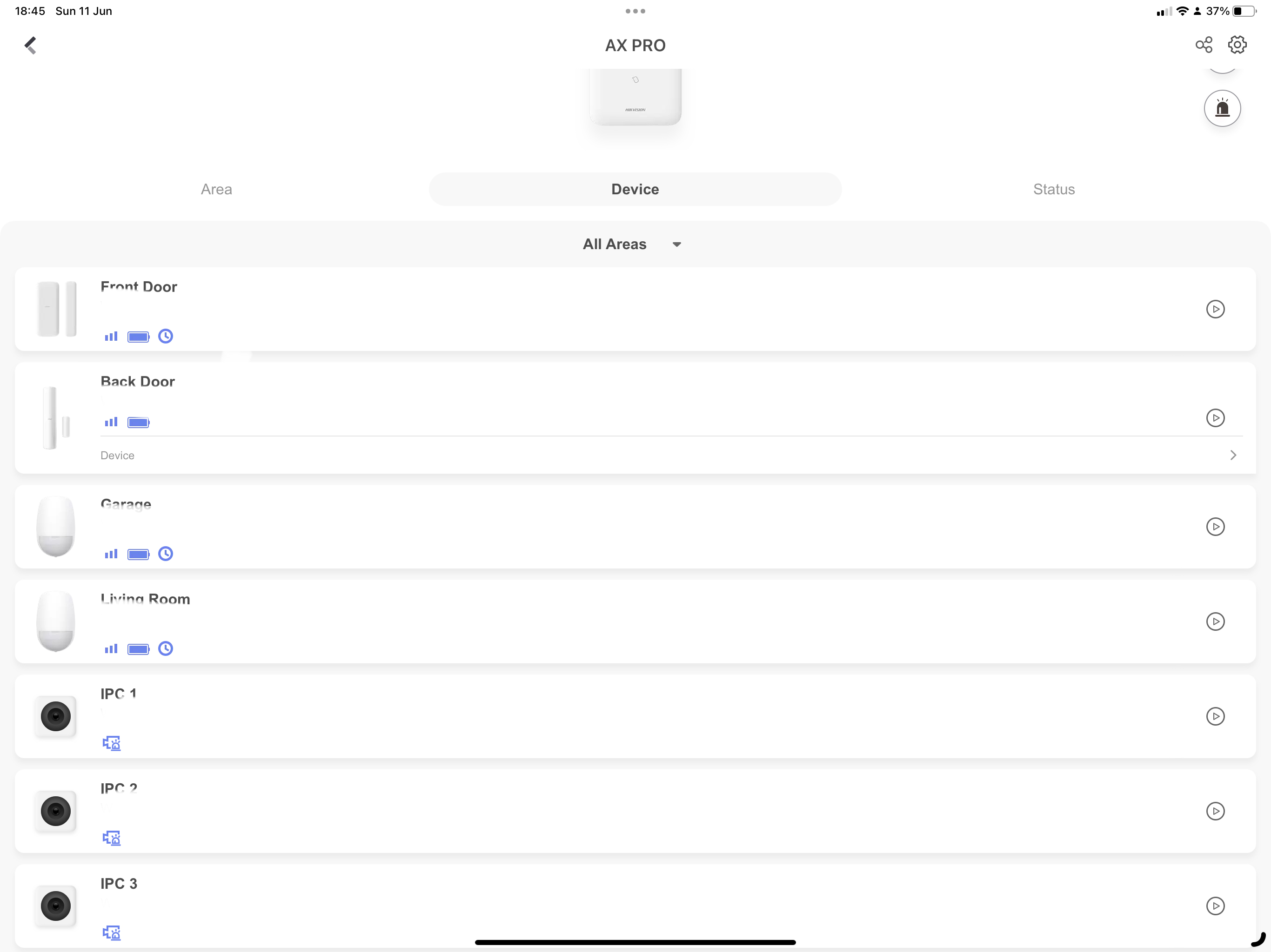

Very very strange one, i want to add a camera that’s already on my network, the one i want to add is 192.168.0.201
So below is a list of my cameras, generally their IP is in the range of 192.168.0.201 - 225.

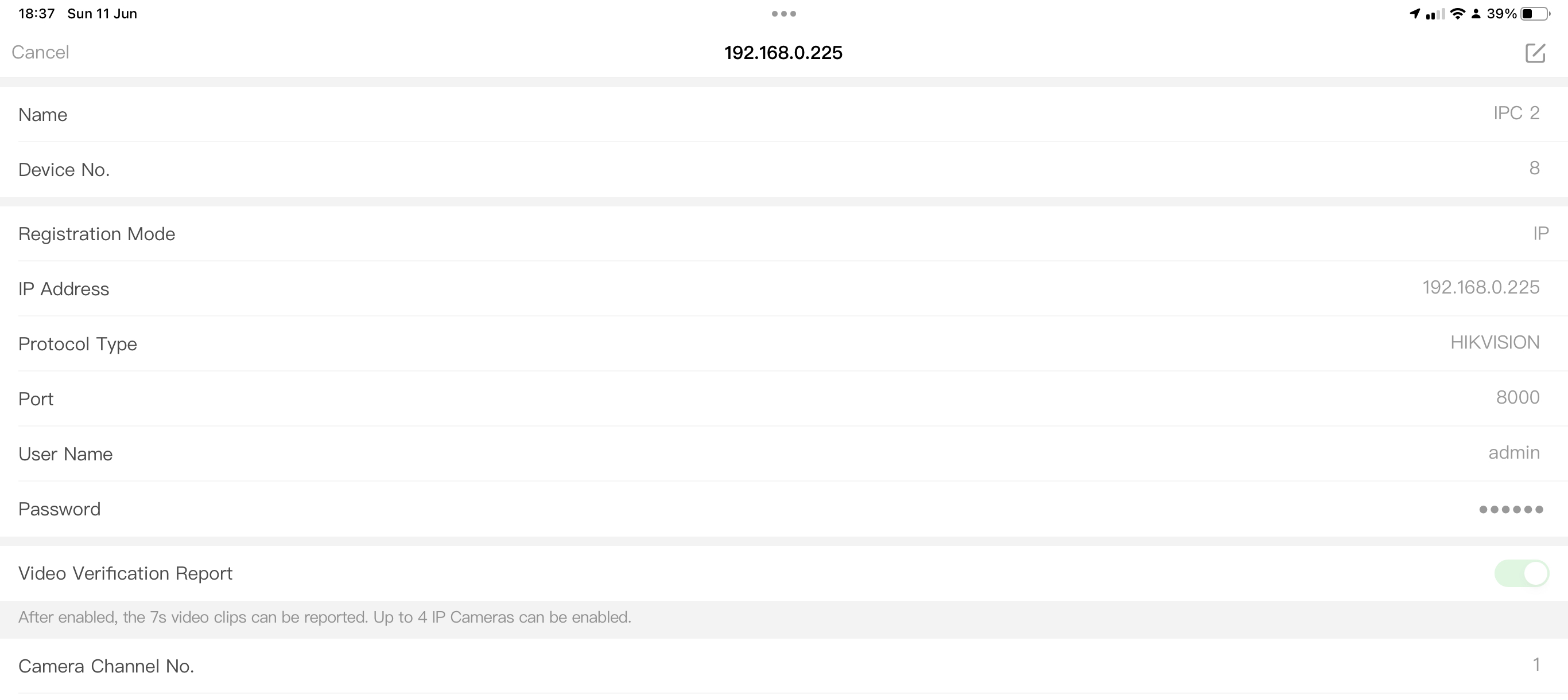

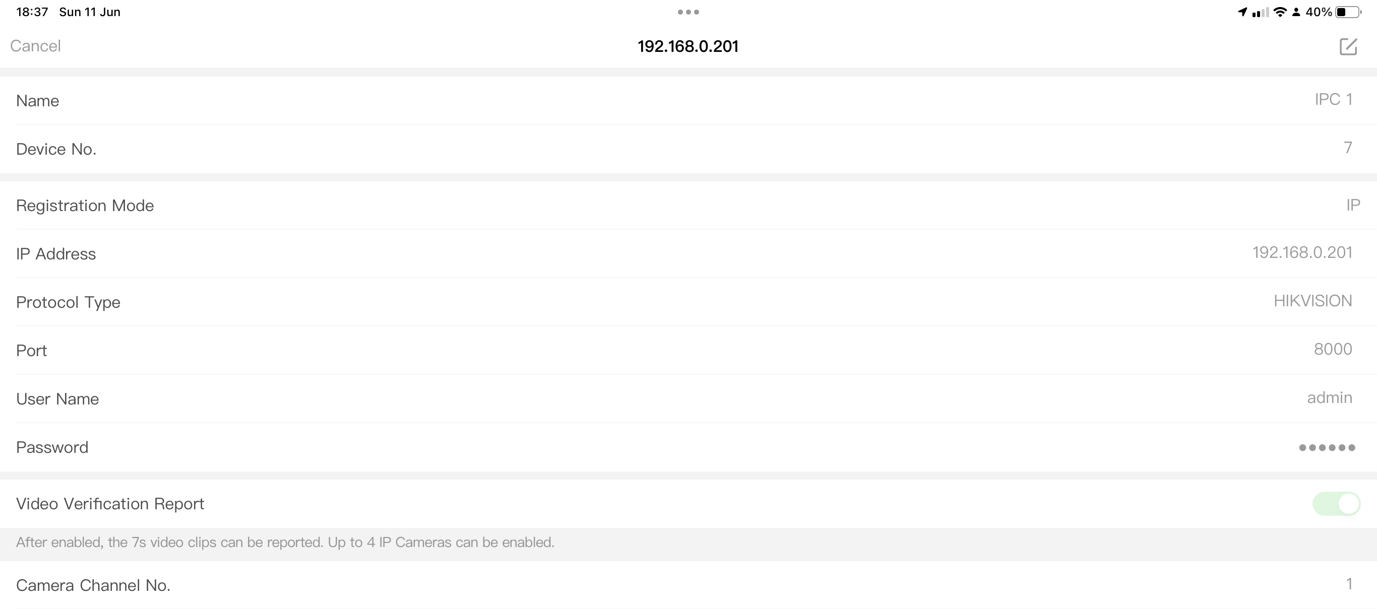

The actual camera i want to add is 192.168.0.201 when i do, or almost all other IPs in the range, the AX pro says its 192.168.0.201 or whichever one i select however when i press the option playback button the camera that gets displayed is 192.168.0.206
From the screen shots you’ll see a few examples I’ve added the below to the AX Pro with the following results
192.168.0.201 which displays 192.168.0.206
192.168.0.202 which displays 192.168.0.202 but i cannot replicate this with any others
192.168.0.207 which displays 192.168.0.206
192.168.0.225 which displays 192.168.0.206
Any ideas on how i can resolve this?

When I add my cameras I use the IP address of my NVR, not my individual camera. This then in turn adds all 4 cameras.
Hope this helps …
