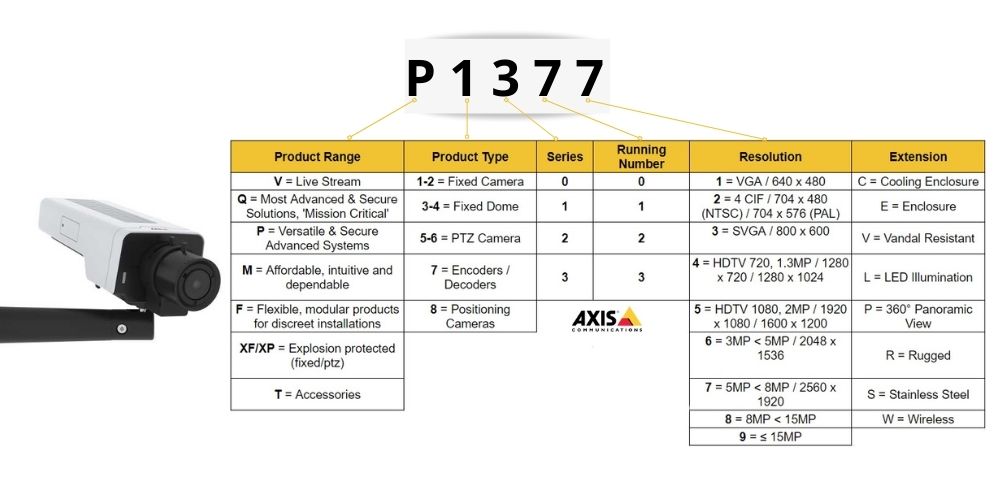

So now we have broken down each digit in the model name, let's take a look at how it looks in relation to the Axis P1377 5MP Lightfinder Network Box Camera 01808-001.
From this we know that the P1377 is:
- From the P range, so versatile and secure.
- A fixed camera, meaning it remains in one position making it ideal for deterrence.
- It's a series three camera (remember, Axis advise not to pay too much attention to this digit).
- The running number is 7 so it's the newer version of the P1367
- And the resolution is 7 meaning it is between 5MP and 8MP, a closer look at the product page and data sheet will provide more detail.
- As there is no extension to this part code, we know that it should not be used outdoors without the relevant enclosure (sold separately). We also know that it doesn't feature LED illumination which is a common requirement in security installation.
If the camera is intended for use outdoors and at low light levels, the user would be looking for the P1377-LE instead, Note the L for LED to support low light level video quality and the E for being out-of-the-box ready to install outdoors.
