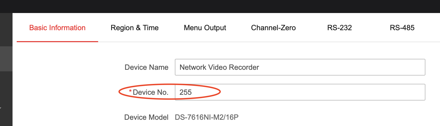

I "upgraded" from a 7608NI-I2/8P to the 16 channel M series a couple of months ago, and they've removed some features. The old one came with an IR remote control and an inbuilt buzzer for audible alarms- both are missing from the M series. There are the annoying firmware issues too M Series Firmware - 5.04.050_250124 Released
