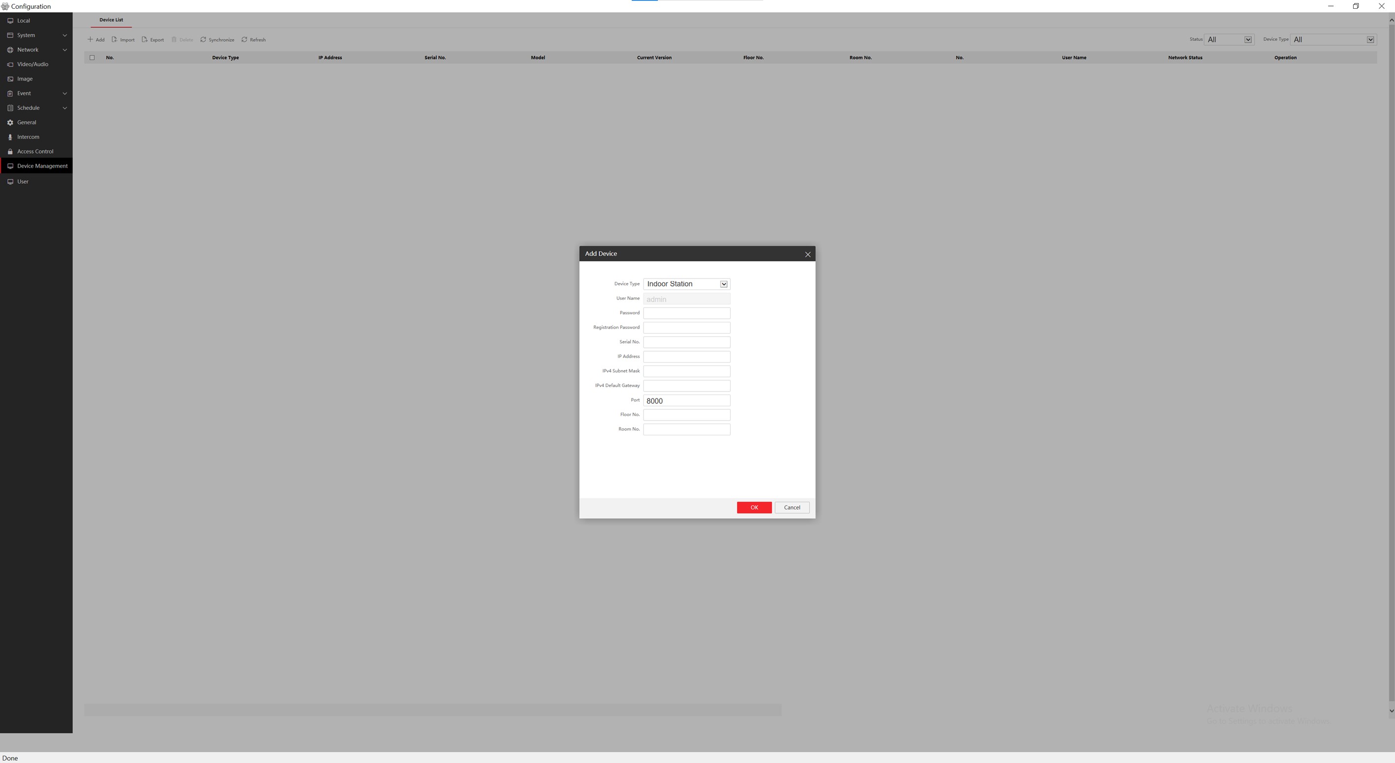

Have you added the indoor station to the main door station's device management page in iVMS-4200?
Everything in the screenshot below needs to be completed in the 'Add Device' window:
The Registration Password is set on the main door station in Config > Intercom > Session Settings
You will need to be using the latest firmware on both devices and also using the latest version of iVMS-4200 to see these pages.
Can you please confirm which main door station you're using, as well as the current firmware versions of this and your DS-KH6320-WTE1 if you can't see them?
