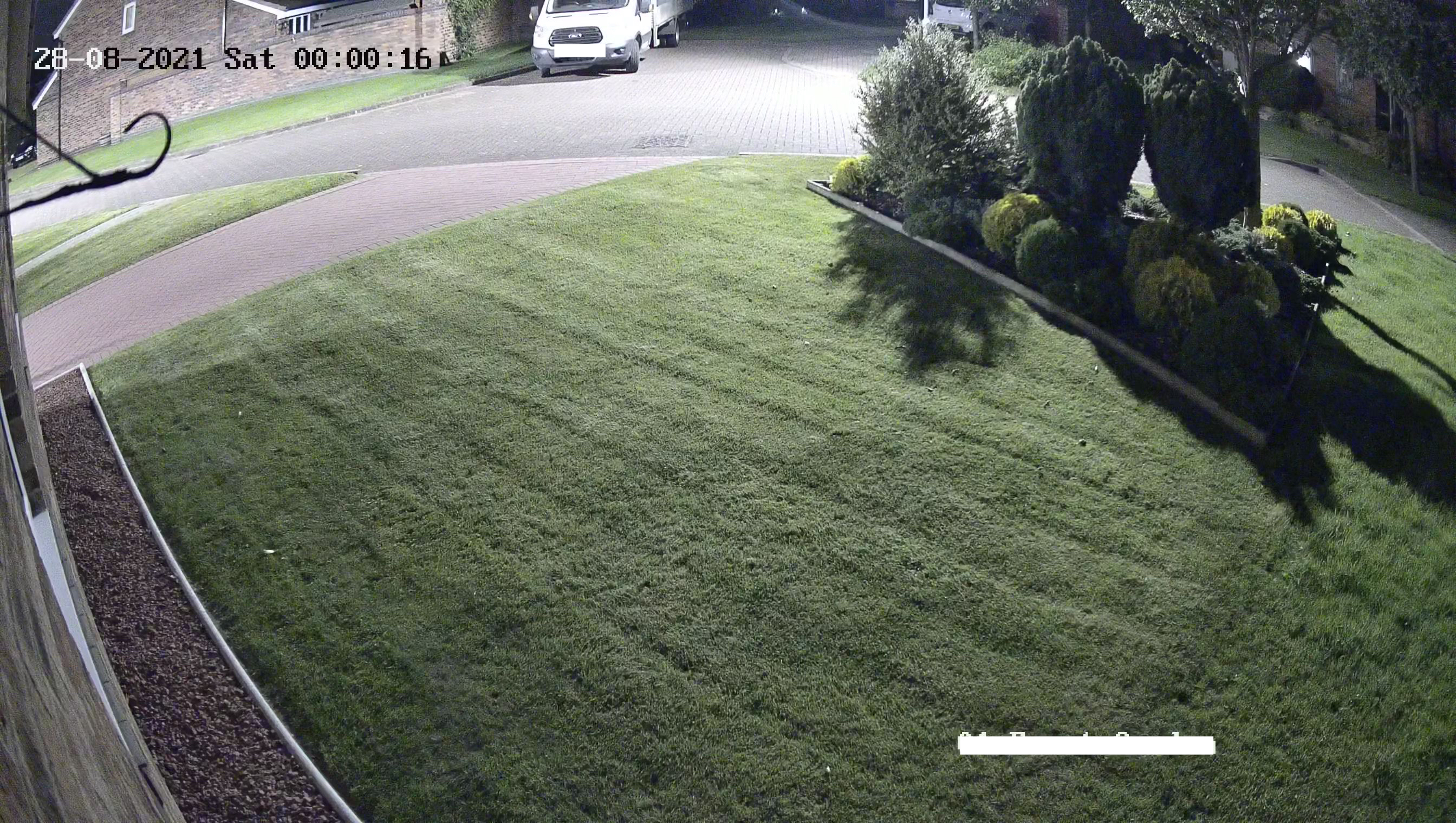

No problem. The older model ColorVu cameras (G1) had quite a cool white LED that was very harsh. The newer ones are definitely softer. It's not like a spotlight or anything. Whether you can set it up without the LED, really depends on whether there's any available light at all. They come set with a very slow shutter by default (1/12sec) and it's necessary to speed that up in order to eliminate motion blur (1/50sec min). The below is an image from a DS-2CD2347G2-IU at midnight with just street lighting. I set this one at 1/50sec shutter speed and have the LED disabled completely.
I think the available light would be a problem. Although I live on a main road and is well lit, the council turn off all street lighting at midnight and it does not come back on until early morning, 5.30am and its very dark during this time. I don't really want the bother of having to install my own lighting. Thanks anyway.
