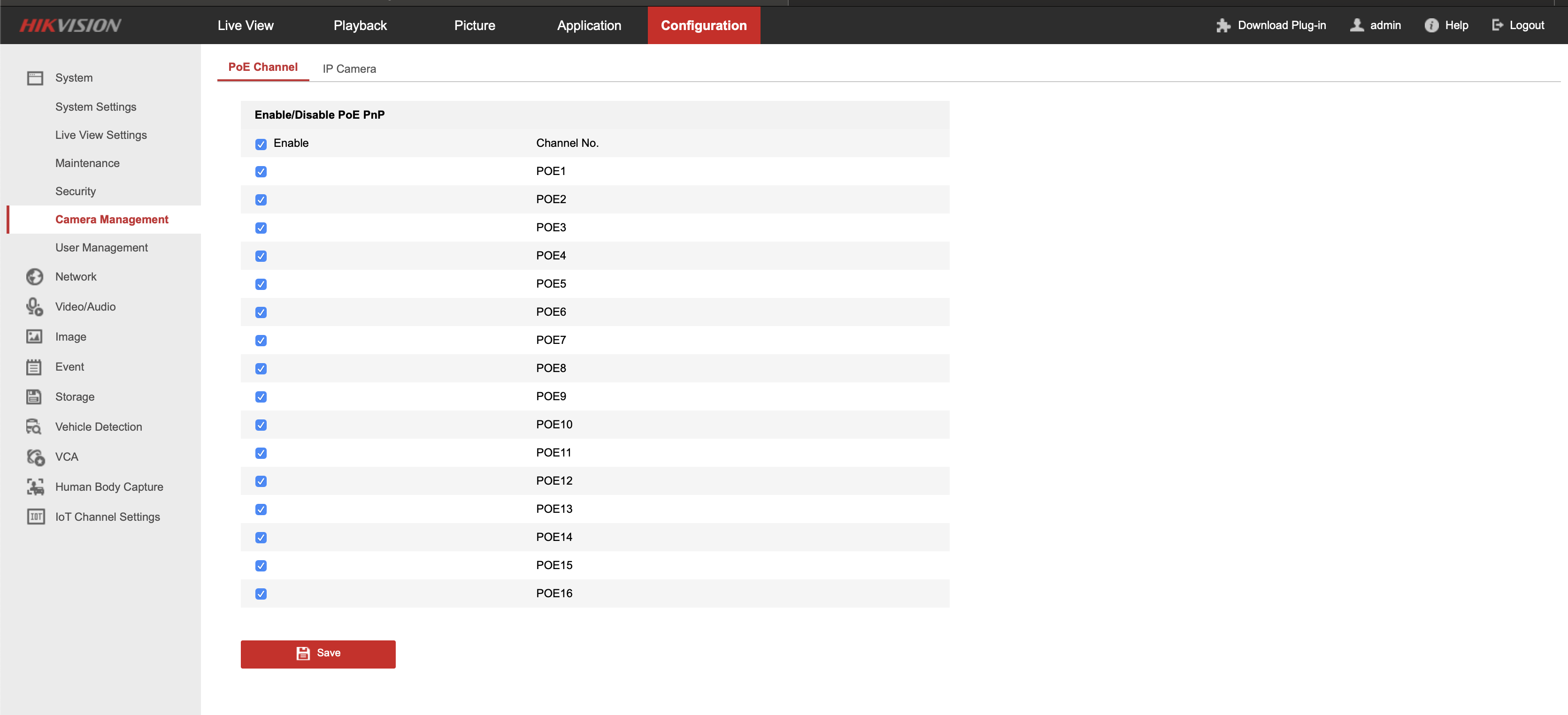

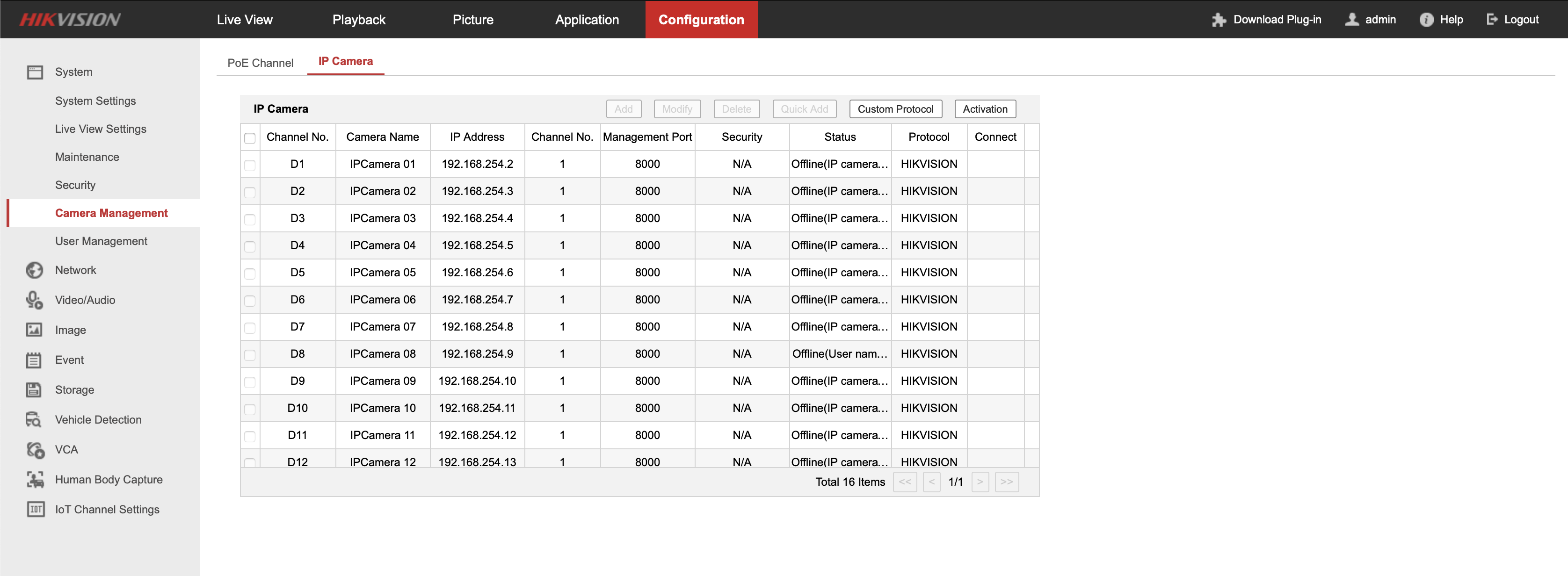

Hi fullboogie,
This is all I can see, I just cant get the cameras to go online.
You need to set up "virtual host" on your NVR. Do a search, there are a couple of threads on how to do it. I'm at work and can't offer much help right now.

I still can’t view cameras, they now have “User name or password wrong” and may have had this from the start of when I updated the firmware as I done a reset of the NVR and changed the password of the NVR. I have since changed the password back to the very first password that was on the NVR but still no view on cameras. When I go into PoE I can see the power that each camera is drawing but still no pictures. I have used the SADP tool and have all the camera details that HIk Vision would need to do a password reset but I don’t know where to send the information!
