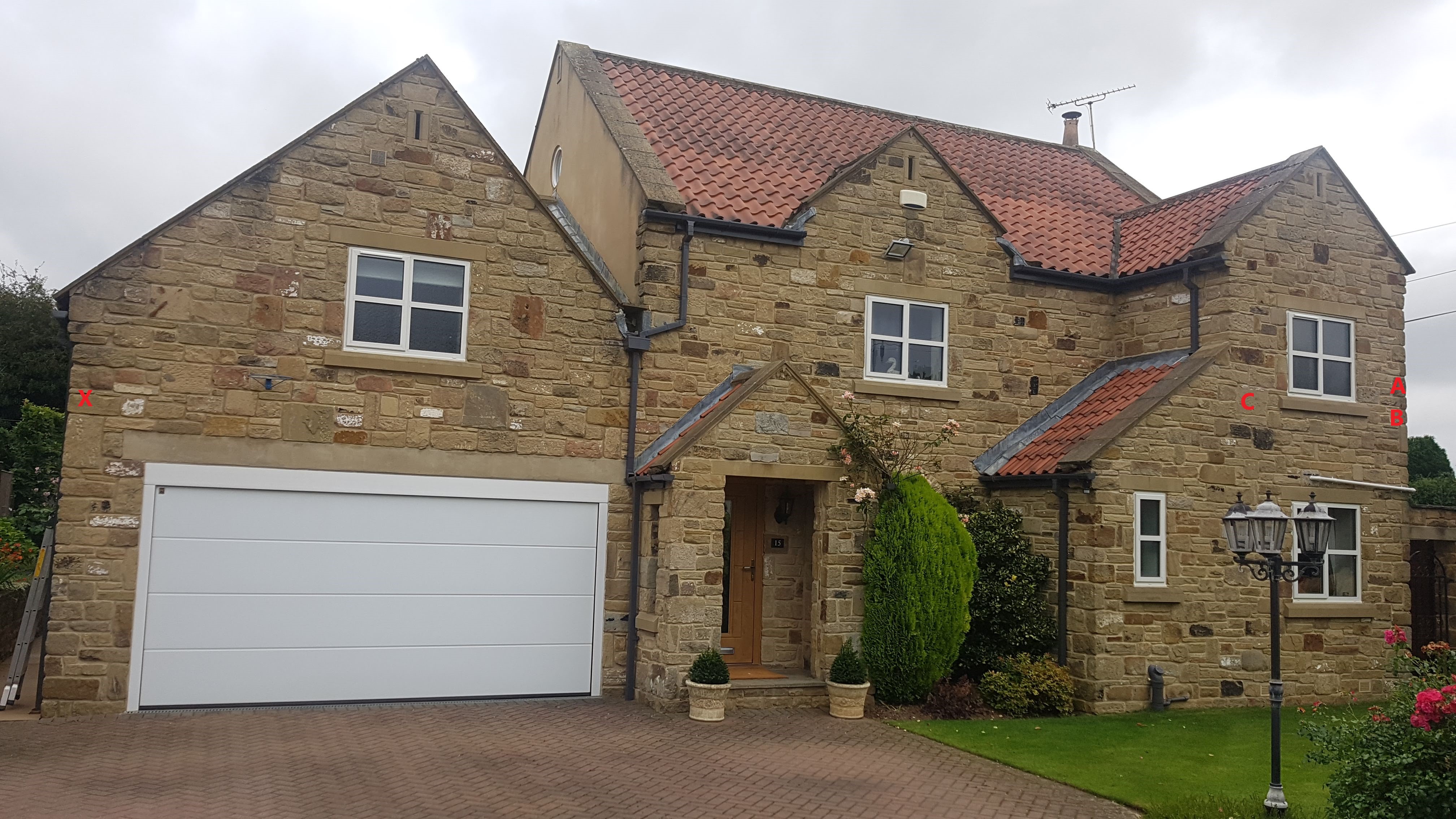

The following photo shows the 4 positions I have tried: A, B, C and X, where X is an optional camera, in addition to the one placed at A, B or C.
Originally, my thoughts were to place a 2.8mm lens camera at A and optionally a 4mm lens camera at X, however, the difference between the 2.8mm and 4mm isn't that huge and in fact the 2.8mm when placed high up, captures a lot of wall and/or neighbours garden, depending on how it is pointing.

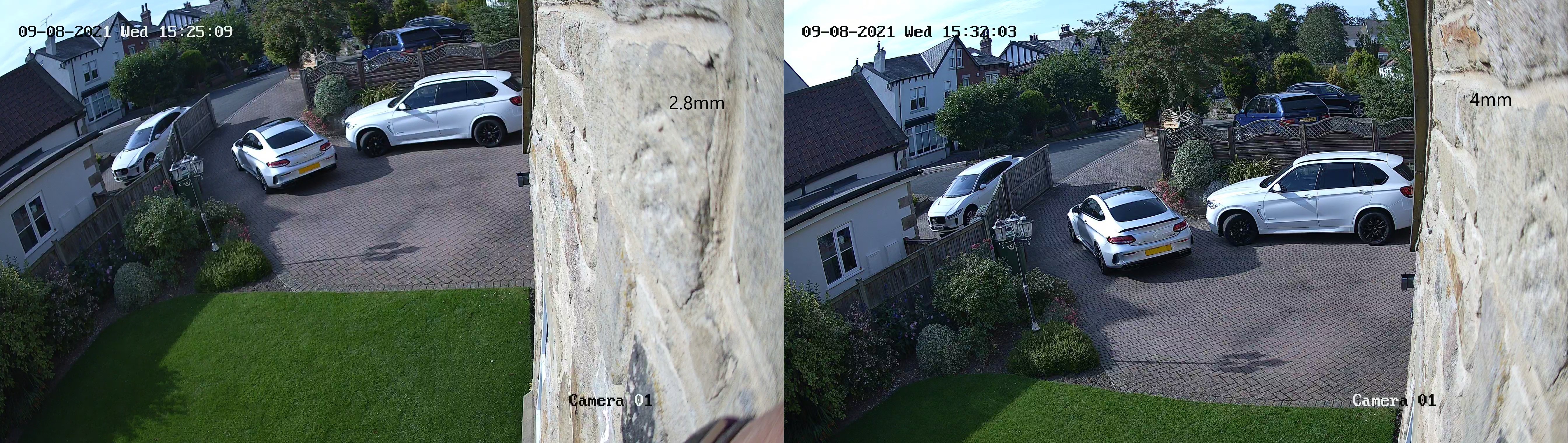

The following images were captured at points A, B, C and X using both 2.8mm and 4mm cameras:
A (highest point at the right of the house):
The 2.8mm lens (on the left) seems to show a lot more stonework than the 4mm, which is not ideal. Obviously the camera position could be turned to the left, but this would then simply include more of the neighbours house, which is unnecessary. The vertical position is not exact as each camera was held in position (by my wife), so the 4mm if pointed down would capture more of our property then the distance.
Both cameras at this height and position seem to include a lot of the neighbours gardens/house and the street, so I thought I would try lowering the camera to position B:

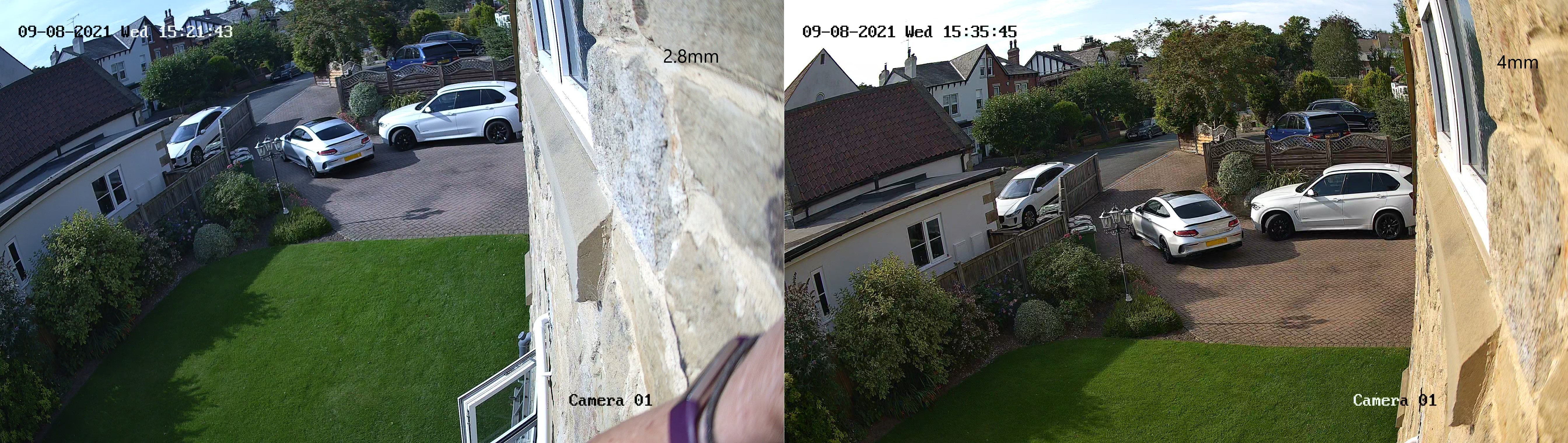

B
A slightly lower position at 3.5m, possibly better than A at 3.9m? Not really much difference.

My thoughts are the 4mm camera should be fixed at position A and then optionally, the 2.8mm at position X. This is the opposite to my original plan.
It's interesting that the 4mm camera seems to give a much warmer image than the 2.8mm in all the images. Not sure why this would be!
