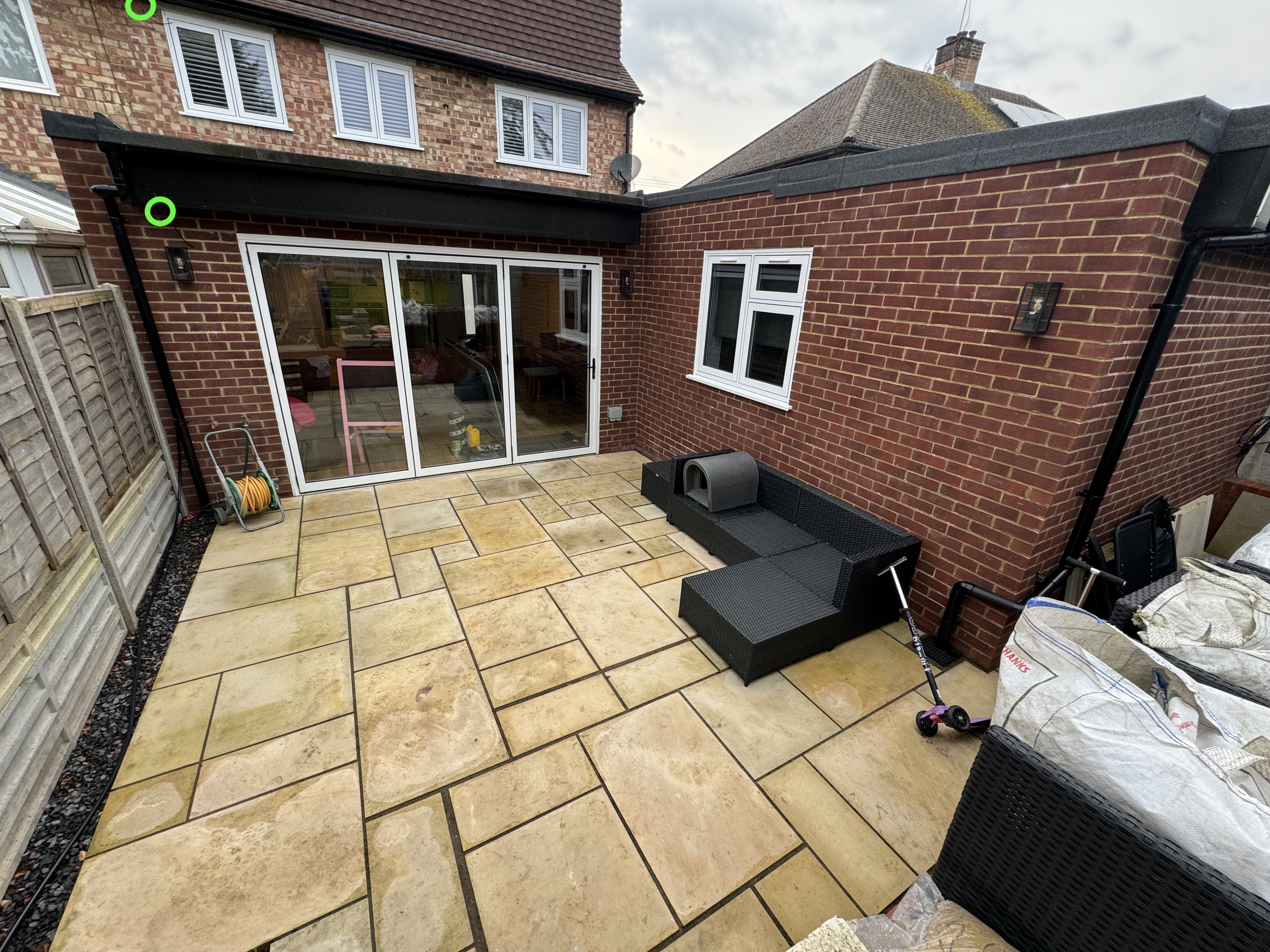

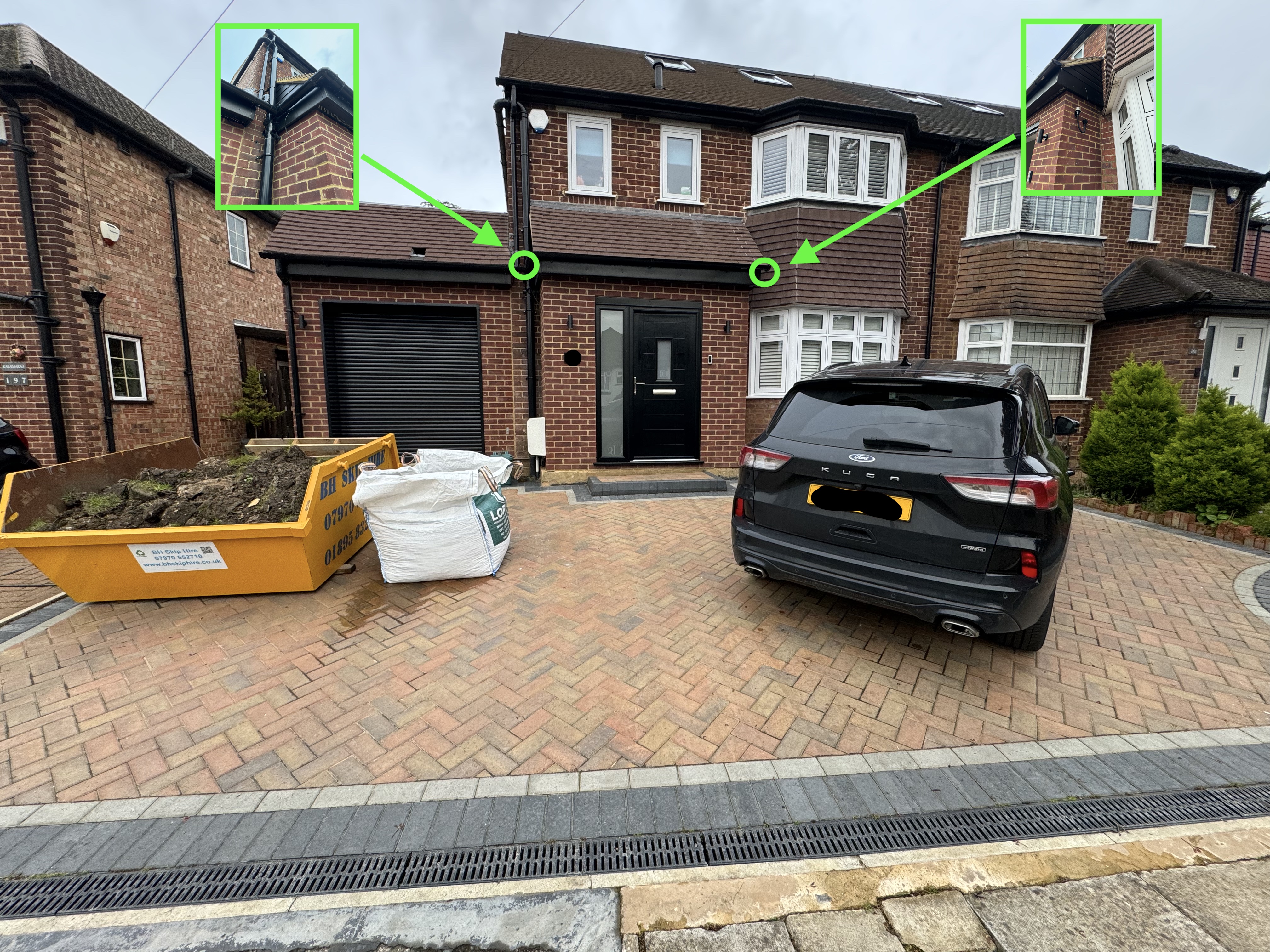

I've attached a couple of pictures showing where the wires are exposed from my property.
At the front of the house there are 2 locations either side of a protruding porch, I want to be able to cover as much as the drive as possible, drive is about 5 meters between house and pavement.
At the rear I just want to cover the patio area which is around 4m x 4m. The location at the top is to cover the flat roof area which is approx 4m in depth and 6m wide.

At the front of the house, you have made things a little tricky by positioning the cameras back-to-back on either side of the porch. These positions will make it difficult to get full 180-degree coverage of the front of the property because even with the widest FoV there will still be a small area directly in front of the front door that won't be covered by either camera.
This shouldn't be a major issue though because the FoV of these cameras will cover the rest of the driveway so there wouldn't be any way to reach that small blindspot without crossing through the FoV of either camera.
In regards to the rear of the property, the 2.8mm model will give you full coverage of the small courtyard/patio including the area directly below the camera. With the camera above the flat roof, we would usually recommend a narrower FoV to cut the flat roof out of the FoV, but as you actually want to see the flat roof we would also recommend the wide 2.8mm lens here as well.
Hi Dan, thank you very much for your advice, much appreciated. Yeah in hindsight the 2 front camera placement was not a genius idea, I'd in mind that the doorbell would cover the front but trying Eufy and Ring, they don't quite live up to having a proper IP camera. I do have network behind the front door bell so potentially I could change my current door bell to maybe a Hikvision doorbell connected to the NVR but I'll worry about that later.

Yes, a Hikvision Doorbell would be a good idea to cover the blindspot in front of the door, if you were to connect a Hikvision Doorbell to a separate PoE Switch/Injector you would be able to use the doorbell/intercom function whilst also recording the doorbell camera's feed to the NVR like a 5th camera.
