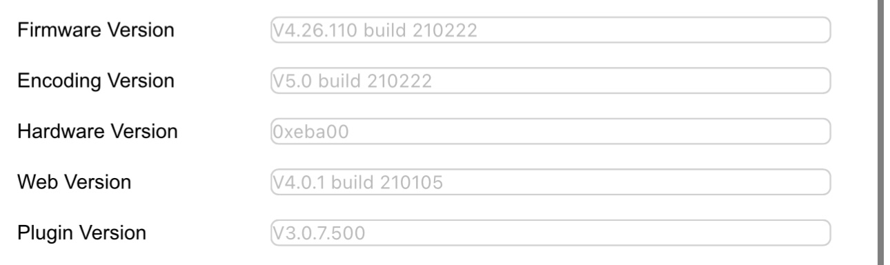

From the settings of your DVR post the full model number, firmware version and build date (do not post the serial number) and we should be able to see if an update is available that will bring your DVR up to date with the newer camera image format.
Latest version of firmware for your model is on the UK product page here:
You can download that file and update your recorder from the maintenance page.
It will bring your recorder up to date but may not solve the problem...HQHI-K series models are generally accepted to support 2MP (1080P) maximum resolution cameras (HUHI-K do up to 5MP, HTHI-K do up to 8MP). Your cameras have a selectable resolution - 2MP, 5MP, 3K20 and you've set the camera to a resolution higher than the recorder supports. You may have to access the camera and plug it directly into the recorder to switch the resolution using the button...
