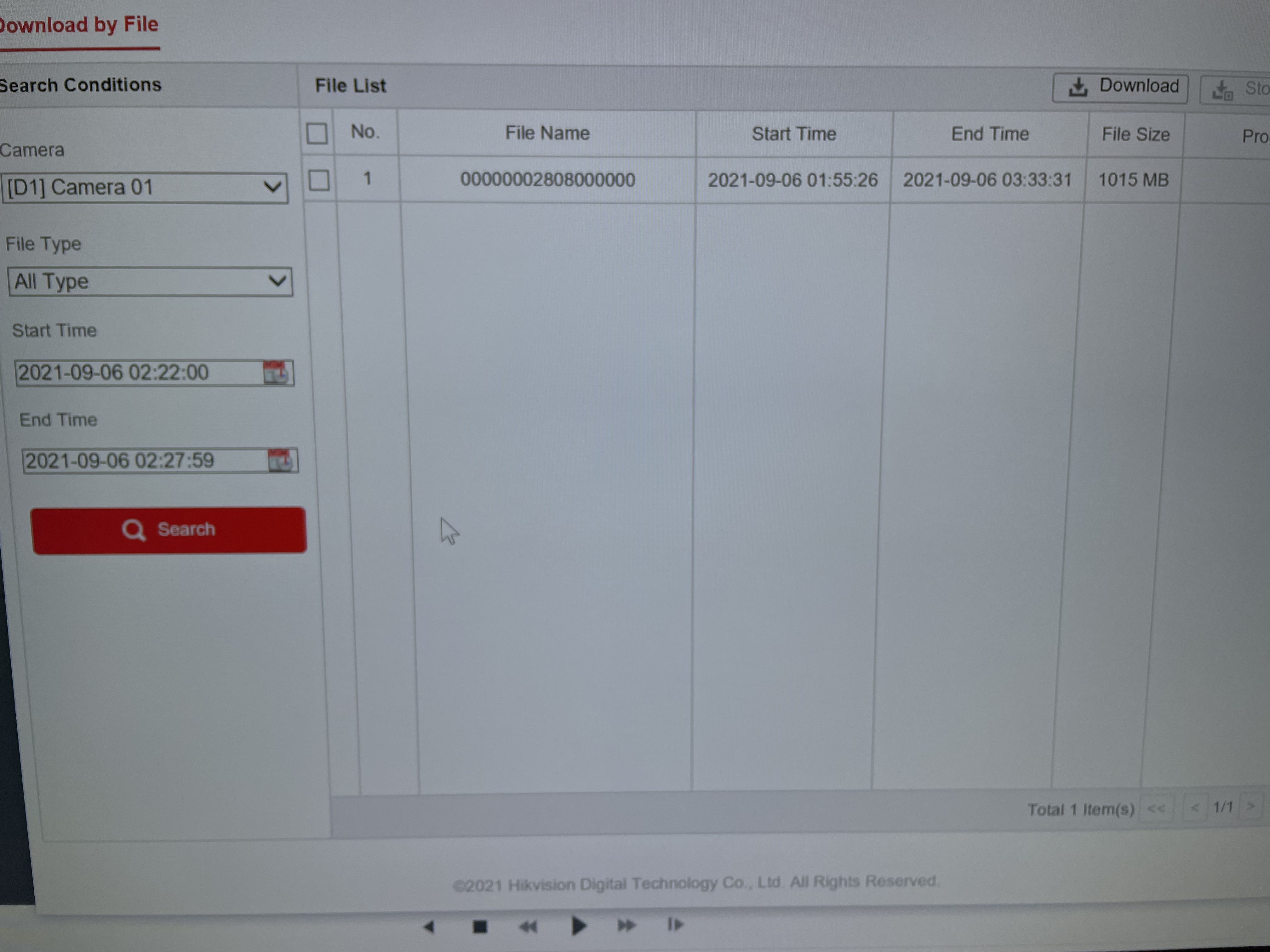

Here is a prime example…. We have 30 of these units out across the country , I’ve just dialled into a random unit and asked for 5 minutes of footage (see times on the left) it returns 01:55
that’s a blatant fault in the firmware! Also note that on this nvr the packet sizes etc are default
