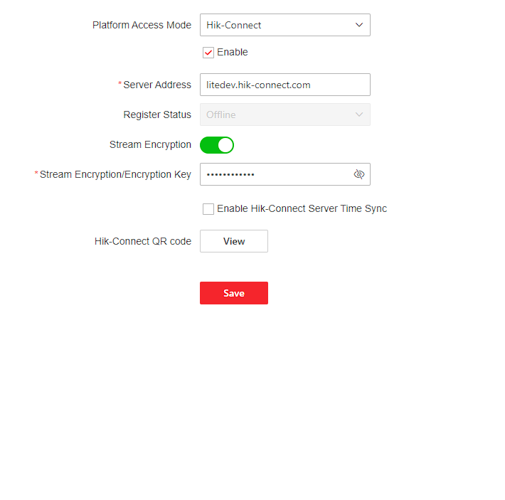

All my settings are correct but Hikconnect registration status is always Offline. I'm getting error code 'Registration status Offline(0xe0020008)
What's strange is my individual network cameras will connect to Hikconnect and shows registration online immediately just not the NVR. all the settings are the same (minus the IP address)

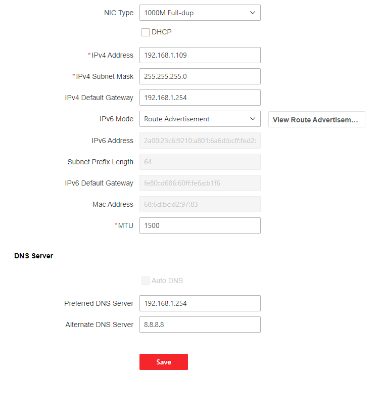

I've rolled back firmware and forward again, uninstalled hikconnect, registered a new account, checked all cables, factory defaulted my BT router and started from new, all required ports are forwarded, tried using DHCP, NVR in the routers DMZ zone, ive tried many DNS 8.8.8.8, 8.8.4.4, 1.1.1.1. I've made sure the encryption key matches, etc etc everything.

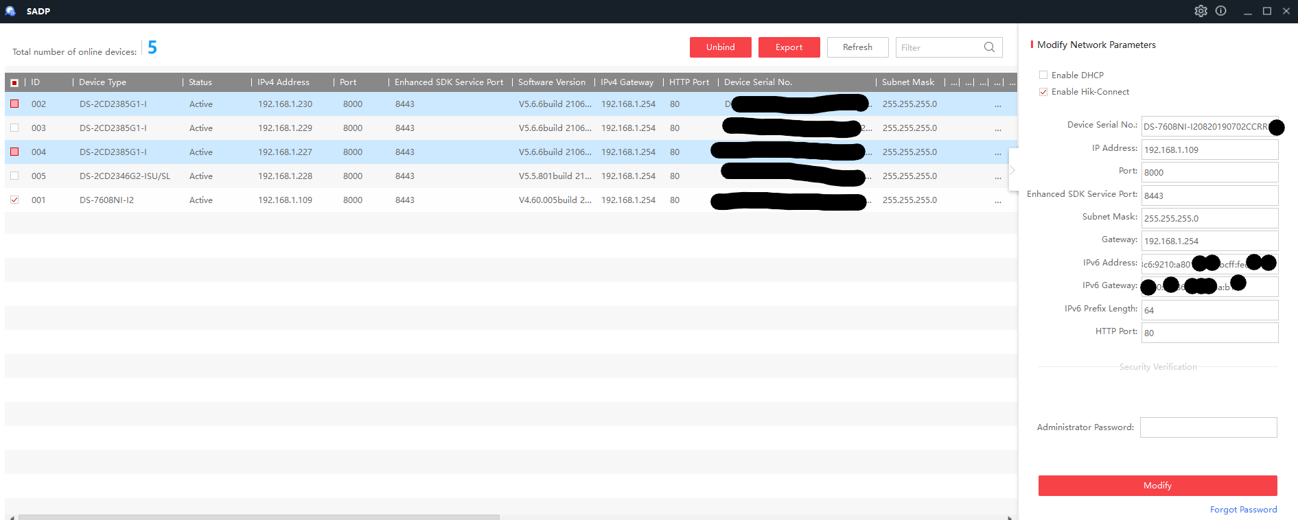

My nvr is not bound to another account(tried the unbind)

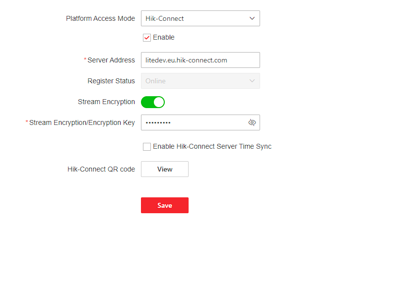

default - litedev.hik-connect.com
litedev.us.hik-connect.com
litedev.eu.hik-connect.com
dev.hik-connect.com
none of these ping either
