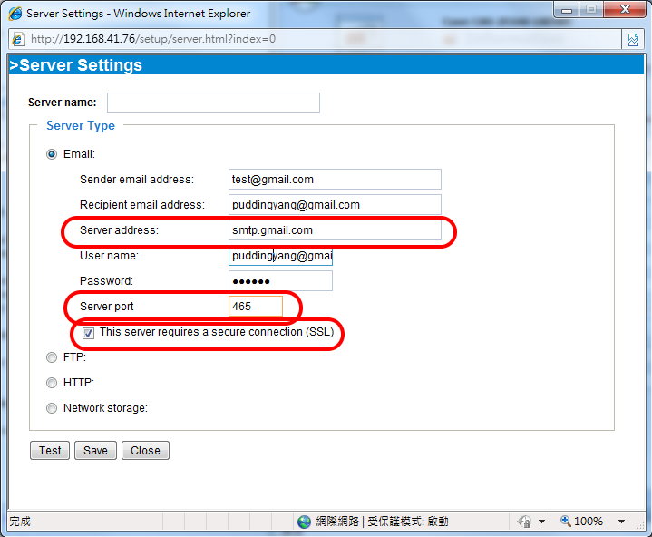

Phil Administrator Staff member Messages 5,133 Points 113 Jul 4, 2011 #1 Can I use a Gmail account to send emails from my Vivotek IP camera? Click to expand... Yep! Please see the attached screenshot. Server address: smtp.gmail.com Server port: 465 [Enable] This server requires a secure connection (SSL) Click the "Test" button to confirm the result.
