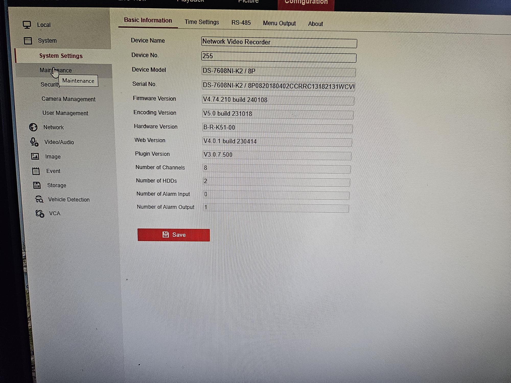

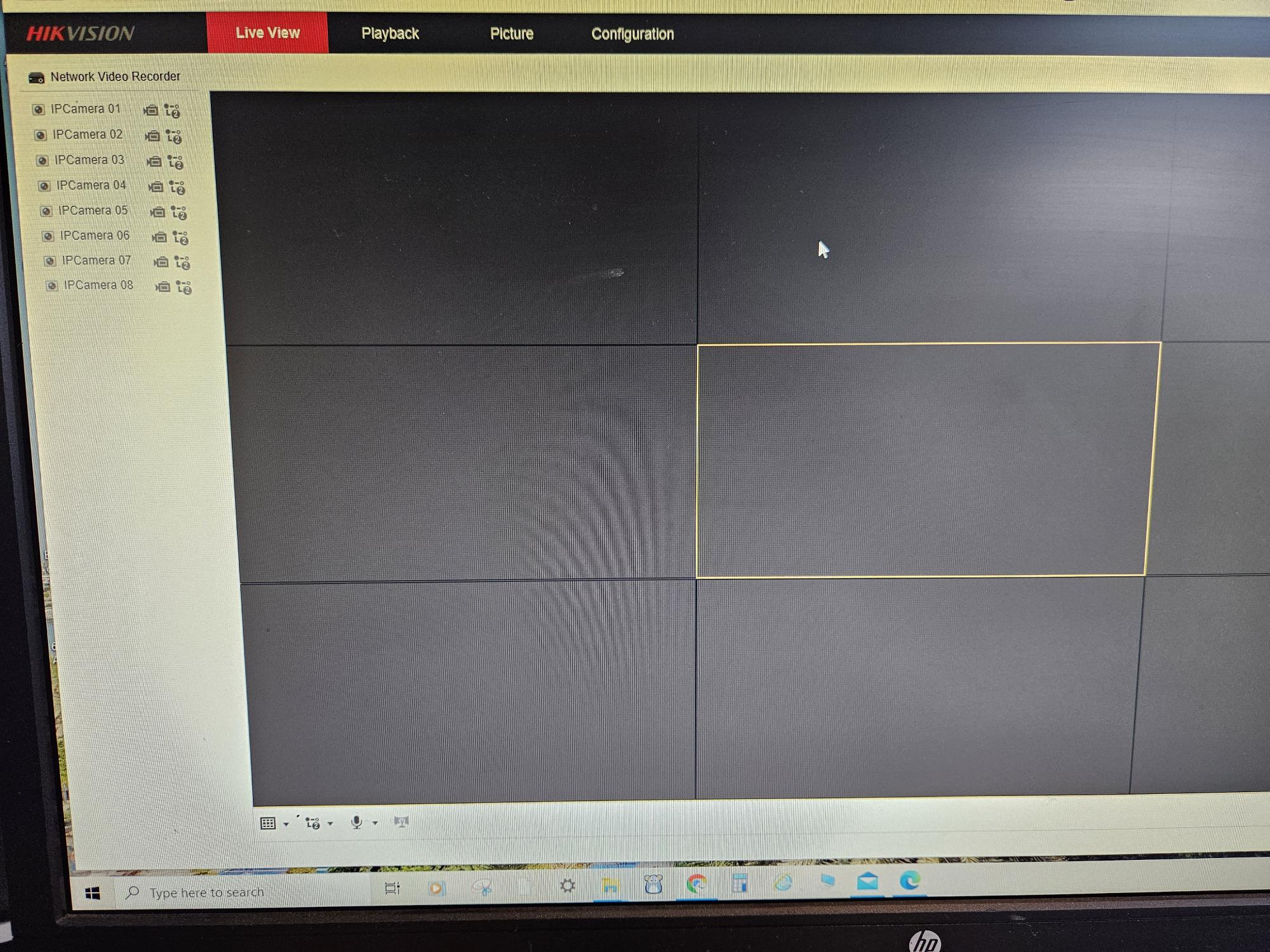

I wonder if you can help. Everything has been working fine with my system until i upgraded my hikvision nvr to the latest firmware today. I've attached a screenshot of my hardware and the firmware details together with a view of the what i see when i Live View.

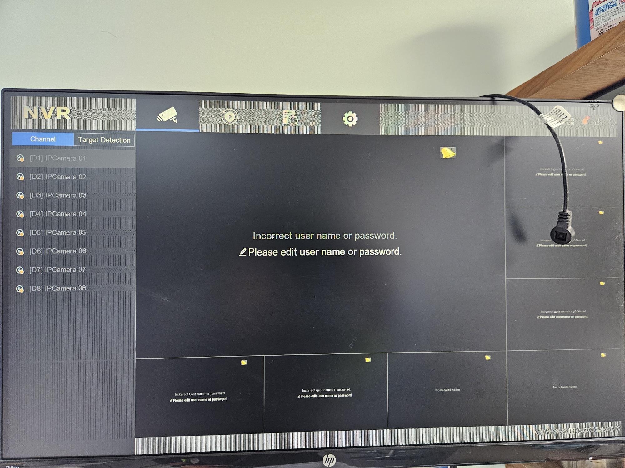

I suspect the problem is something to do with an incorrect username or password as per the error message (attached). This monitor is connected to the nvr via hdmi. This monitor is used to view the cameras from the nvr, however can't seem to understand why it says incorrect username or password when i have logged in via a browser but just cant see any of the cameras.
Please advise.
I have reverted back to the previous firmware but that didn't work so I have gone back to the latest to help troubleshoot.

The firmware I was using was the previous one to the latest one, the 914. see attached.

I've attached pictures of the what the IP channel is showing. The cameras appear offline, and when i click on the individual IP address url's for the cameras i get a unable to reach host.
I think you maybe right about the camera upgrades part but i think right now we need to get past the authentication part where its not recognising a username or password (which may be related to the camera upgrade you are referring too).

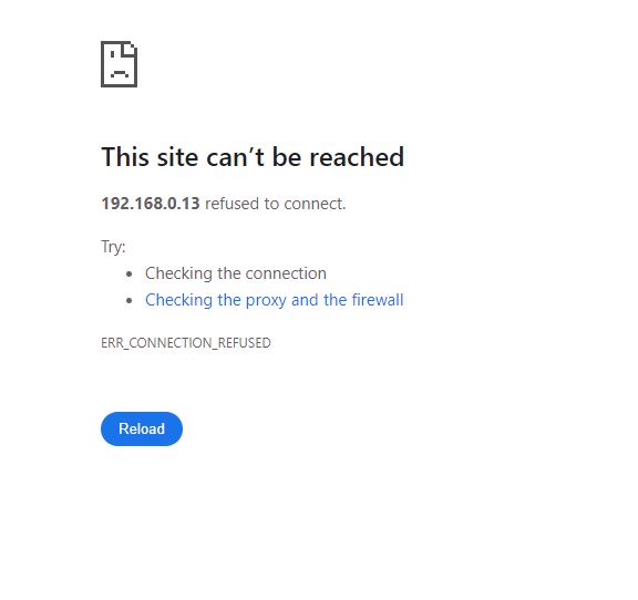

just to update Dan. I've managed to reset all the cameras bar one which at the roof of the house so would need a ladder manually reset at the camera like ive done with the rest.

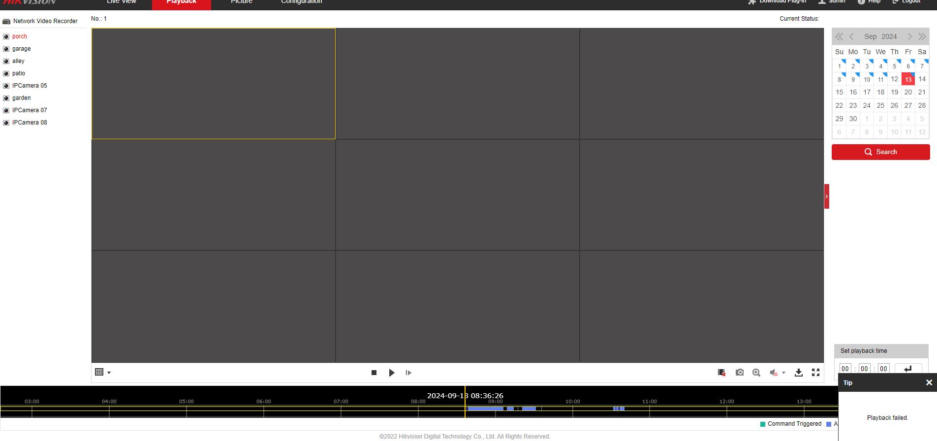

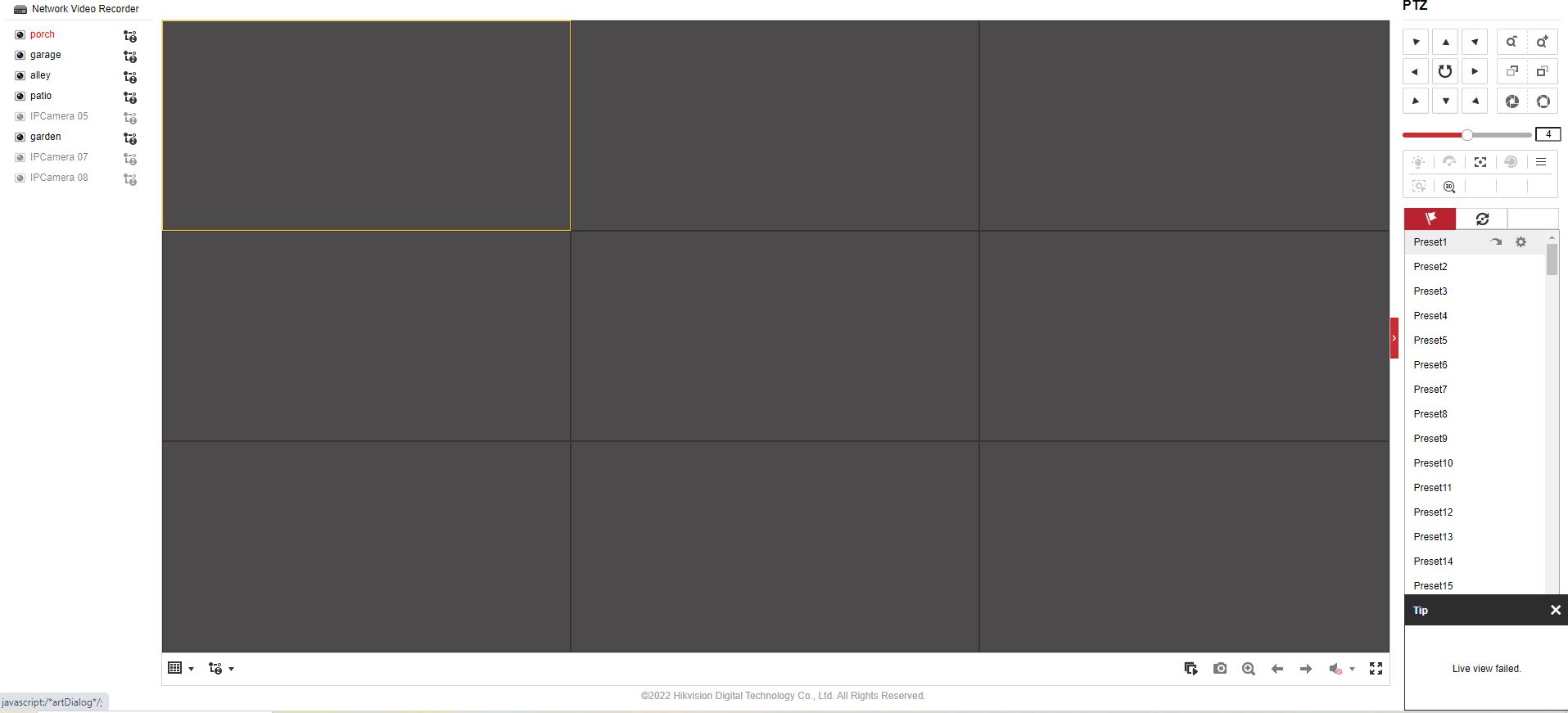

I can see connect directly to the NVR and get view of the cameras however using the ip/browser I get a Live Failed error. It did work briefly today but for some reason its now not working.
Please advise what could be the problem or how I should resolve this part.
Once this is resolved I will need to the the hik connect working again on my mobile phone to be able to view and then i am back to where i was before the firmware upgrade which may have caused these quirks.
I'm using Chrome and have also tried in edge. no other errors received

ignore the above i've installed the plug in, refreshed page and its now working. brilliant....ticking each issue off. Now for the hik-connect. Any advise you can provide please message back to get this working again. I'll also see what articles are on the forum to assist me
