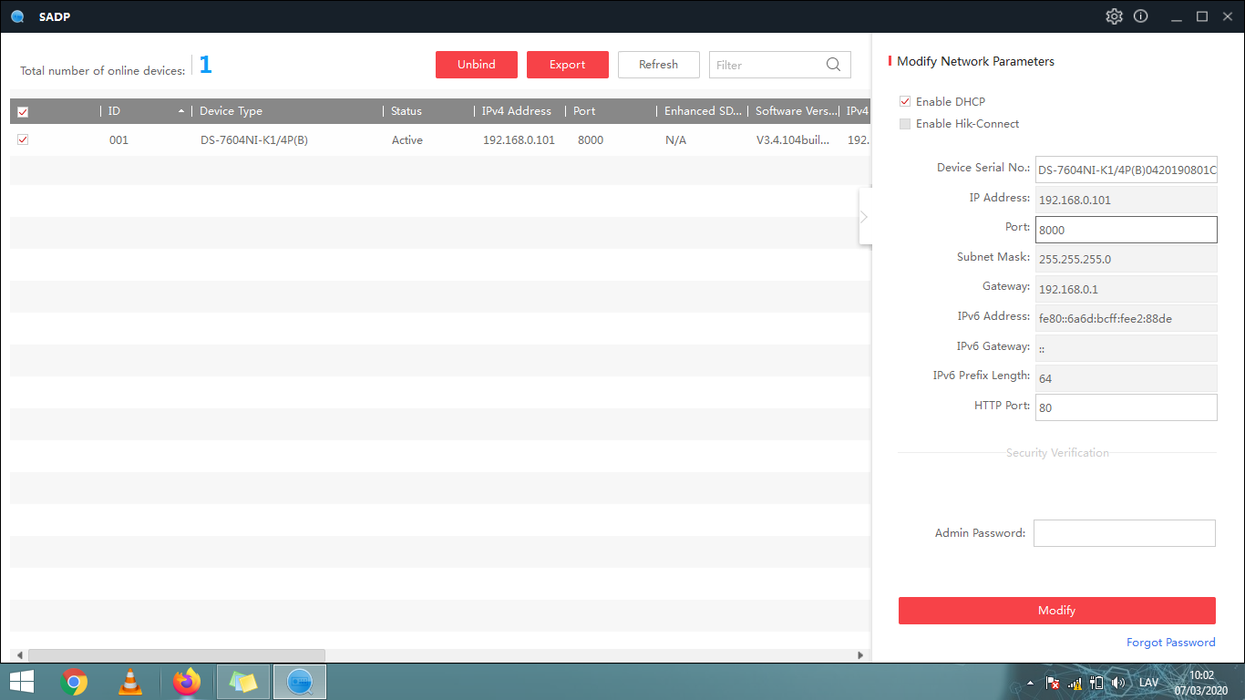

I have a similar problem. I am trying to access my IP camera GUI through web browser yet no success.

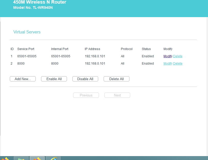

Virtual Host function is enabled, ports are also open. I can access my NVR via web browser, no issues with that but when i am trying to connect directly to my IP camera nothing happens ( just browser timeout). Router is just out of the box, not tied to any of internet providers and managing only this NVR & connected PC.

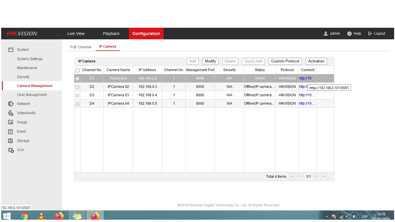

Your cameras have LAN IP addresses, as if they have been connected to your network before being plugged into your NVR's camera ports.
Also, they are showing as offline.
Try using the physical reset button on one of the cameras.
Hopefully, the camera will reset and pick-up an IP address from the NVR.
Thank you, I am a little bit confused about you said "have been connected to network before plugged into NVR"
If you take a closer look, the 1st one is Online and operating. NVR can access the camera and i can have a Live view through NVR's GUI directly to it - no issues with that.
What i understand is - NVR is acting as a router by itself because the DCHP is enabled. So it wants me to connect to camera No.1 through port - like -
192.168.0.101 (wich is NVR in network) but Cam No.1 is -
192.168.0.101:65001

I'm guessing if you had the camera directly plugged into the NVR Camera 1 PoE port, that you must have activated and programmed it BEFORE plugging its into the NVR - this was unnecessary.
The cameras LAN connection (192.168.0.101) is separated from the NVR's camera network which is addressed 192.168.254.1 by default (the NVR is accessible at that address if you connect a PC to a spare camera port) Connecting an unactivated camera to one of the ports will allow the NVR to allocate an address (using plug and play) in the 192.168.254.xxx range - camera 1 would become 192.168.254.2, camera 2 would be 192.168.254.3 and so on (these may become out of sequence as cameras are added removed, swapped around but it doesn't matter). At that point, with virtual host enabled in the NVR, navigating to 192.168.0.101:65001 would connect you to the camera plugged into camera 1 port of the NVR - 192.168.254.2 (or whatever address the NVR had allocated) Note that without additional configuration, you would only be able to connect to the cameras web page using virtual host from a computer on your local network (192.168.0.xxx)
You are experiencing problems because you have a camera connected to the NVR PoE port with an address on the same subnet as the NVR LAN port. You would only set the camera to the same 192.168.0.xxx network if you are connecting it on your LAN, to your router for example, NOT to the NVR port.
Your easiest option would be to press the reset button on the camera while powering it up. This will return it to it's deactivated status. Then connect it again (without programming anything) to camera 1 on the NVR. If you've not edited Camera 1 in the camera menu of the NVR, the Plug and Play mechanism will activate the camera and you'll be up and running.
The best thing to do now is to reset everything, including the NVR, back to defaults and start again.
