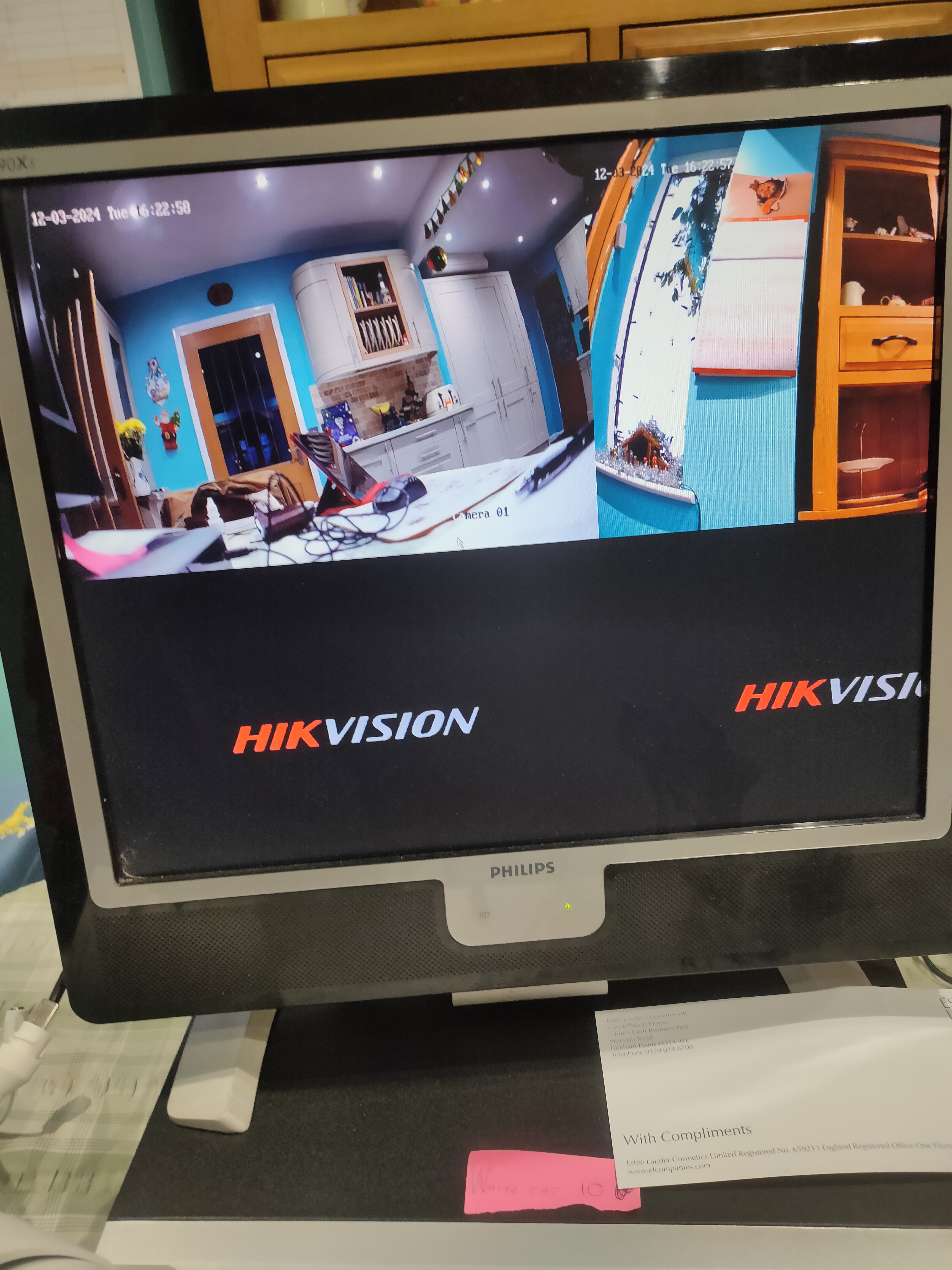

Hi.
I have been setting up my new 7600 M series NVR on the bench prior to nailing it all down. After a few days toil I had everything up and running as it should.
The NVR botted and worked OK. I had connectivity on my PC (Via IVMS4200) and the android app worked fine. Sooo I retired for the day happy that I had "cracked it".
Today I rebooted the NVR. I immediately noticed that the normal boot screen ( Some kind of CPU with AI written on it) was absent. The NVR booted up eventually and the 2 remaining cameras I had connected worked fine.
BUT! I now cannot access any of the NVR GUI options ( usually accessed by right clicking on the homepage ) ???..
I cannot access and of the system settings! I can still view the cameras via the app and on the PC. I have no access to the system settings on the NVR from the PC however. The NVR just sits there showing my the 2 camera streams. How on earth do I reset the thing or preferably, how do I gain access to the NVR GUI again ????????
Ps Its as if I had the monitor plugged into the HDMI port for viewing, only I dont!
ALL help gratefully received!

EDIT!!!!!!!!!
This MAY help some of you..... I Had plugged my tablet into the USB at the rear of the NVR as the battery on the tablet was going flat. I suddenly thought... "I wonder"...... I unplugged the NVR and hey presto, all is well again! So... DONT PLUG ANYTHING OTHER THAN A MOUSE INTO THE NVR! :)
