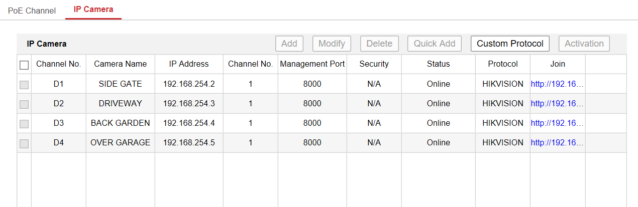

I need to set min/max object size but it's not available in the NVR so have to access the cameras directly. I've read the forums and done a bunch of trial and error but have got no where. Any help would be much appreciated.
Issue: NVR loads fine but loading the camera in my web browser by these ports just gets 'cant reach page' error . I.e. http://192.168.1.168:65001/
Model: DS-7604NI-K1 / 4P
Virtual Host: I've enabled Virtual Host in the NVR and have attempted to access the cams using the provided web addresses. Image attached.
Nmap: I did an nmap scan and it shows the following: '65001/tcp filtered unknown'.
Firewalls: I've tried fully disabling both my router and windows firewalls.
Router: Both the NVR and my computer is connected to the same domestic Plusnet router via ethernet.

Please can you tell me a way to connect to these cams?

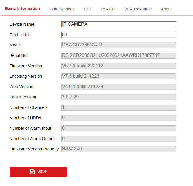

Can you access the NVR with a direct HDMI/VGA monitor?
What camera models do you have connected to the NVR?
Attached the cam model.
I was able to get in using the original password set by the engineer when he installed the system.
Thing is, I changed the NVR pass once I took ownership so it's odd that the cams never got that update and still using the old pass.
If need be, I can continue using the old pass for the cams. But any idea how to sync the pass? Now that I have cam access, is it a case of going to User Management and updating the 'admin' pass for each camera to the same as the NVR?
