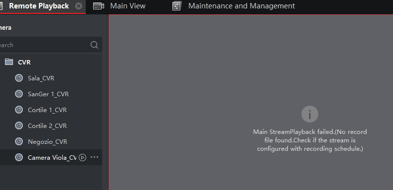

BUT I cannot do any remote Playback on iVMS4200. When I select any of the cameras I get the following: "Main stream playback failed. No record file found."

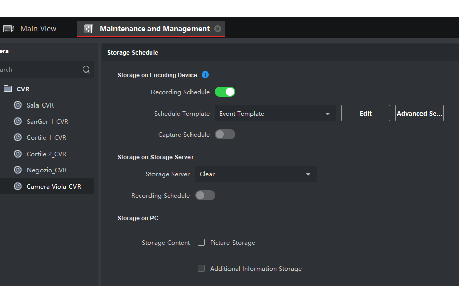

In the Storage Schedule page I am not able to set the Storage Server: in the selection list there is only "Clear"...

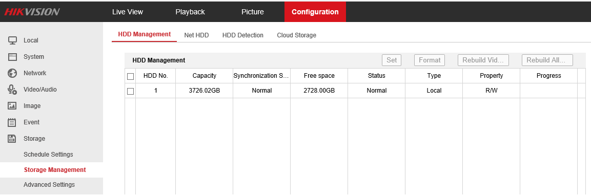

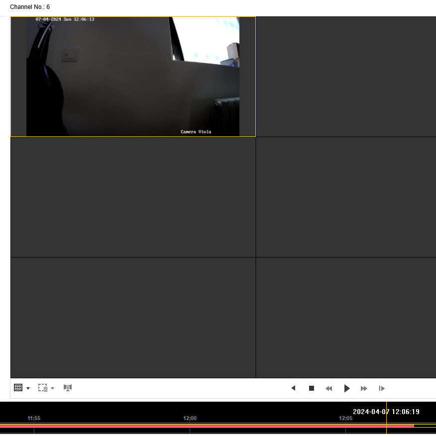

I have mounted a SD card on one camera and set up to record also on it (Storage Schedule).

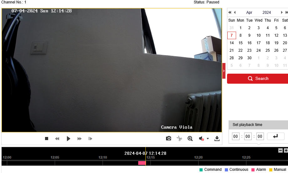

Now I have 2 footages of the same event, one on the HDD (that I can sse from the NVR webpage-->Playback) and one on the SD card (that I can see from the camera webpage-->Playback).
Unluckily, still I cannot see the footage through the iVMS, Remote Playback.

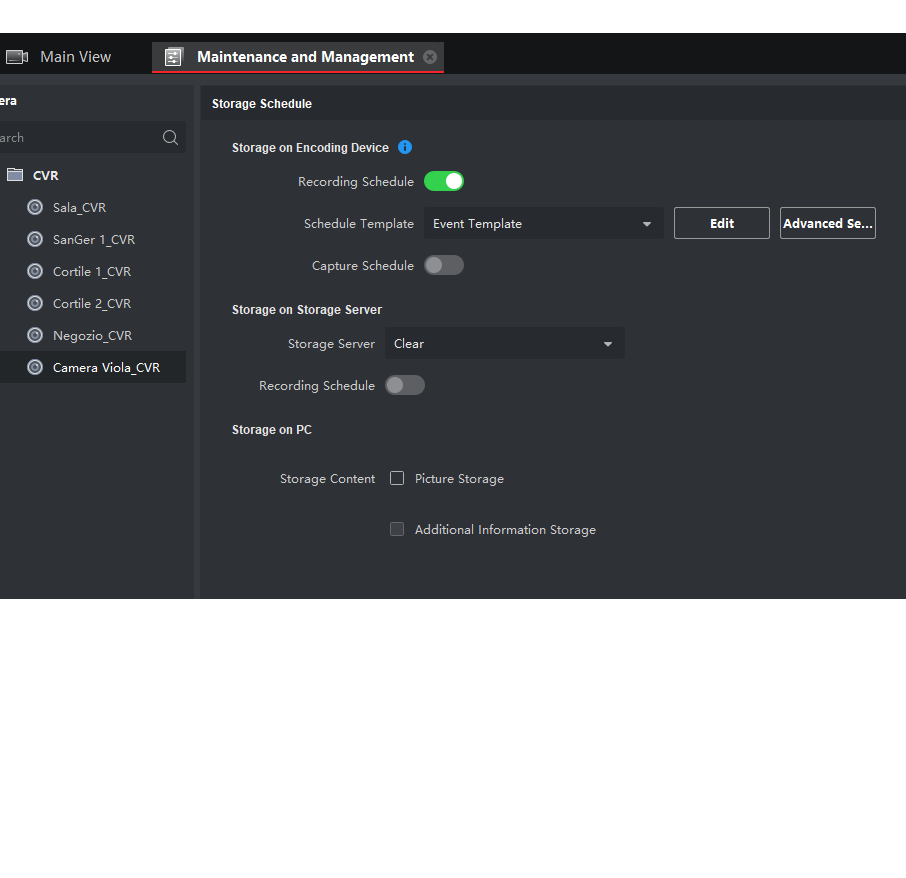

What I find strange is that in the iVMS, Storage Schedule config page I cannot define the Storage Server, and thus the Recording Schedule:
While in the NVR webpage everything appears properly configured:
Any help is highly appreciated.
Ugo

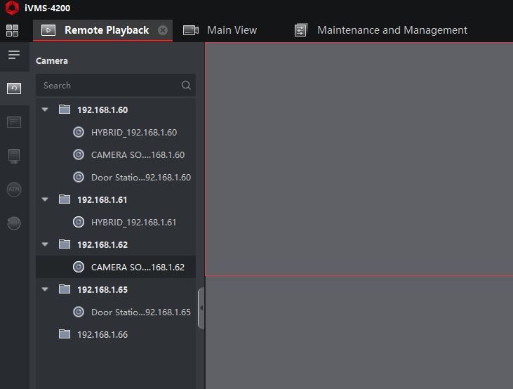

Hi @Ugo

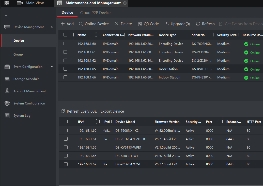

If you want see the footage from each camera, you must also add each camera separately with its own IP address, same way you added the NVR . You have added only the NVR.
About Storage schedule I cannot help you because I have never used this on iVMS. But I suppose you need a Network Server or Network HDD so that this could be recognized by iVMS. You cannot do this with your PC HDD or NVR HDD

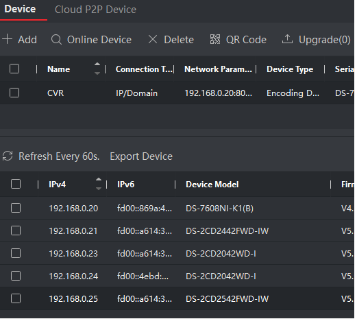

Hi alfaclvi,
problem solved :) .
I had to wait some time till the DB with footage was rebuilt completely and now I can see all the recordings from iVMS.
BTW, I did not need to add every camera, but just the NVR, as that is identified as the econding device doing the dirty job (recording), while cameras are just handling the image and event recognition.
It works like a charm, now! Thanks for all of your support.
