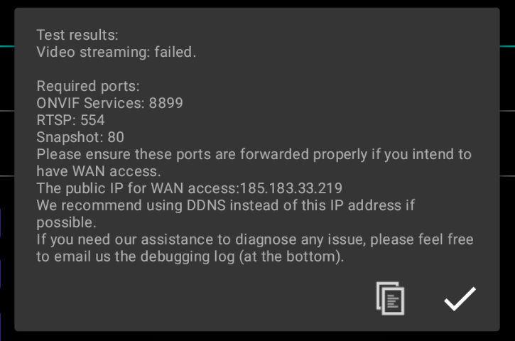

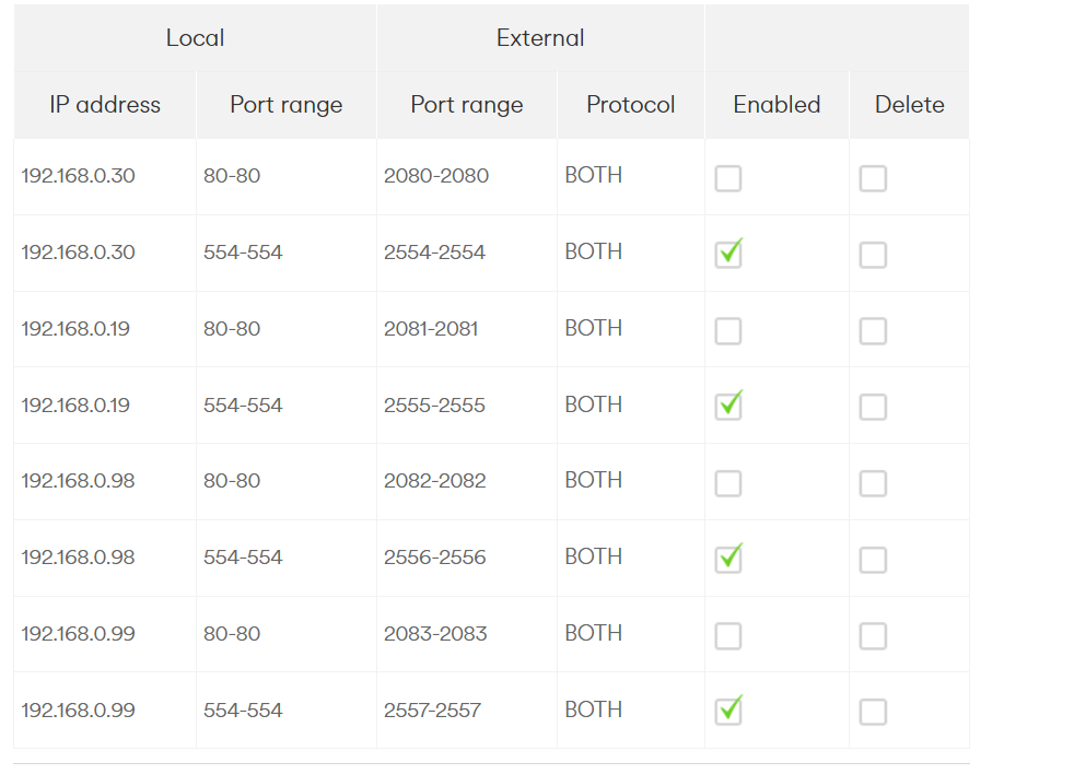

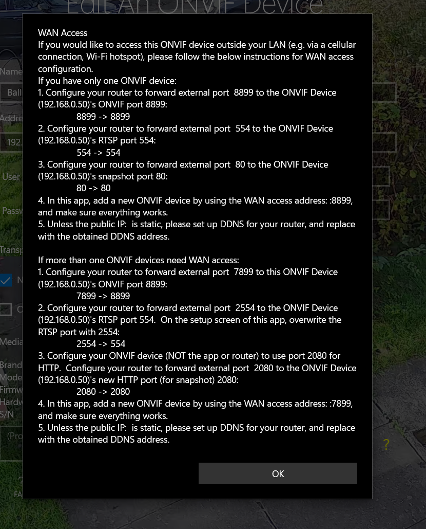

I wonder if you can help at all, I have set up 3 cameras fine using NO-IP and there working great on WAN, now I have two other cameras that I just can't get working, they work fine on LAN, the ones with the green ticks work great, I've tried all sorts to get the new camera working, (see screen shot attached)

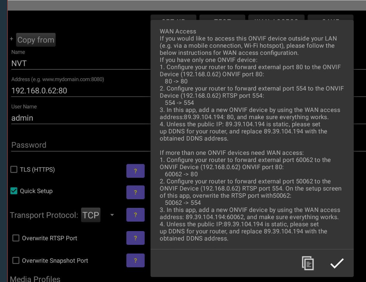

It's IP address is 192.168.0.50 - what should I be putting in for the ports?

When I set it up via IP CENTCOM and go to the WAN it suggests the following, but port 2554 is already in use for one of the cameras, IP Address 192.168.0.30

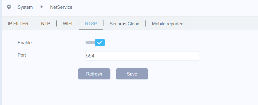

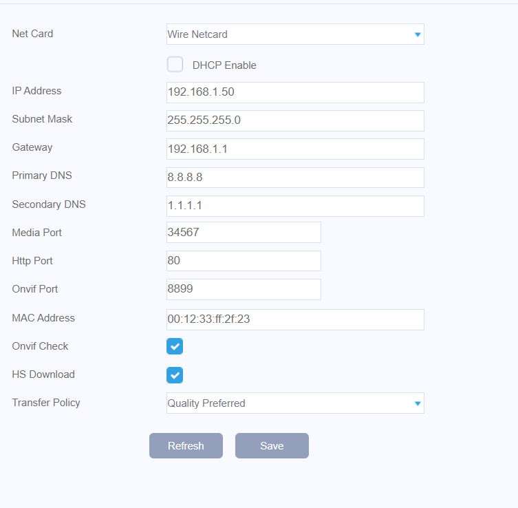

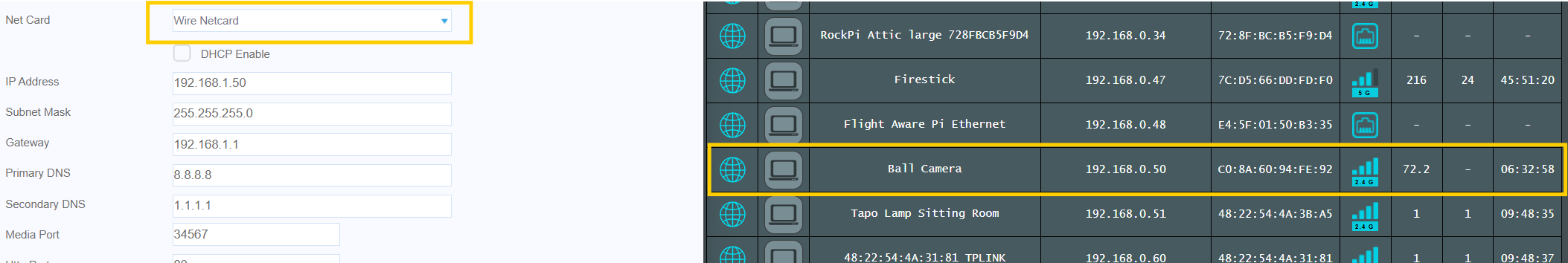

Ah man! Well spotted and this cheap o Chinese camera doesn't have a GUI page for the WIFI side of things :(

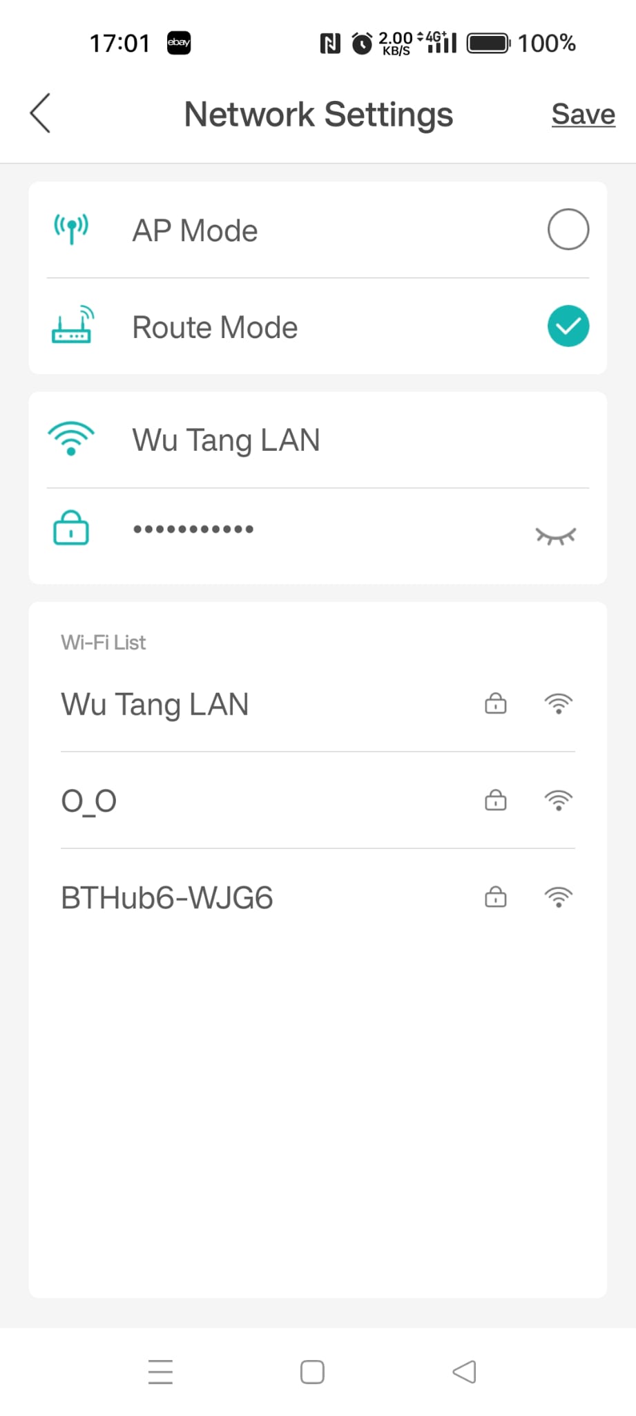

You can use the drop down menu but there's only the network connection, I use the icSee app to connect it to my WIFI.
I mean it's connected but no where to see any settings other than the router your connected to wirelessly
I might just use the rtsp stream rather than mess on with it, rtsp://yournamehere.hopto.org:555/channel=0_stream=0&onvif=0.sdp?real_stream
I just forwarded 555 external to the ip address on my router to 554
