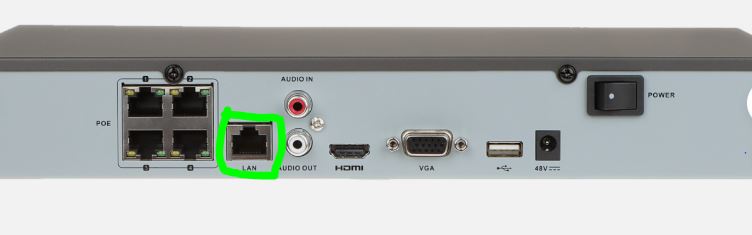

Even though the NVR has four PoE ports on the back, I don't use them. Instead, I connect the main ethernet port on the back the NVR directly to one of the non PoE port on the site's 8 port TP Link Gigabit EasySmart switch (it has 4 normal and 4 PoE ports). I needed a PoE port for a TP-Link EAP 225 WiFi access point and that needed to be on the main network.

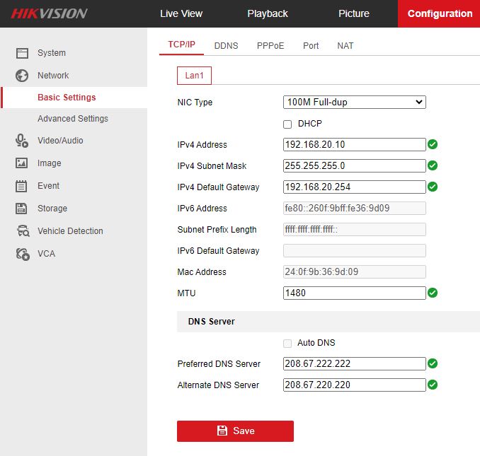

I then configure the NVR with a static IP address in the same range (technically on the same subnet) as that used by the router. You can use DHCP just as well, I just prefer to have my CCTV stuff on fixed IPs.
This is from my DS-7604NI-K1/4P:
I never use "standard default" home type IP addresses as you can see LOL.
Nothing wrong with them though so for yours instead of 192.168.20.10 you would put in 192.168.1.170 (if you want to use .170 for the NVR) or simply leave DHCP ticked.
If you are going to use static (fixed) IP addresses, ideally you should modify the DHCP range (or pool) so that your static addresses are "outside" of that. So for yours you would want to set the router to issues DHCP addresses 192.168.1.2 - 192.168.1.169. Sometimes this appears in the router as a start address and a "range". So for the same thing you would use start address of 192.168.1.2 and a range of 167 (169-2).

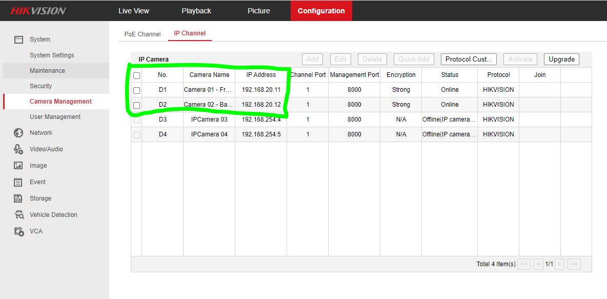

Then add the cameras manually under IP channel:
