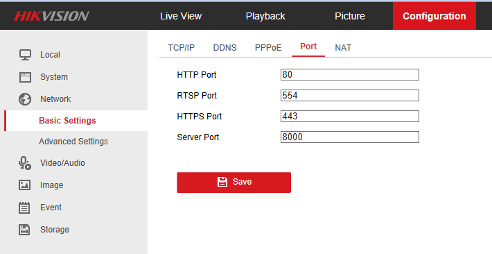

Clutching at straws, did you perhaps change the http port?
If so, you'd need to append the port you set after the IP address e.g. 192.168.1.12:8080 (or whatever you set it to)
Genius, it was set to port 81, Thanks for your help. IVMS showed the correct port, but SADP showed it as 0.

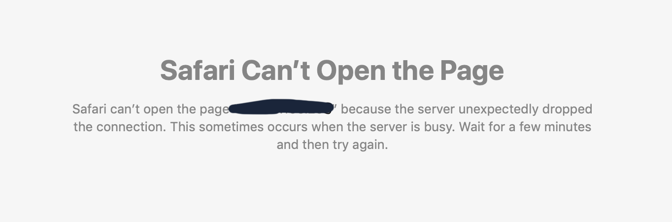

Hi, I need to get onto my NVR as viewing playback on my ipad don't work (another problem) anyway I can log into the first page of Hikconnect, but when I'm on the Device Management page and then click my NRV IP/Port No I get a messages saying about the server dropped connection. Now what does that even mean, is it my NVR, Boardband or Hikvisions site?
