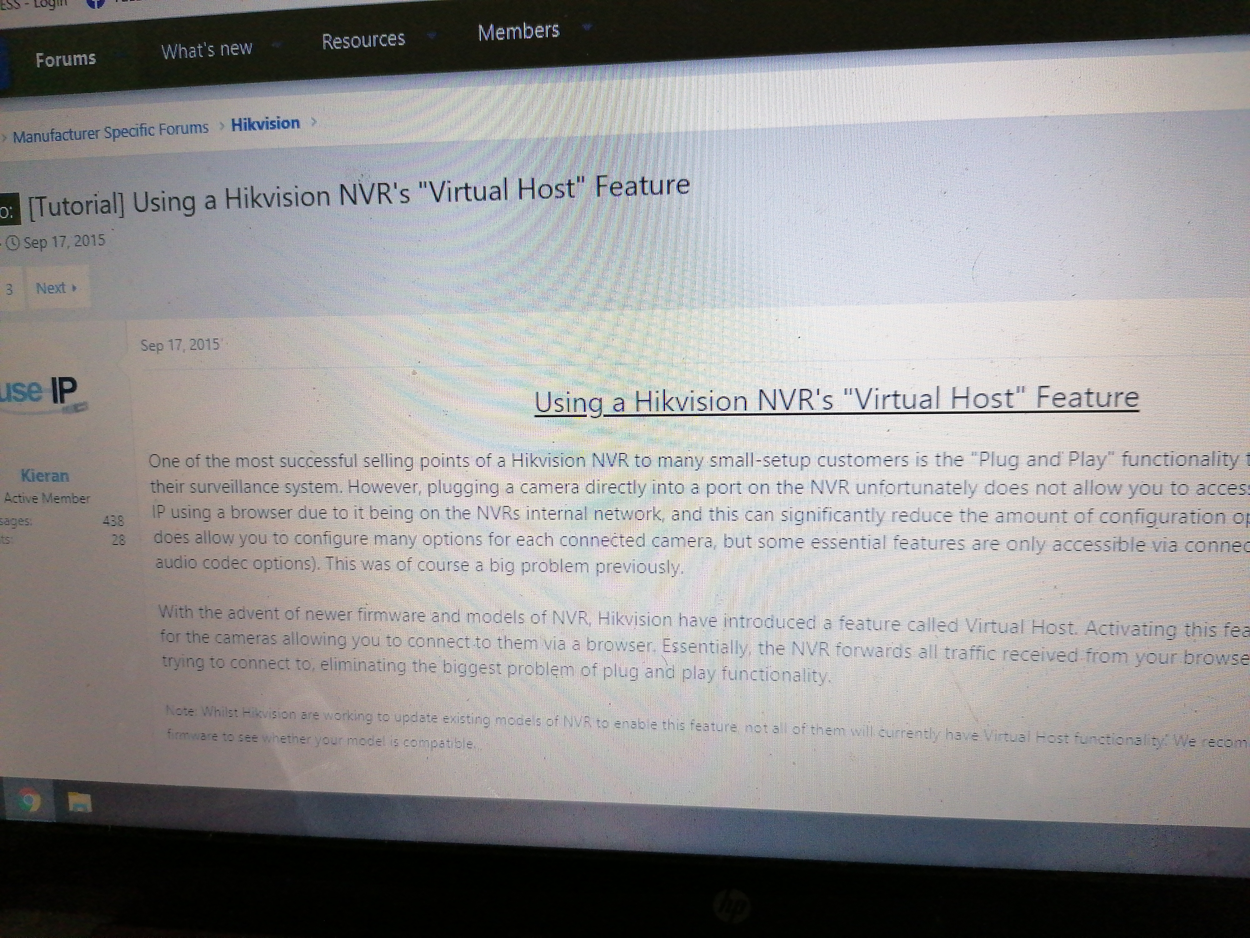

How do I log into the camera is it in the dvr or do I go I though another way cheersHi @Jaso912
Check the steps in the below forum thread
How-to: - How To Set Up Live View & Playback Audio on Hikvision Cameras
There is a small selection of Hikvision cameras that support some sort of audio - audio I/O, built-in mic, 2-way audio - but on multiple occasions, customers have come back to us saying they are getting no audio on live view or playback. So to avoid this problem in the future we are creating...www.use-ip.co.uk

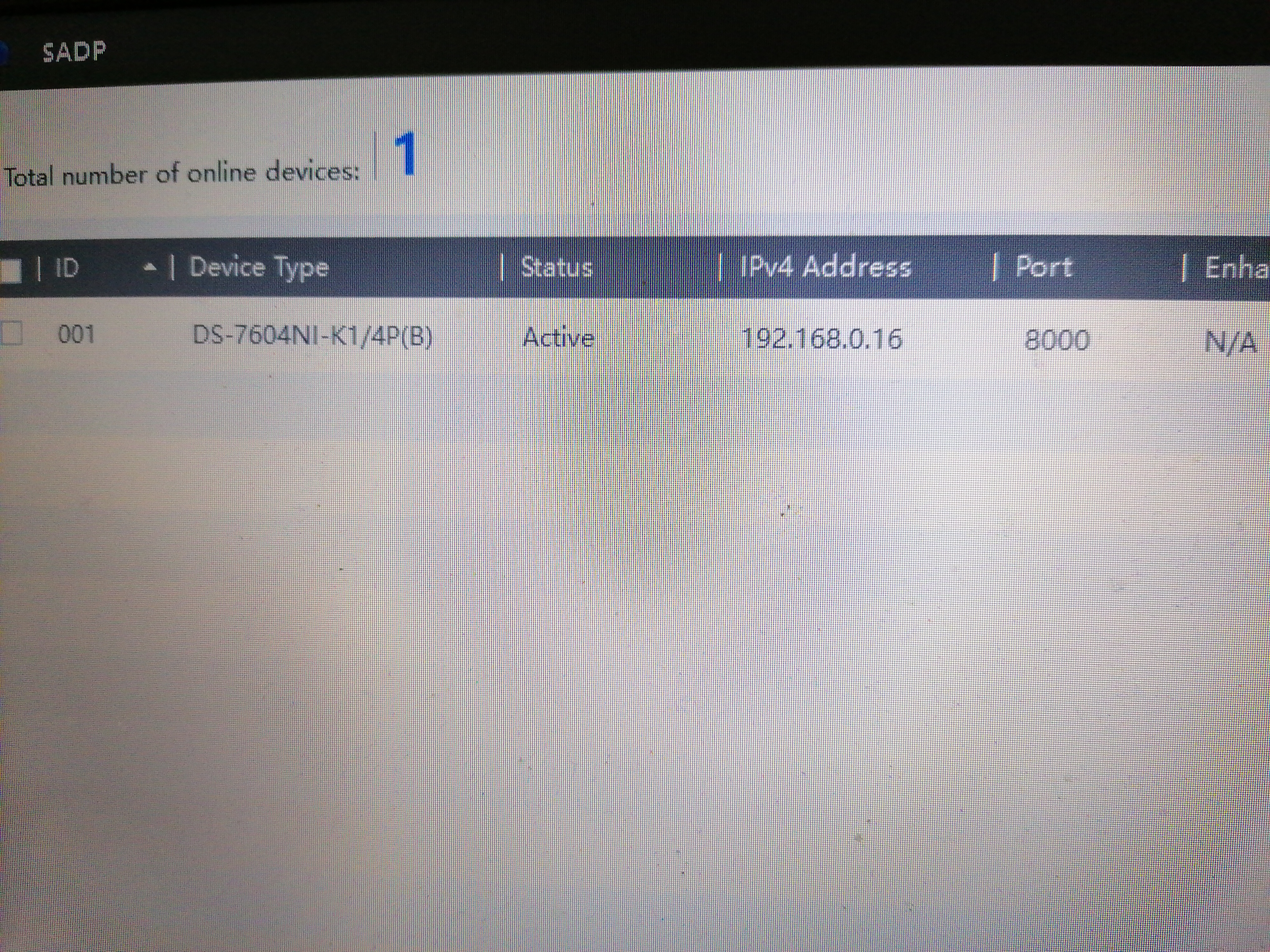

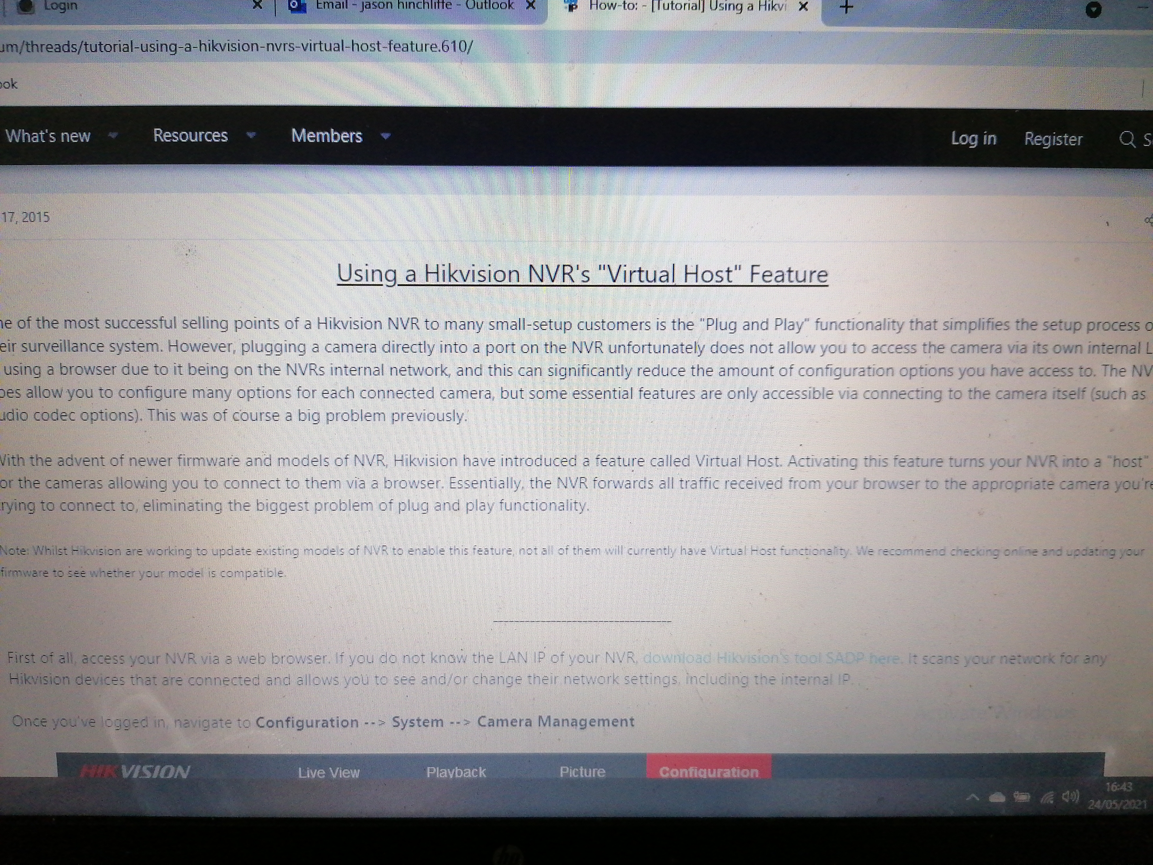

It's asking for a user name and password where is thisOk, you can access directly connected cameras on that NVR by enabling Virtual Host which creates a link to login directly to each camera.
If the camera was activated out of the box by directly connecting it to the NVR then it should be using the same password as the NVR.

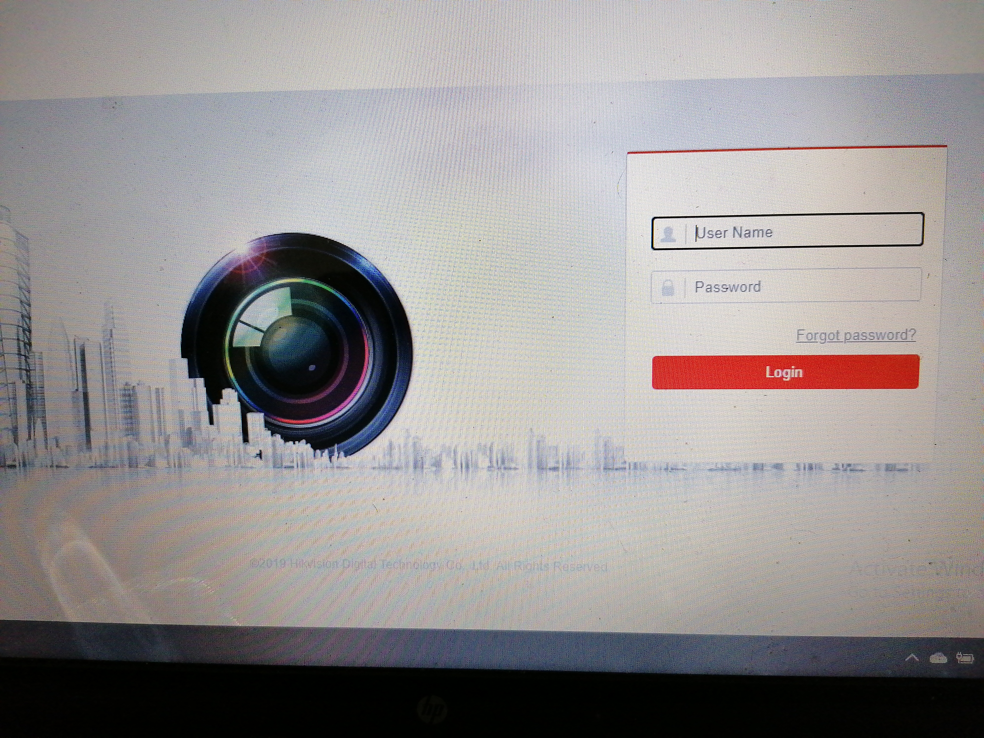

Just takes me to hereSorry, what do you mean "It's not creating a log in"?
Do you mean it is not accepting the password?
Can you share a screenshot of the login page that the virtual host link takes you to, including the address bar with the cameras IP address?
