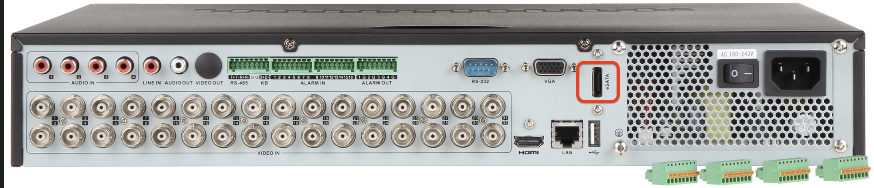

Is this the back of your DVR? if the eSATA socket is not there the DVR must be an earlier hardware release.
