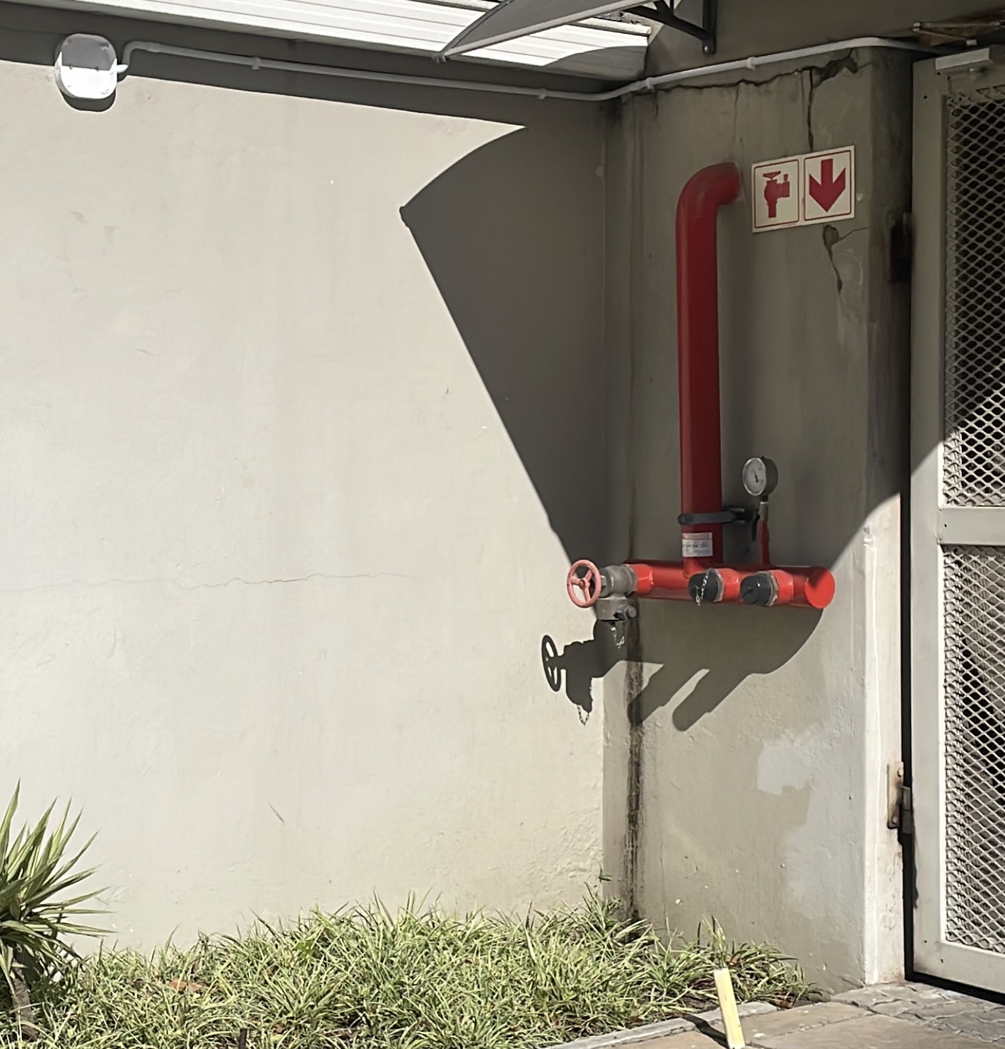

Even this mount, is too high, I should have dropped it by 30cm to be head of human height.
Function over Looks for me.
You've also got to think about someone ripping it off the wall.
I'd always go the height of one person standing on someones shoulders and a little higher to make sure it cant be reached.
In the photo above a thief could stand on the red pipe and rip the wire down.
