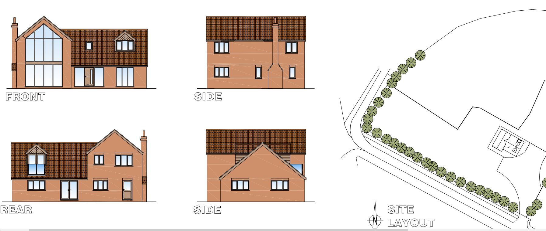

I've got a self build in progress and I'm at the stage of speccing/purchasing and doing the physical install of CCTV hardware.
We are pretty remote, there are no streetlights that project light onto the plot. I have however mounted wall lights externally that are triggered by PIR's.
I'm looking for coverage on all sides of the build and could do with a pointer or three on what's good these days and maybe a recommendation or two on camera and lens choice. My old house I had an annke system, so I'm quite used to configuring and navigating ivms.
As it stands, I have run 2 pairs of CAT6 to each corner of the build. Still pre boarding so can run more CAT6 in if needs be.
image of site layout and projection attached hopefully.
Thanks in advance

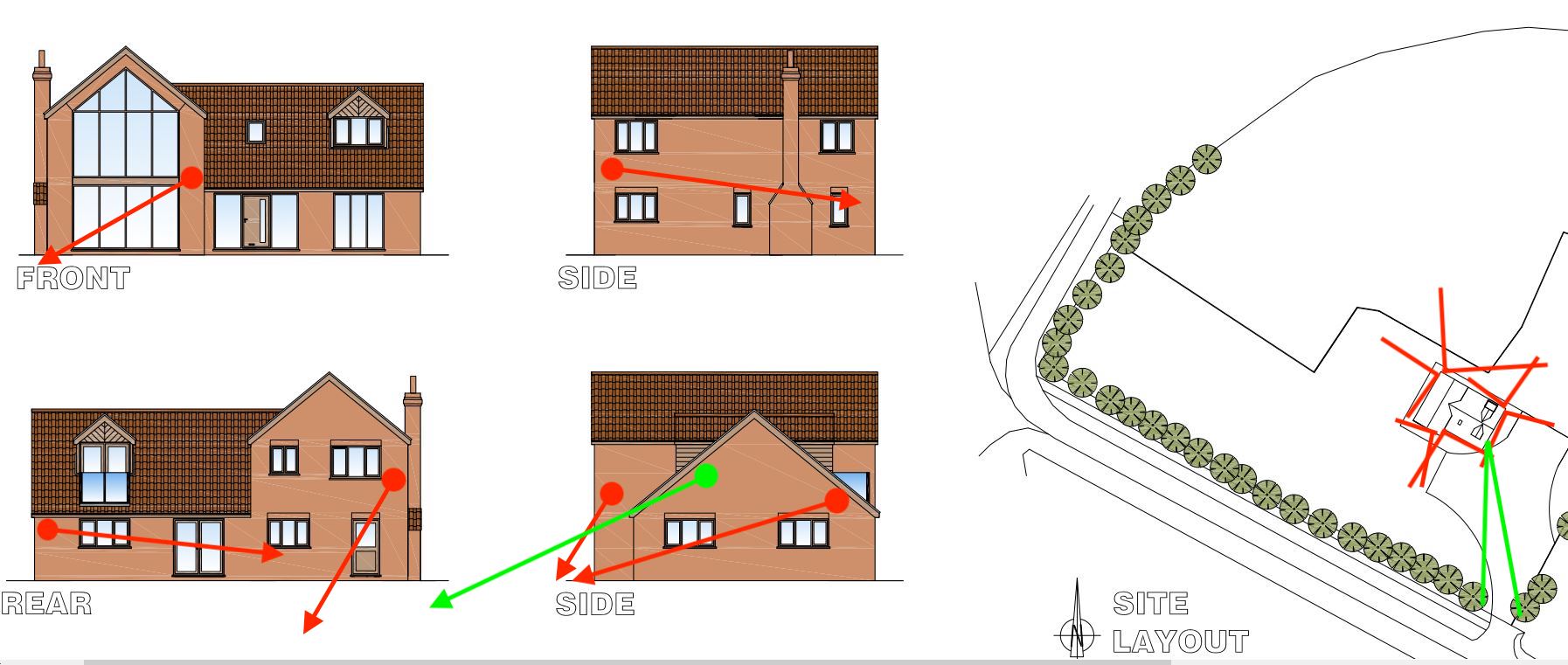

Based on the description of your requirements, see the annotated plans I have attached for some rough position suggestions.
For the RED camera positions, we would recommend turret cameras like the DS-2CD2347G2H-LIU 4MP Smart Hybrid Light Fixed Turret Camera (2.8mm) or the DS-2CD2387G2H-LIU 8MP Smart Hybrid Light Fixed Turret Camera (2.8mm).
For the camera on the long side of the building (top right of annotated plans), you might need to consider using a wall bracket that will push the camera out from the wall to allow you to see better around the chimney stack.
(but this is not absolutely required because the area behind the chimney is pretty small and other camera positions would likely cover the approach to that area)
You mentioned already having cable run to the corners of the building, if this cable is actually sticking out of the walls already you will need to install the turret cameras with Junction Boxes to protect their RJ45 connectors.
For the final position that we've marked in GREEN, we would recommend using a varifocal camera like the DS-2CD2646G2-IZS Acusense 4MP Varifocal Bullet Camera because this model has a motorised lens that will let you adjust its focal length (2.8-12mm) and narrow the field of view to get more detail at the full 35m distance that is the driveway entrance/gate.
In regards to recording these cameras, we would recommend the DS-7608NI-M2/8P 8-ch M-series NVR and we would recommend either Western Digital Purple HDDs or Toshiba S300 HDDs, you can calculate how much storage you will need to meet your requirements by using this Storage Calculator.
We haven't marked a position for an intercom/doorbell camera because from your plans there doesn't appear to be a large enough mounting area on either side of the front door to install one of these.
