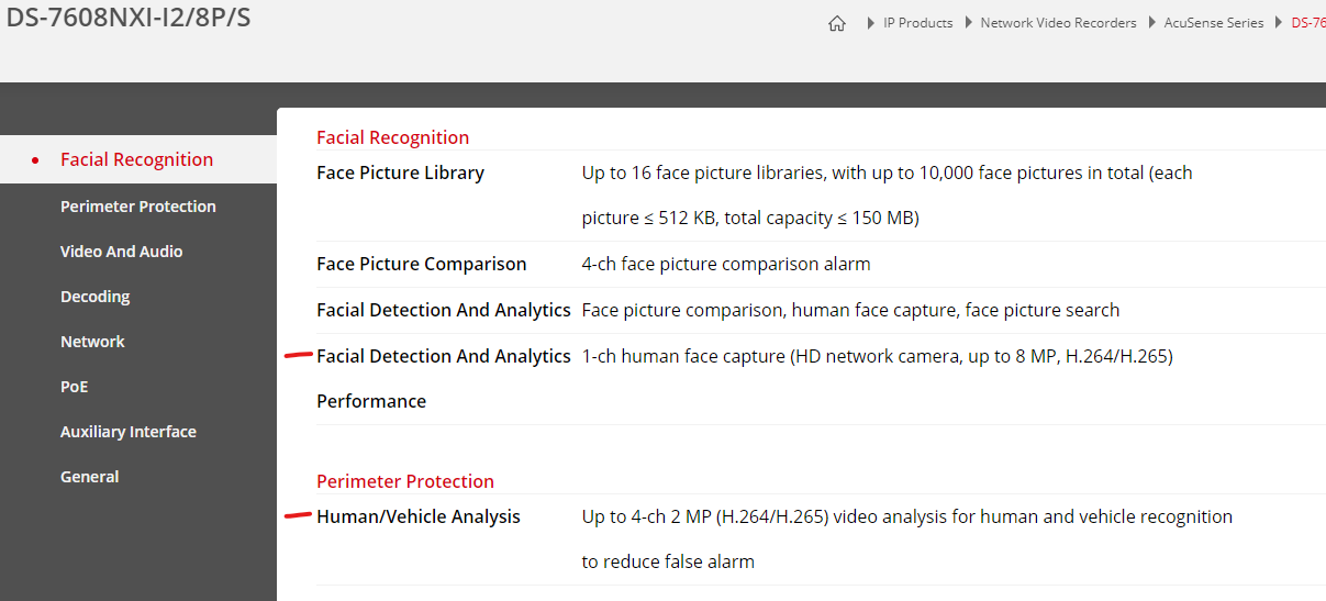

4. What do these seemingly conflicting statements mean from their site on this NVR model? Does this mean I can only use this functionality on one camera? Or maybe one camera at a time but only 2MP cameras? Is this limiting for me??
"Up to 1-ch facial recognition for video stream"
"Up to 4-ch 2 MP (H.264/H.265) video analysis for human and vehicle recognition to reduce false alarm"

Q4. This is what I've seen on the site.

Q4 - This is not the specs for the DS-7608NI-I2/8P that we had previously recommended to you, this is the AcuSense NVR model which is not currently available in the UK. (it is easy to get confused because the model number is almost exactly the same except for the NXI part in the middle and the /S at the end)

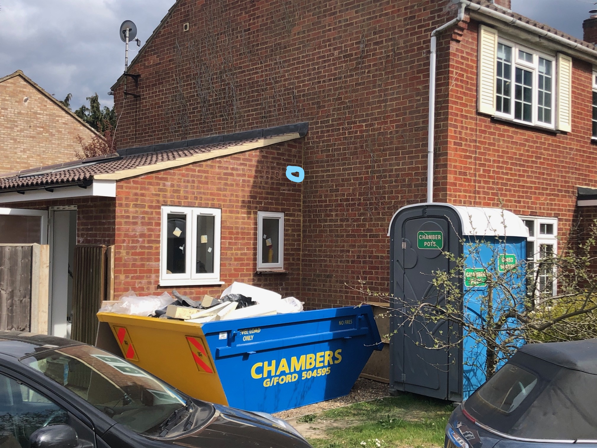

I thought it would be easier to show what I am considering. The camera will go here on this wall and be monitoring a driveway below it. One car space will be where the skip is, and one where the toilet/small tree is. I'm thinking a 2.8 is perfect for this.

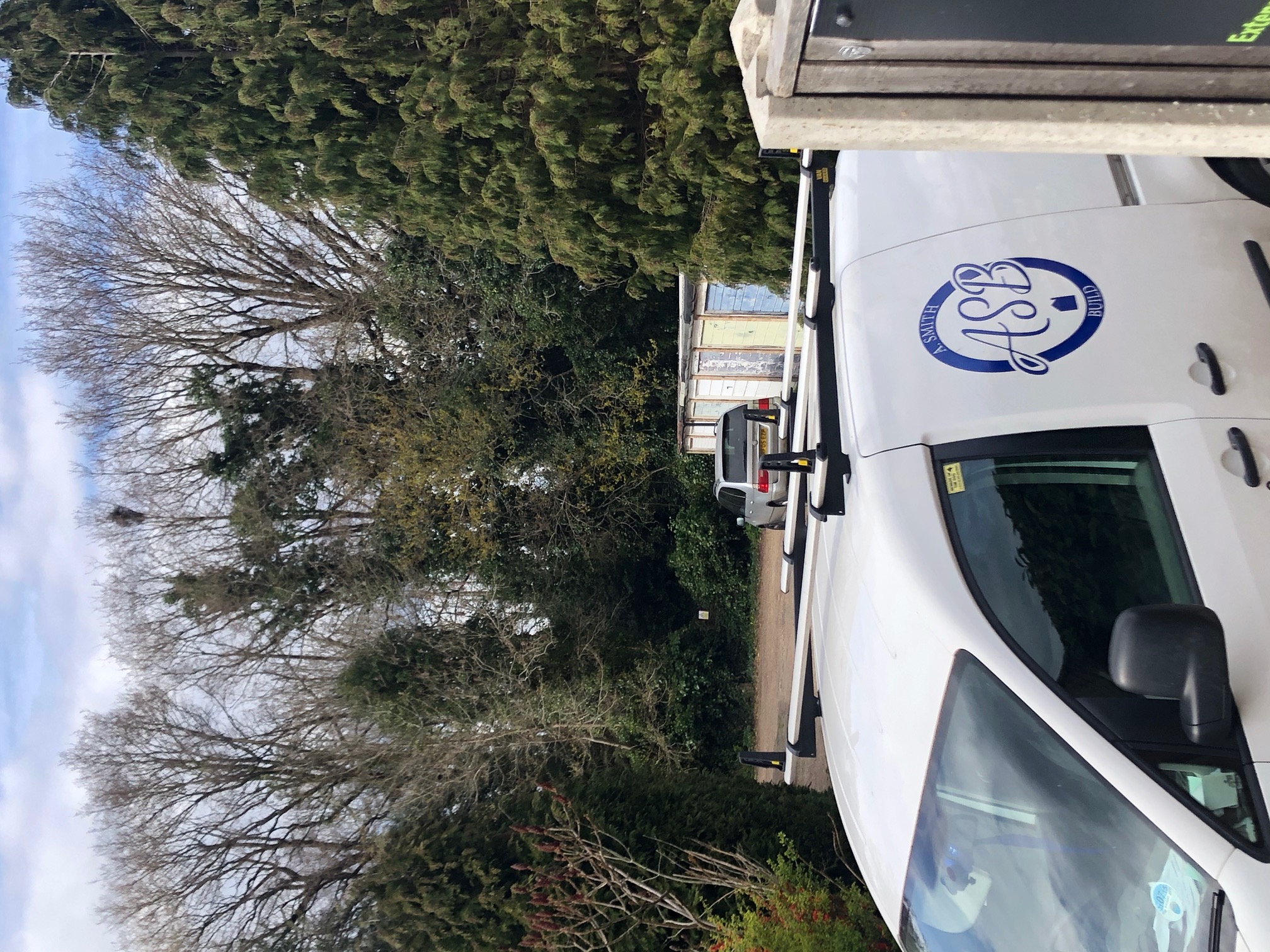

However, I would ideally also like to monitor my garage in a block which is directly opposite the camera position but some way away - I'm struggling to decide now whether 2.8 mm won't see as far as the garage, but 4mm might not cover both car spaces. What do you think?

I think in that location the 4mm focal length will be fine, with the 2386G2 the 4mm focal length will give you 87.1° FoV which is just under 90 degrees so with the camera positioned in that right-angle corner you should get full coverage without going as far as the 2.8mm which is wider than 90 degrees and will waist some of your FoV on the walls either side of the camera.

Now you have shown the camera position and the area you would like to cover I think it would be ok to mount the camera directly to the wall (or use a junction box) because you are not tilting the camera to the extreme right or left, you are looking roughly straight down the middle between the 2 cars.
