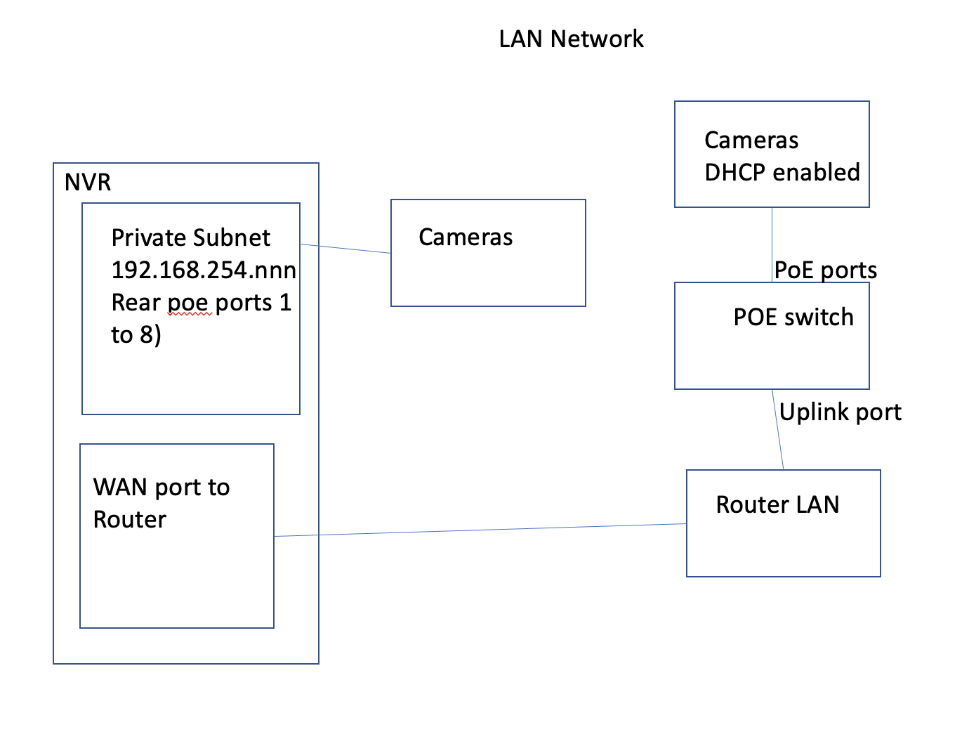

I am setting up a system for our restaurant/bar. 8 x DS-2CD2345FWD cameras going to a DS-7608NI-K2 NVR.
The first 4 cameras are on the first floor and go straight in to the NVR, they all show up no problem.
The remaining 4 cameras are in the basement, and all go to a DS-3E0106HP-E 4 way switch. The switch connecting back to the NVR.
The 4 basement cameras all work individually, but only one at a time to the NVR. From what I understand I need to assign IP addresses to the remaining 3 that don't show up on my NVR.
I run a Mac with OS 10.15.7, I have a USB C to Ethernet adapter, the camera doesn't show up on any network pings, nor in the SADP tool. The NVR does show up as online.
Can someone please advise how to assign the remaining cameras that will operate via the network switch please?
