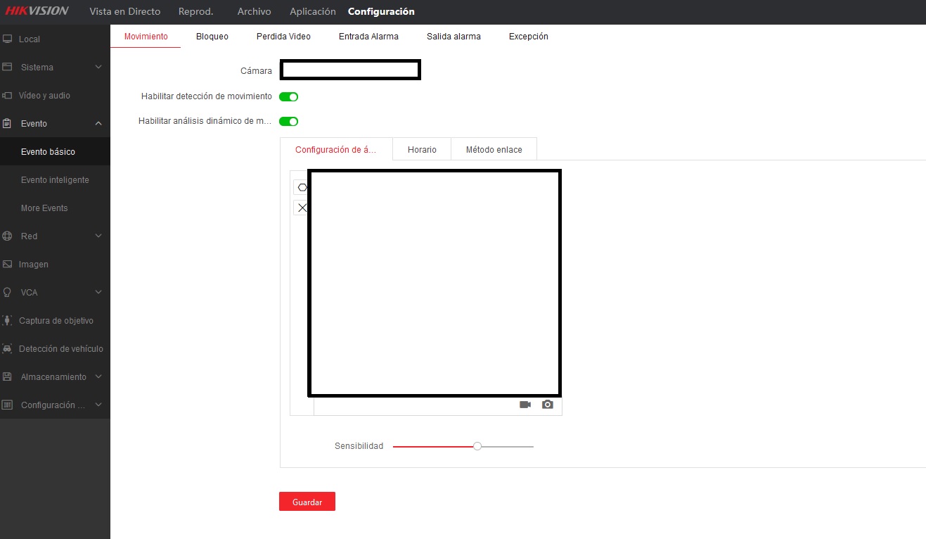

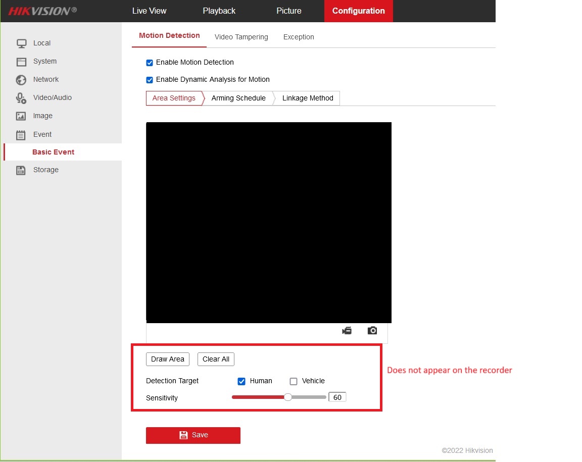

Hello again.
As a test, I have updated a DS-7732NI-I4(B) recorder model to firmware v.4.61.025 and the DS-2CD1327G2-LUF IP camera to firmware v.5.7.12. In the camera menu, in a simple event, it appears to be able to select between humans and vehicles, but in the NVR menu it still does not appear. I have tried ivms4200 version 3.10.0.6 but it still does not work.
Do you know what could be wrong?
I attach images.
Thank you.

Hello Kyle, thanks for responding.
The browser that I using is Firefox 117.0 (64 bits).
For camera model DS-2CD2T46G2-2I, the human and vehicle tickboxes appear on the NVR, but not appear for Value Serie cameras, that is, for models DS-2CD1327G2-LUF and DS-2CD1027G2-LUF not appear.
How as it i said yet, i updated the Nvr and cameras to the last firmwarek, but they still don´t work.
