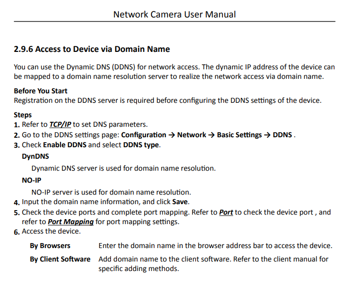

Hi everyone,​
Does anyone know how to connect this camera to IVMS-4200 without using Hik-Connect.
Do I need to get the cell phone company to do port forwarding on the sim and provide me with a static IP or is there an easer way to do this.
Thank you.
The camera I am talking about is this one:
DS-2XS2T41G0-ID/4G/C04S05​
