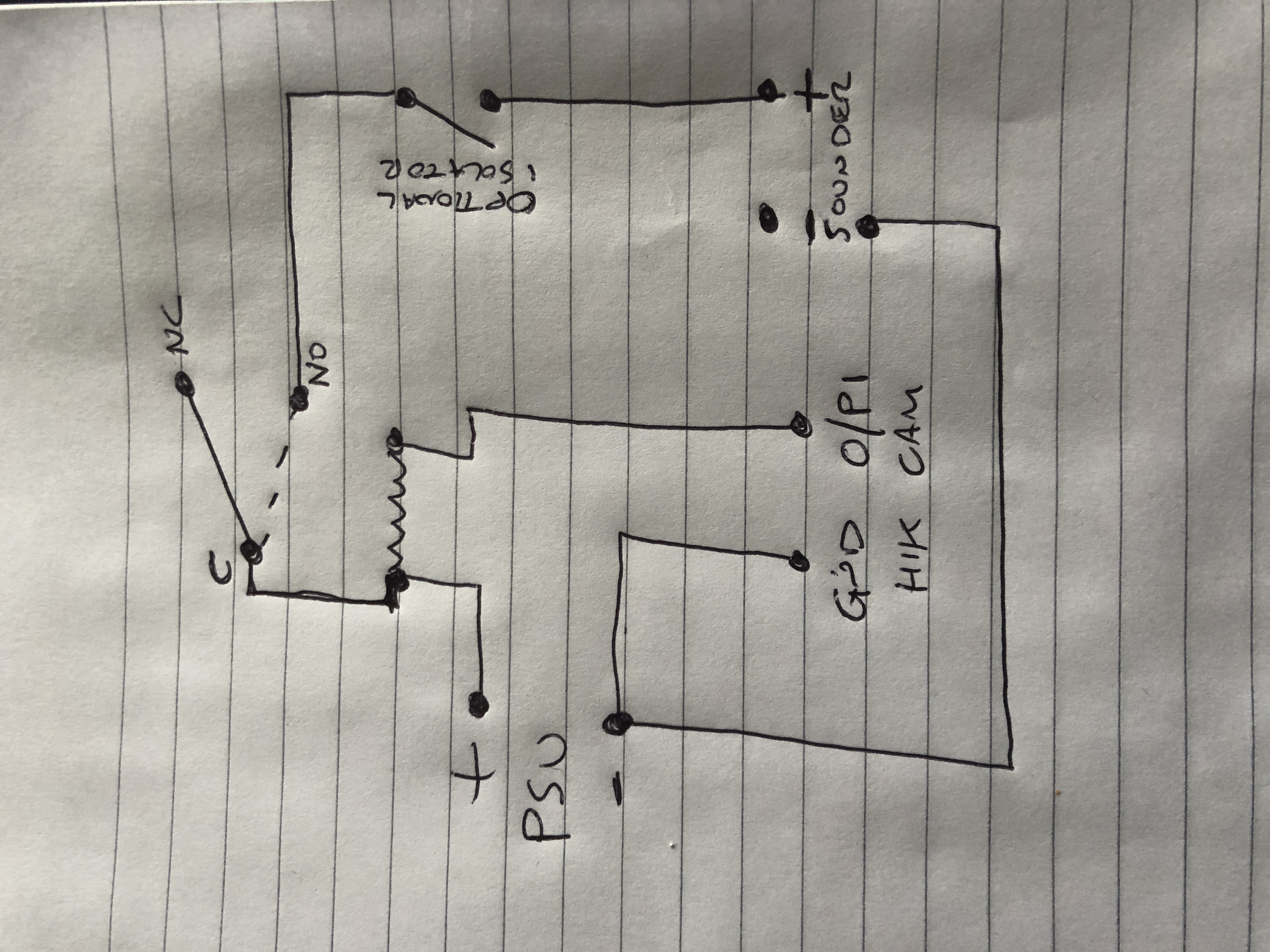

Hi,
We have a client with some DS-2TD1217B-3/PA thermal camera's and he would like to add an additional sounder / flasher unit when the temperature alert is triggered.
So, does anyone have experience of a) what we need to connect to what and b) what the settings are on the camera to signal to an external device?
Thanks in advance.
Simon.
