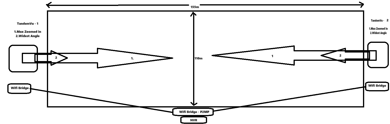

Can anyone advise if 2 TademVu 2MP Hikvision PTZs placed 155m apart (directly inline across from each other)
and connected via Hikvision Wifi bridge(P2MP) to an NVR (at 3rd location) is capable of providing me with good quality Bullet and PTZ(Panoramic) Views
at the same time?
Will the Wifi Bridge handle both these 2 Channel feeds from each TandemVu?
Equipment is all Hikvision.
See Diagram attached.
Hi @zane
There shouldn't be any issues connecting 2 TandemVu cameras via WiFi Bridges.
