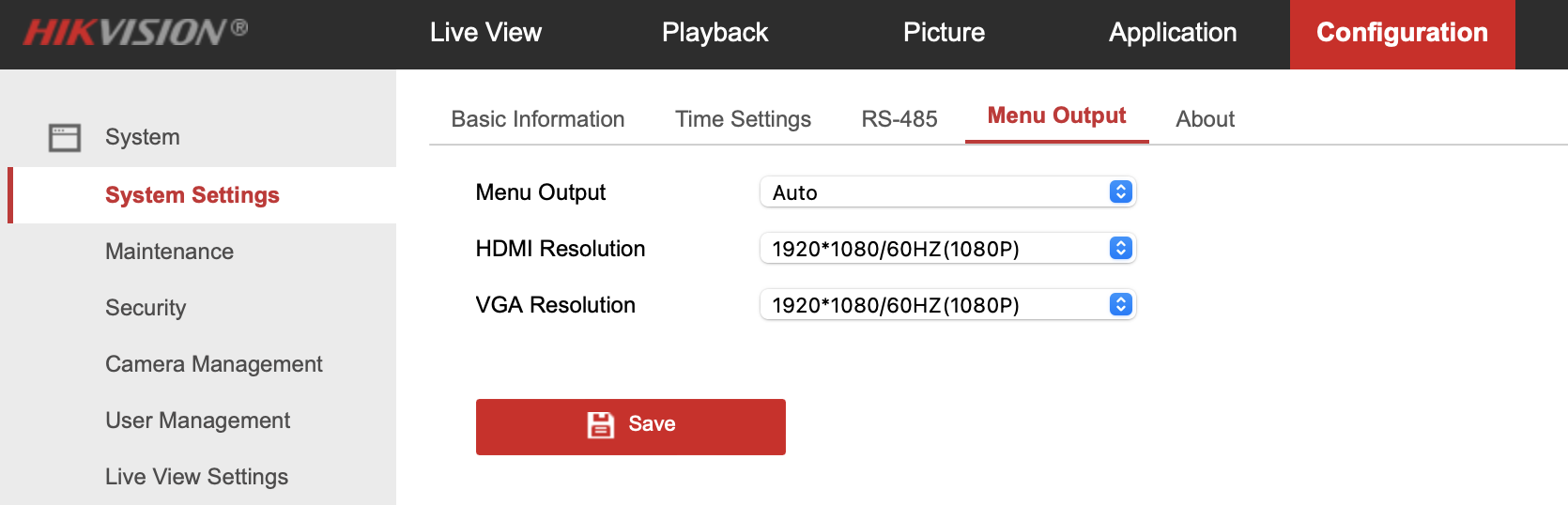

May I ask a follow-up question? Part of my mess started when trying to change the screen resolution so I could see the entire menu on the NVR. My TV/monitor connected to the NVR would not permit me to make any such changes. Is that controlled somewhere in the NVR menu of choices? I thought resolution but perhaps not. Thanks again.
Take note of which Display Port you are connected to [VGA or HDMI]
Access the NVR GUI via Web Browser & in the Configuration tab, navigate to System > System Settings > Menu Output
this is where you can change the Resolution Output to suit your Monitor for either VGA or HDMI
The Menu Output dropdown options, if you choose HDMI then your mouse/menus will only be available on the Screen connected to HDMI [Same for VGA etc] best option choose AUTO
Now to rectify the Display Issue where you can Not See all the Menu Items ................................... is done by your Monitor/TV settings [NOT the NVR], usually toggling through the Monitor/TV Picture or Aspect Ratio settings will identify the one you need, something like Scan or Full is usually the correct setting
