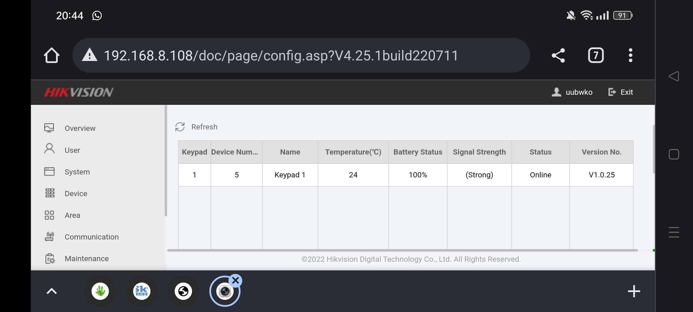

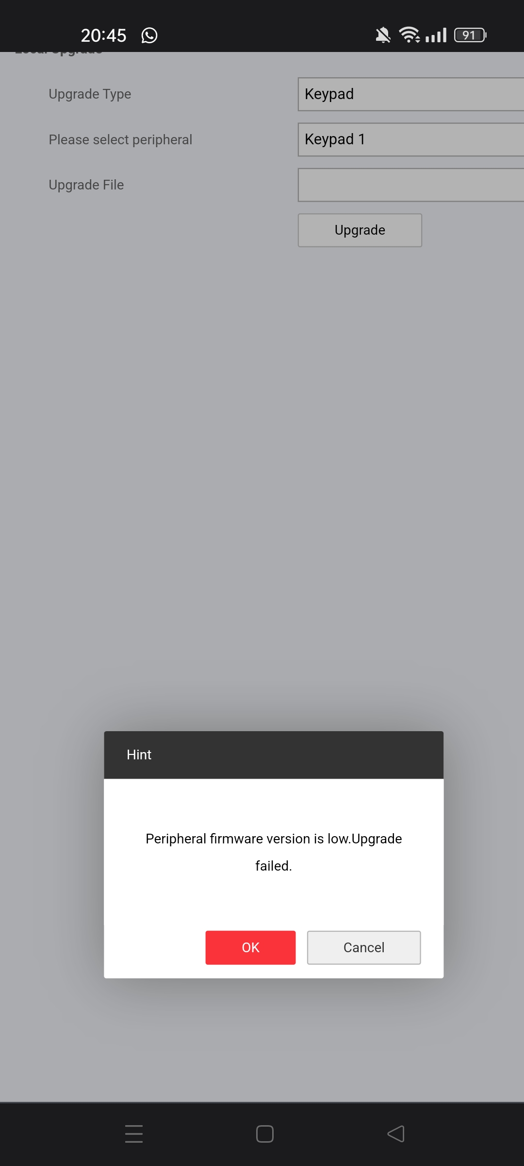

Hi Jake, thanks for your help.
I have tried to update with the firmware you give (version 1.4.256) but the web server says that I can't update to an older version. However you can see in attached picture that my keypad is 1.0.25...
Thank you for this, I have contacted HikVision and will keep you updated on any information/solutions that they provide.
Hi @spykik,
Hikvision has gotten back to me, please find what they have said below:
'I checked the thread and see that the customer is getting a “Peripheral version is low. Upgrading failed.” message. This is because it is from the old versions of the wireless keypad. Unfortunately, this means that to upgrade, only an upgrade through serial cable is possible.'
I hope this helps!

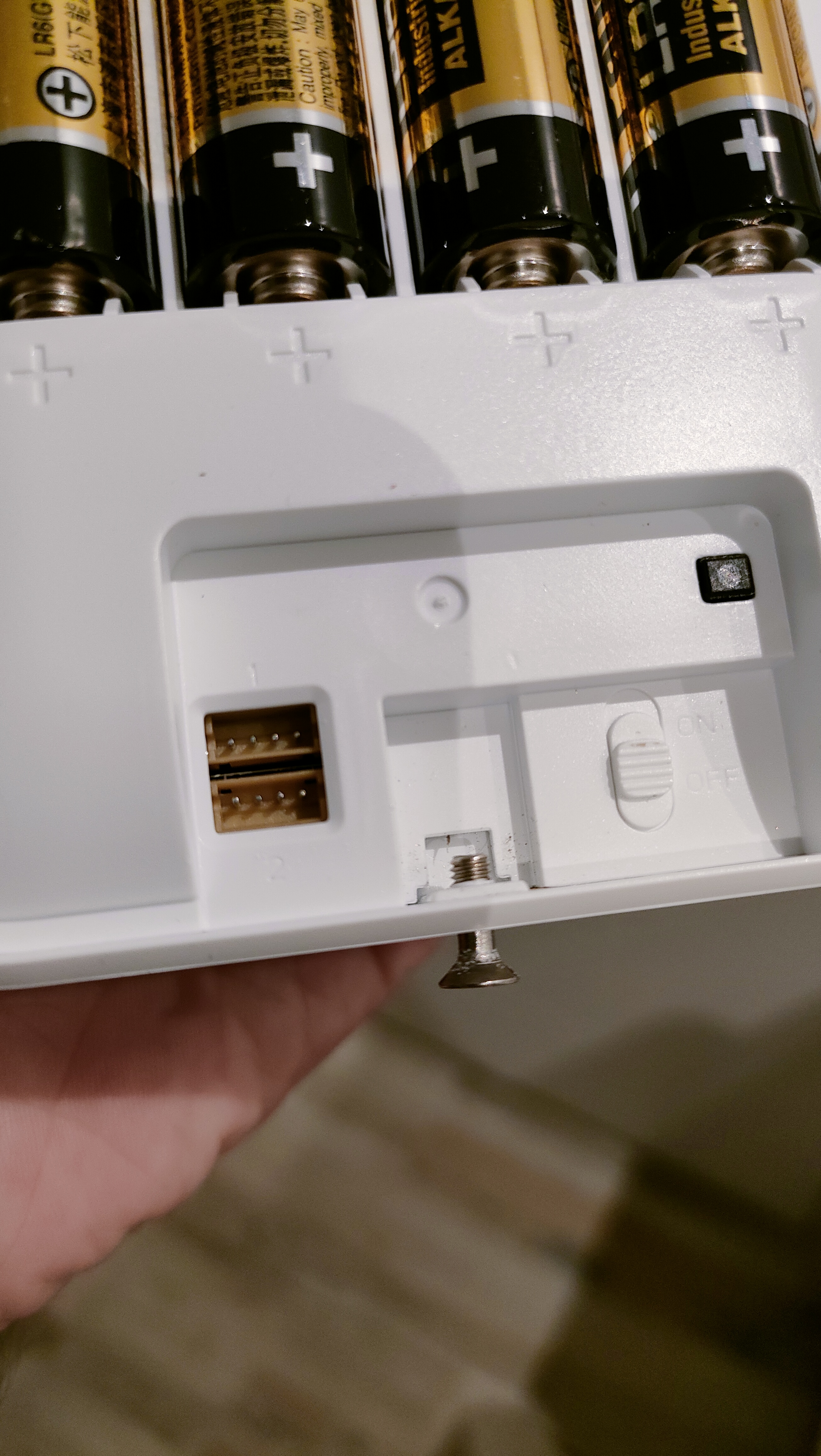

Hello,
I try to upgrade through serial cable but I do not find any documentation for my device... I guess the same parameters of other devices are valid (serial speed, mode, etc.) but I don't the pinout of the serial port behind the device.
As you can see in the picture below, there are 2 serial port. Why ? And which pin is TX, RX, GND ?
Thank you !
Hi @spykik
I have heard back from HikVision and unfortunately, it looks like the serial cable required isn't available to purchase with vendors.
Here is what HikVision have said below:
"You would need the serial cable adapter which cannot be sourced from any vendor"
If however, you could send us some more information and pictures about the "Active on Entry Delay" parameter you are struggling with. We can try to figure out a solution for it without having to update the firmware.

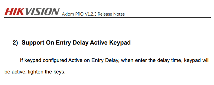

Hi @Jake Hulks ,
Thank you for you reply.
I found the following information about the "Active on Entry Delay", in the "AX Pro v1.2.3 Release notes" :
As mentionned, the keypad shall "wake up" during entry delay. But for my keypad, whatever the option is active or not, the keypad does not wake up and I have to active it manually (my entry delay is 45s). This option does not have any effect on my installation.
It is not a very important option, but in my installation, the keypad is just behind the first door and I always use it, so it would be better if it could be already active when I enter the room.
