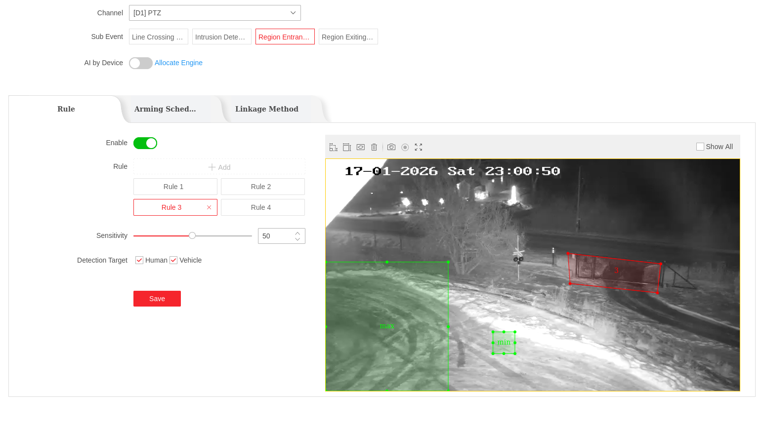

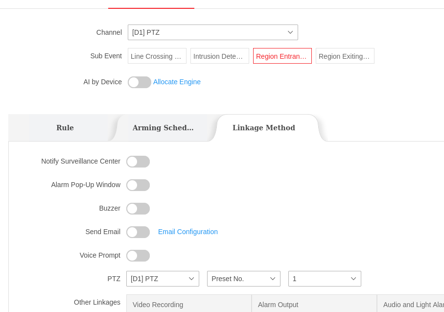

Can anyone assist me with configuring Linkages for multiple Region Entrance Detection rules? I have 4 of them (see picture). Two of them are suppose to make my PTZ to zoom at the gate area when something/someone is detected by it, but when i try to set a PTZ linkage for ONE of the rules I end up witch the same linkage for every one of them.
Funny thing - i already had this working, but i messed it up somehow.
Help please, its so frustrating!

Unfortunately linkage option is shared between everything on that page.
Only way is to create a mini service to run on RaspberryPi
Listen for events, and when area of your choice is triggered, ISAPI call preset
If you need i can make such service so git me up in DM. Depending where you want to run it at.

Thank's, I think i can handle it myself. Do you listen to camera or NVR events?
Its really, really sad how otherwise great hardware is being held back by a sloppy software.
I hope the rules are active only in camera position they're configured in? Please say they do.
Upvote 0
