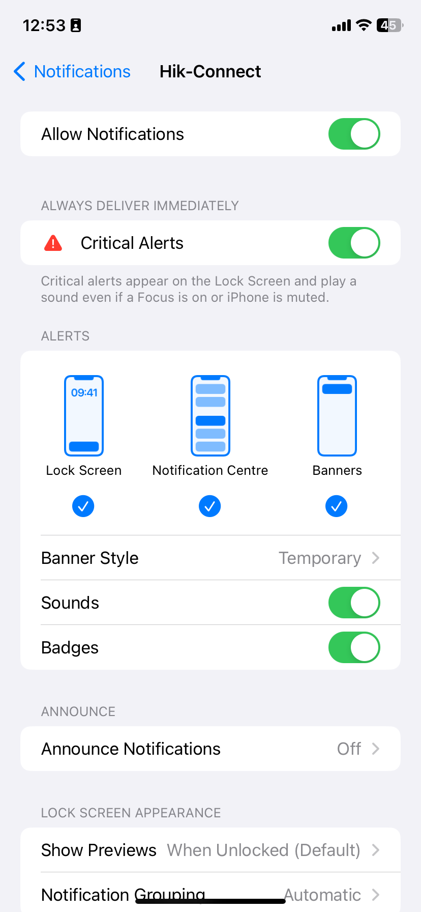

I also recommend checking that you have not got one of the focus modes enabled on the iOS devices, and that notifications for Hik-Connect are turned on both in the iPhone/iPad notification settings - try enabling "Critical Alerts" too, which will override the focus modes:
Check you have notifications enabled in in Hik-Connect itself, by going to Me>Settings>Notification Settings:

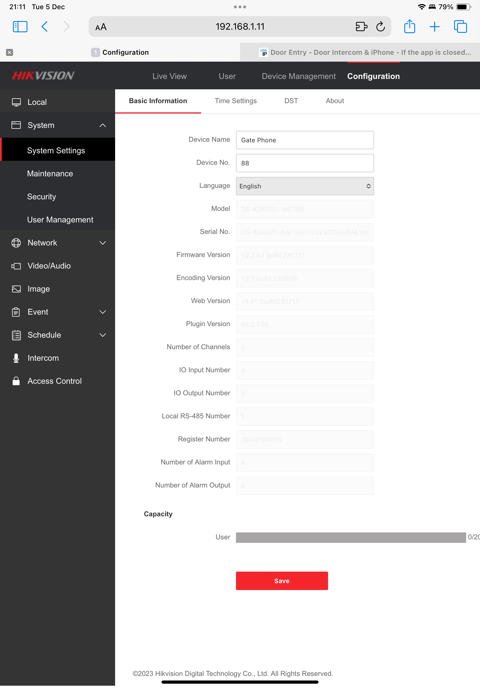

I don’t think the KD8003 can directly connect to Hik-Connect? It is connected via the indoor station to Hik-Connect. I have changed the name under Configuration>system>system settings>basic, but the change is not being reflected. Perhaps I need to logout and log back in to Hik-Connect. I’ll try that in the morning.
I couldn’t wait until morning, I just tried logging out and back in on the app. The device name in the app now displays correctly, but the call still comes through from “main door station” :-/
