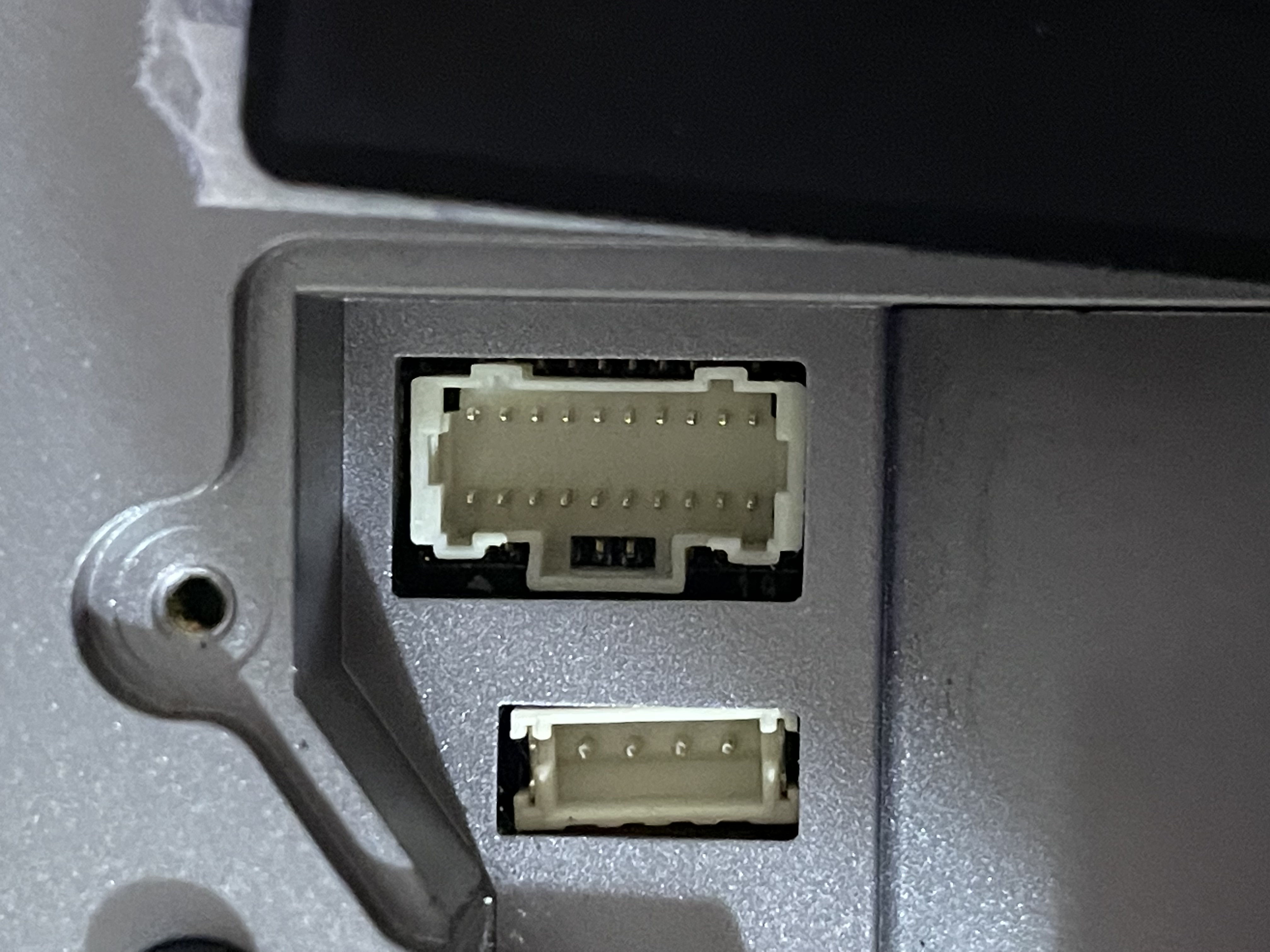

I have a DS6113 reclaimed from a previous install. Have no PoE to new location, so will use 12V + Wifi. Does anybody know the part no. of the connector used to access the terminals? It looks like a mini jst, but I can't find confirmation anywhere in the documentation.
It's not the sort of info that is easy to obtain from Hikvision, if you can share a photo somebody may recognise / be able to offer some suggestions.
Bumping this - there must be a connector out there to fit the terminals, for use without the RJ45plug?
It'll be available somewhere but I'd doubt anyone is going to know a part number. It'll be like looking for a needle in a haystack. There's a similar connection on the back of the indoor unit (though the wiring is different as the outdoor has several wires commoned up)
The easiest solution....Use PoE without using the network connection. Just use the outgoing port of a PoE adaptor such as the TP Link TL-POE150S and connect with CAT5E to the unit (there are other slightly cheaper plug in adaptors which will work just as well on Amazon). That'll power the unit and you can still use WiFi.
